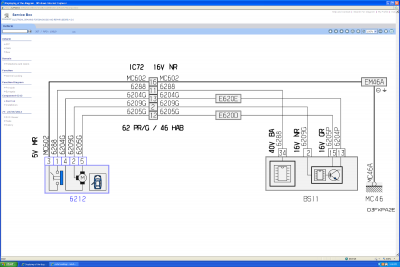

Thanks for assistance have pulled up correct wiring diagrams i believe on peugeot workshop manuals

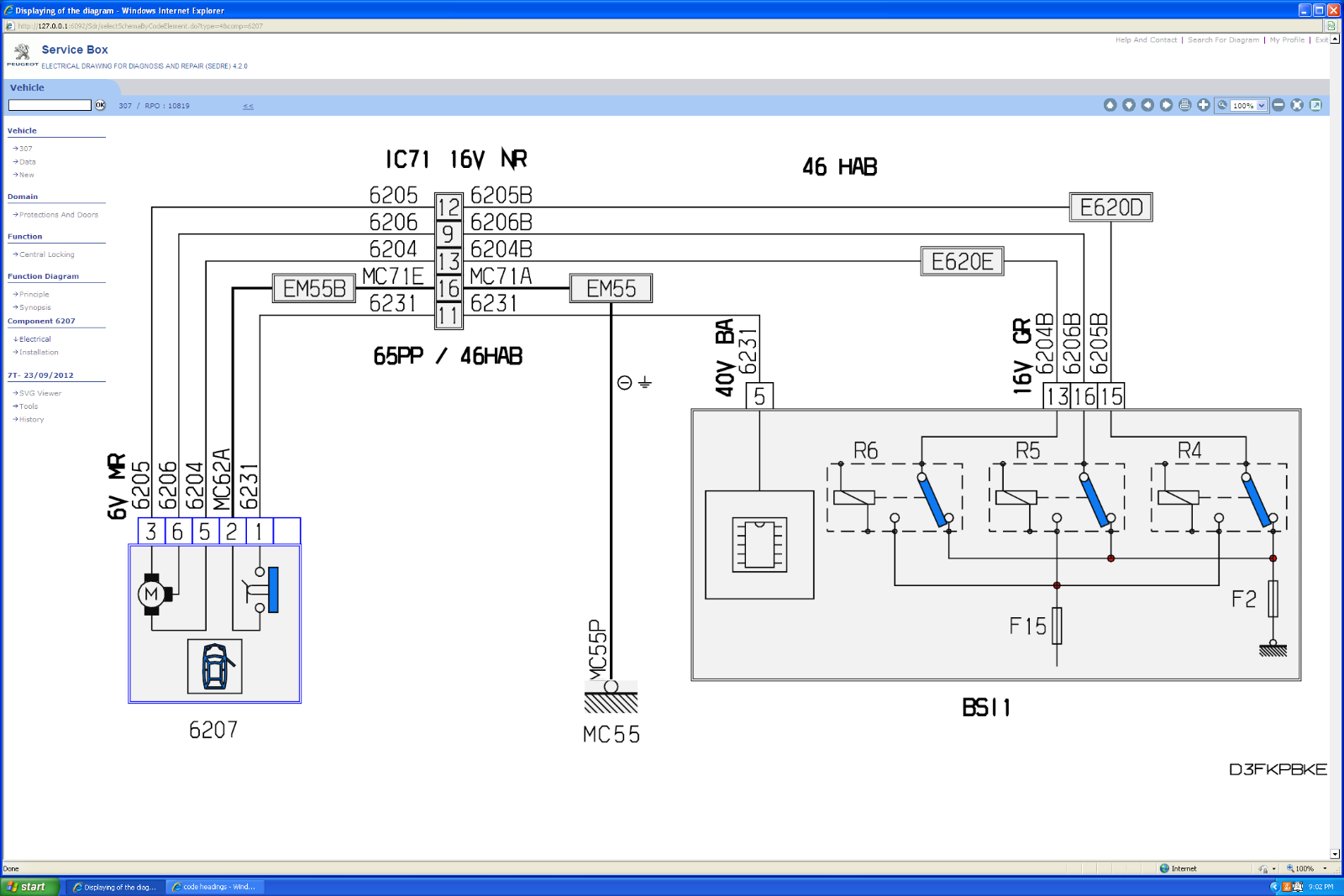

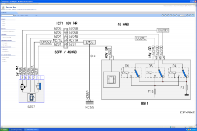

Re: Peugeot 307 hdi central locking / deadlocking issue
Ok, so next thing, have you checked:
Shunt Fuse in the BSI - make sure it is in customer position not Park Mode.
Check Fuse F2 and F15 in the BSI (for Front & Left Door Lock Assemblies)
Does the main central locking button in the car lock and open the doors?
Check the wiring inside the driver's door grommet (from the 'A' Pillar to the Door) - opening and closing the door over time can weaken the wires inside the protective grommet - you may have a break or a short.
6205P : Left-hand front lock deadlocking + command Relay (R4A)
6204P : Right-hand front lock locking + command (Relay R5B)
6206A / 6206B : Right-hand front lock deadlocking + command Relay (R6)
I would find it hard to imagine all the relays are shot.

thats the same wiring diagram i was working from firstly will check the shunt fuse is that F16 and how do i know customer or Park Mode ?
Checked both F2 & F15 in BSI all ok
Main Central Locking button on Dashboard will lock the drivers door only doesnt unlock drivers door i believe from memory has no effect unlocking passenger or rear doors ?
Have pinged for continuity on drivers door connector to relevant pins on BSI wiring loom plugs have continuity on all i should will try and check the grommet section

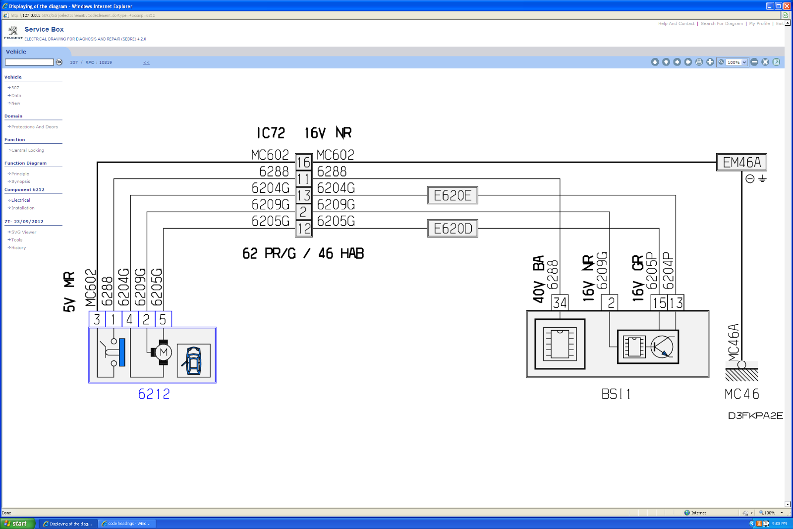

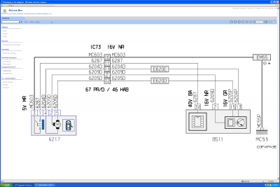

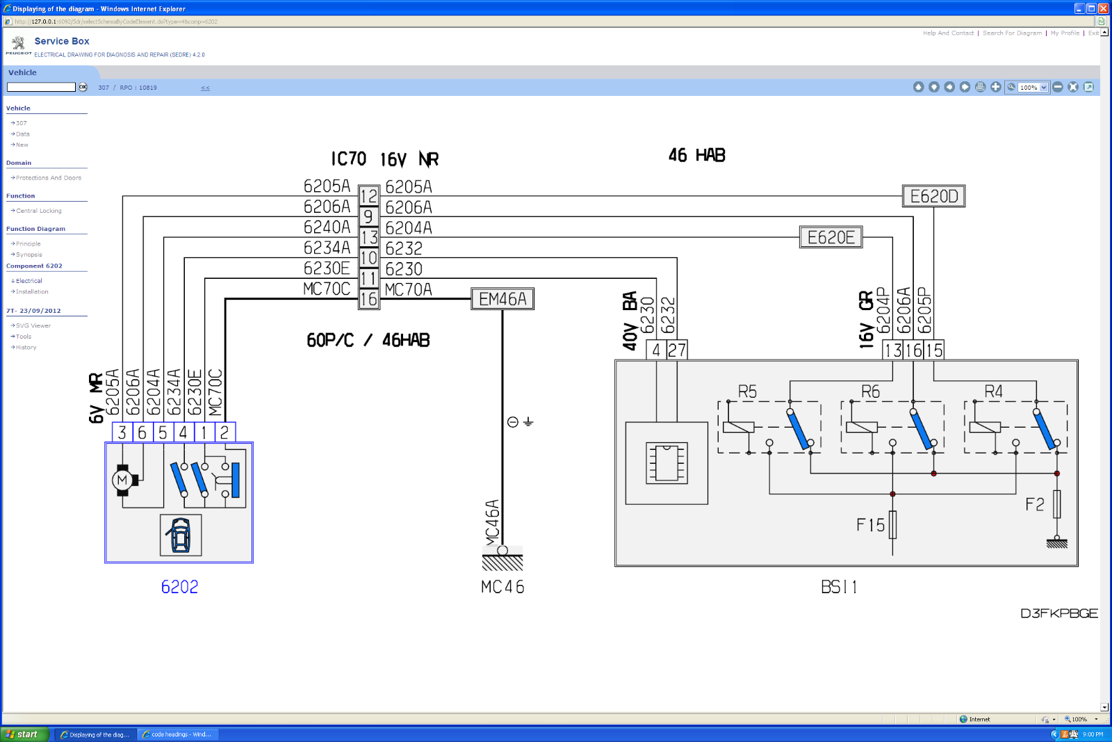

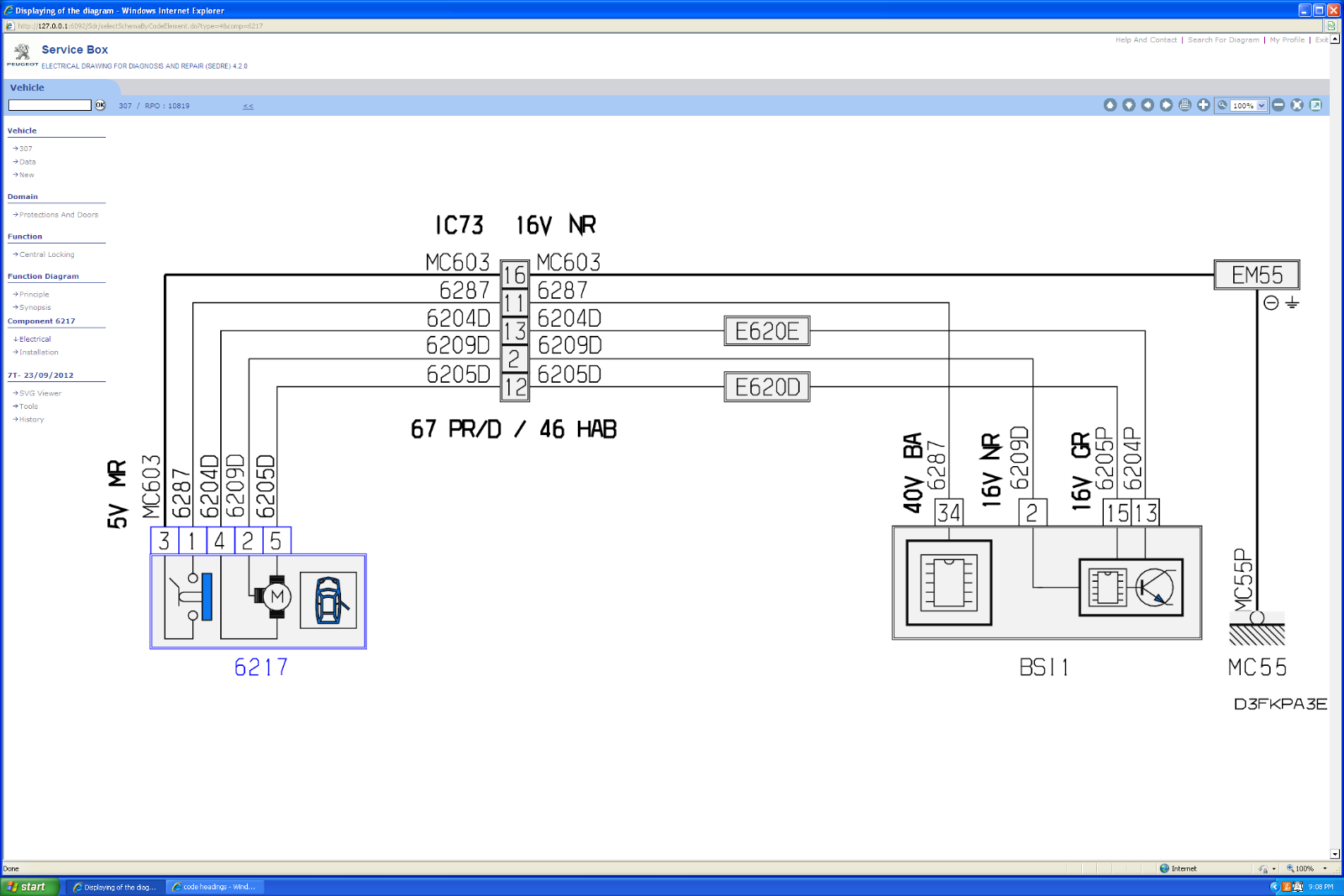

Hi
not sure if anyone can further assist as per the wiring diagram kindly posted by Marc unfortunately my reading of said wiring diagram is very limited will give some info on wires according to peugeot workshop manual
6202 - Front Left Hand Door Lock Assembly
Pin 3 - 6205A - Left Hand Front Lock Deadlocking + Command
Pin 5 - 6204A - Right Hand Front Lock Locking + Command
Pin 6 - 6206A - Right Hand Front Lock Deadlocking + Command
Pin 4 - 6232A - Closing Locking Output
Pin 1 - 6230E - Passenger Door open Locking Input
Pin 2 - MC70C - Earth MC70
6207 - Front Right Door Lock Assembly
Pin 3 - 6205A - Left Hand Front LOck Deadlocking + Command
Pin 1 - 6231A - Drivers Door Open Locking Input
Pin 2 - MC62B - Earth MC62
6212 - Rear Left Hand Door Lock Assembly
Pin 5 - 620 - Child Safety Control
Pin 2 - 622 - Control + Deadlocking
Pin 4 - 6211 - Rear Screen Actuator Control
Pin 1 - 6288 - Left Hand Rear Door Open Switch Input ( BSI )
Pin 3 - MC60R - Earth MC60
6217 - Rear Right Door Lock Assembly
Pin 1 - 6288 - Left Hand Door Open Switch Input ( BSI )
Not sure if anyone can make sense of that along with the wiring diagram
Regards
Mark
Regards
Mark
