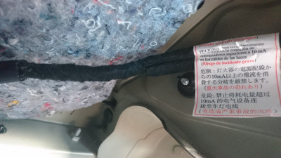

Re: c5 x7 tourer stoplight bulb replacement

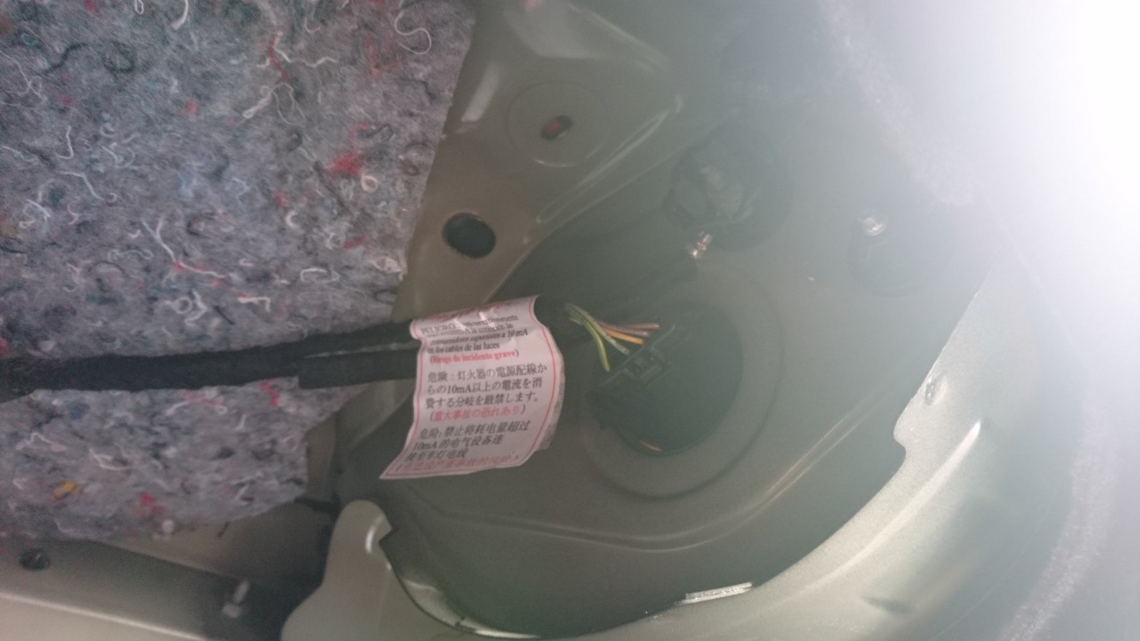

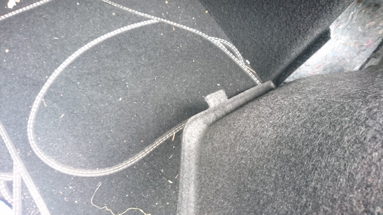

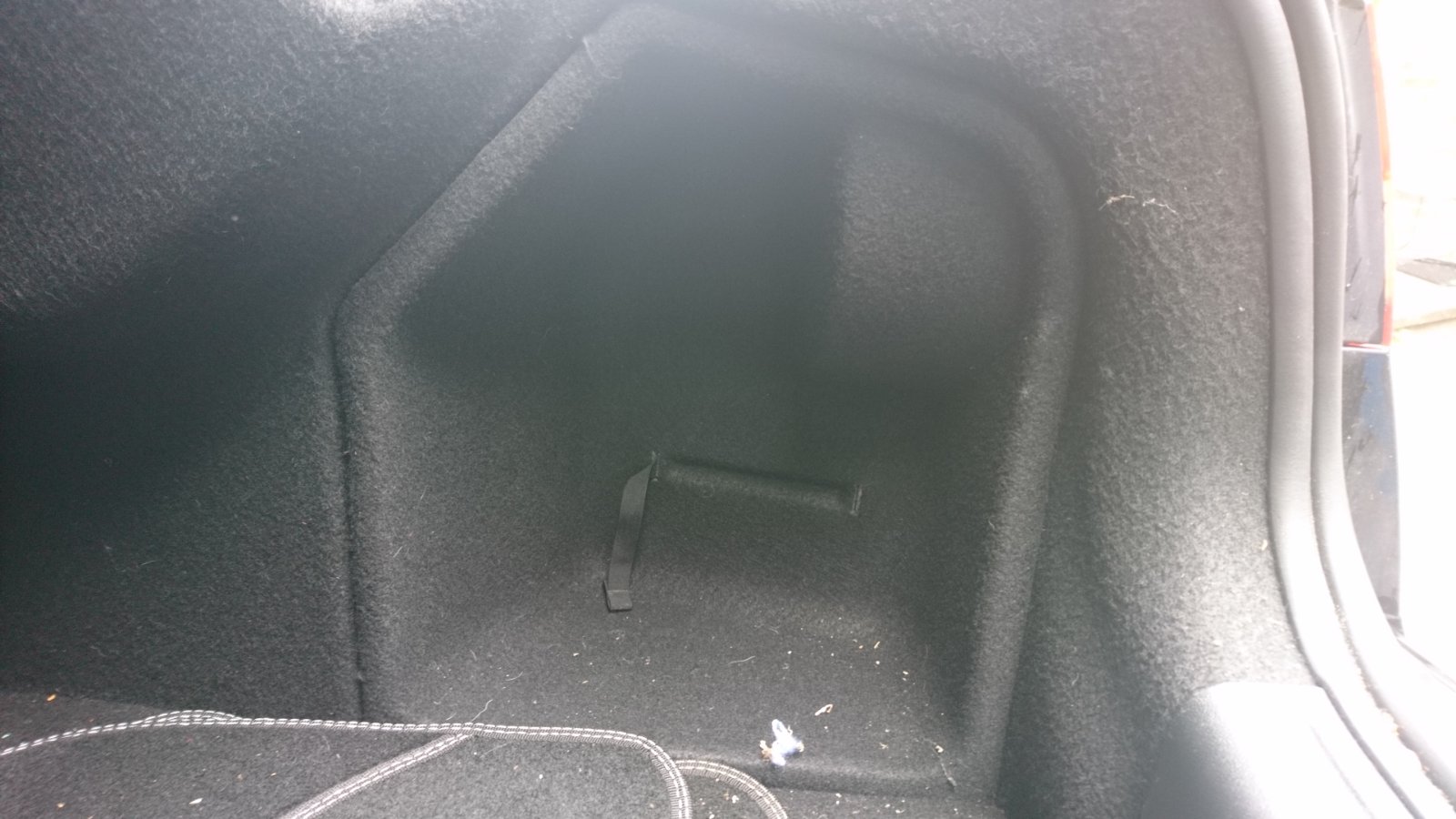

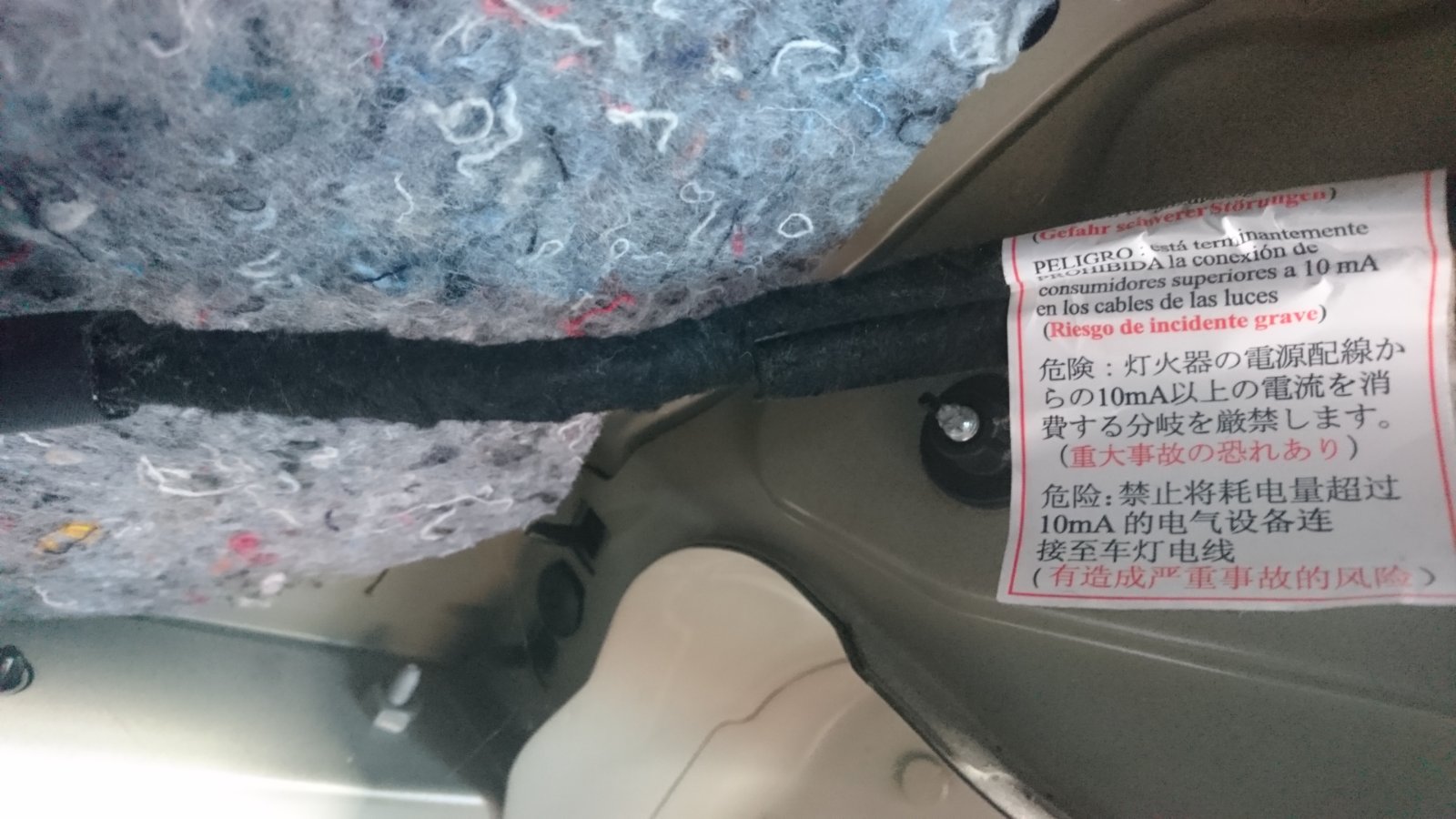

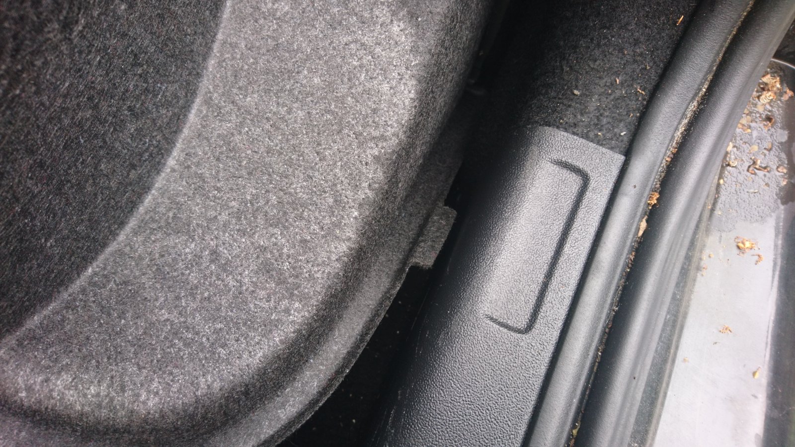

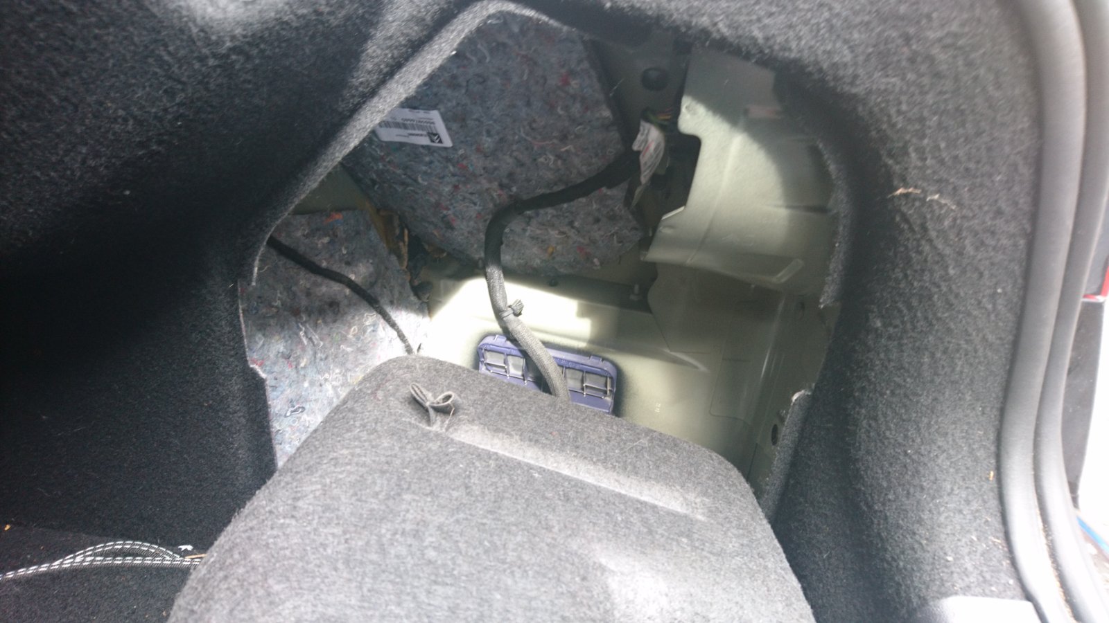

Hope these show the cover panel.
It is a case of gently pulling down from the top and then undoing the 2 retaining nuts, unplug the electrical connector and removing the light cluster from outside.
It can be a pain to get the cluster back in place, don't force it.
When putting the cover back in place just get the tabs in and Bob's your Uncle
rogerc5
Thanks everyone-- As you suggest it was easy to gently remove the basket panel and access from there.
