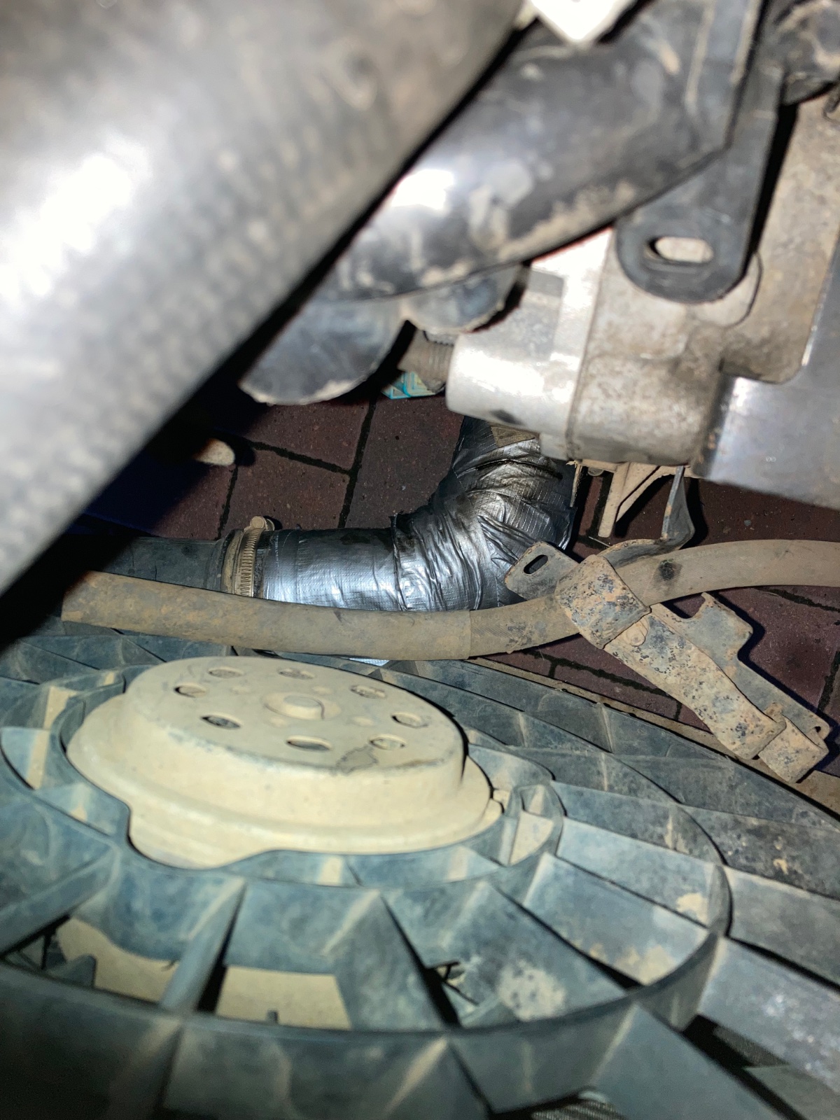

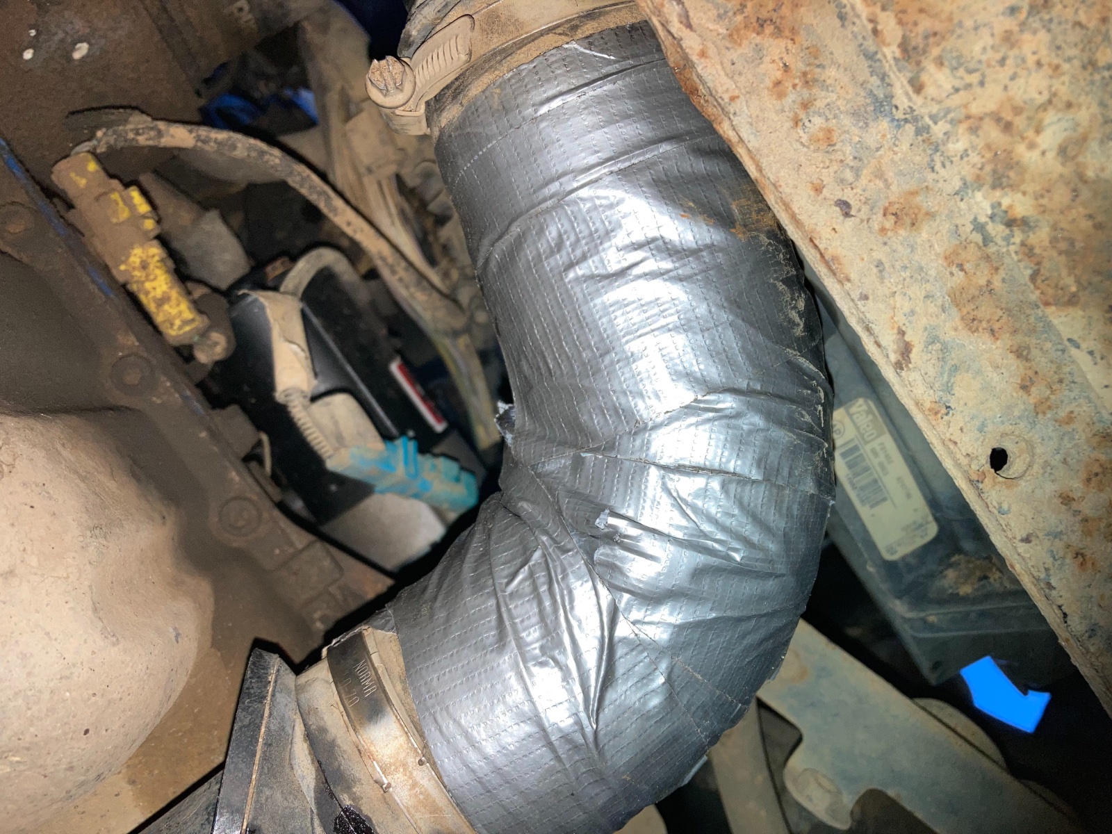

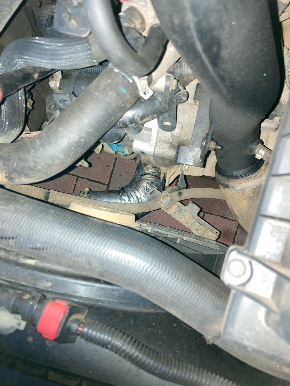

Hi. Was driving home in my 2004 Citroen dispatch diesel van yesterday and all of a sudden there was a loud pop. After checking around, I found a pipe that had burst open. I took it off, gaffa taped it up , popped it back on and it got me home. I want to get a new pipe for it but I have no clue as to what pipe it is. Could someone on here tell me what the pipe is please. I’ve attached some pics. It’s like a letter C shape

It looks like the radiator outlet hose.

Odds on that is the pipe to the intercooler, hence the pop.

No coolant leak and from what I can find on the internet I’m thinking it’s the intercooler hose.
