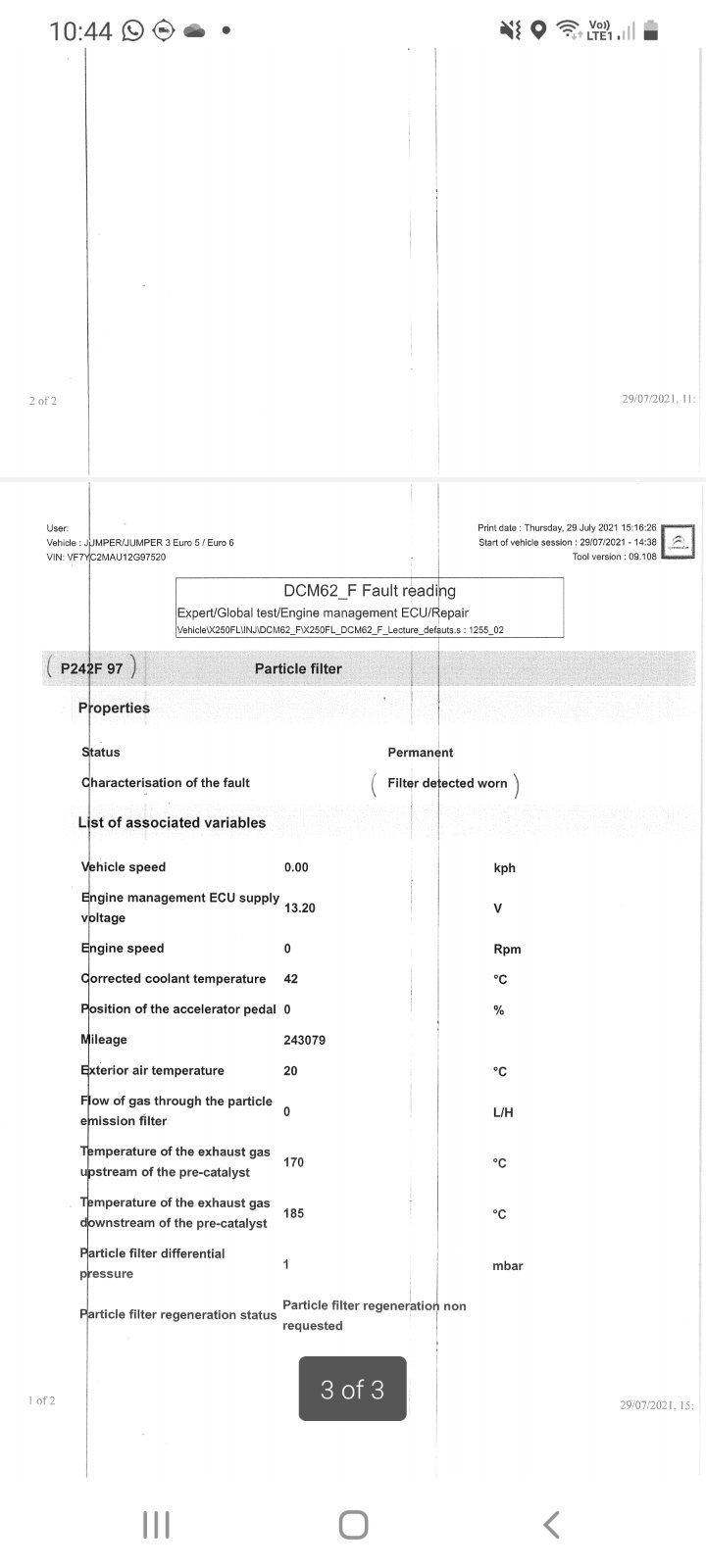

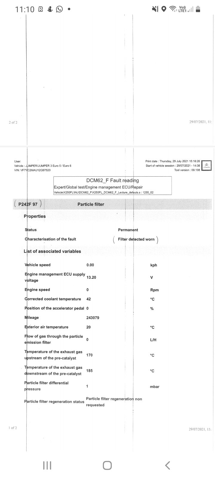

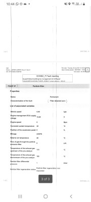

Hi... Back again.
They had cleared the faults and more or less 5000 later its come back on again. They have now actually given me the print out, the milage is completely wrong, it's down as 243000, when it in fact only had 102000 when I took it in. They are claiming a gremlin, and that the machine picks up milage when plugged in?
Ive uploaded the report.
Thanks

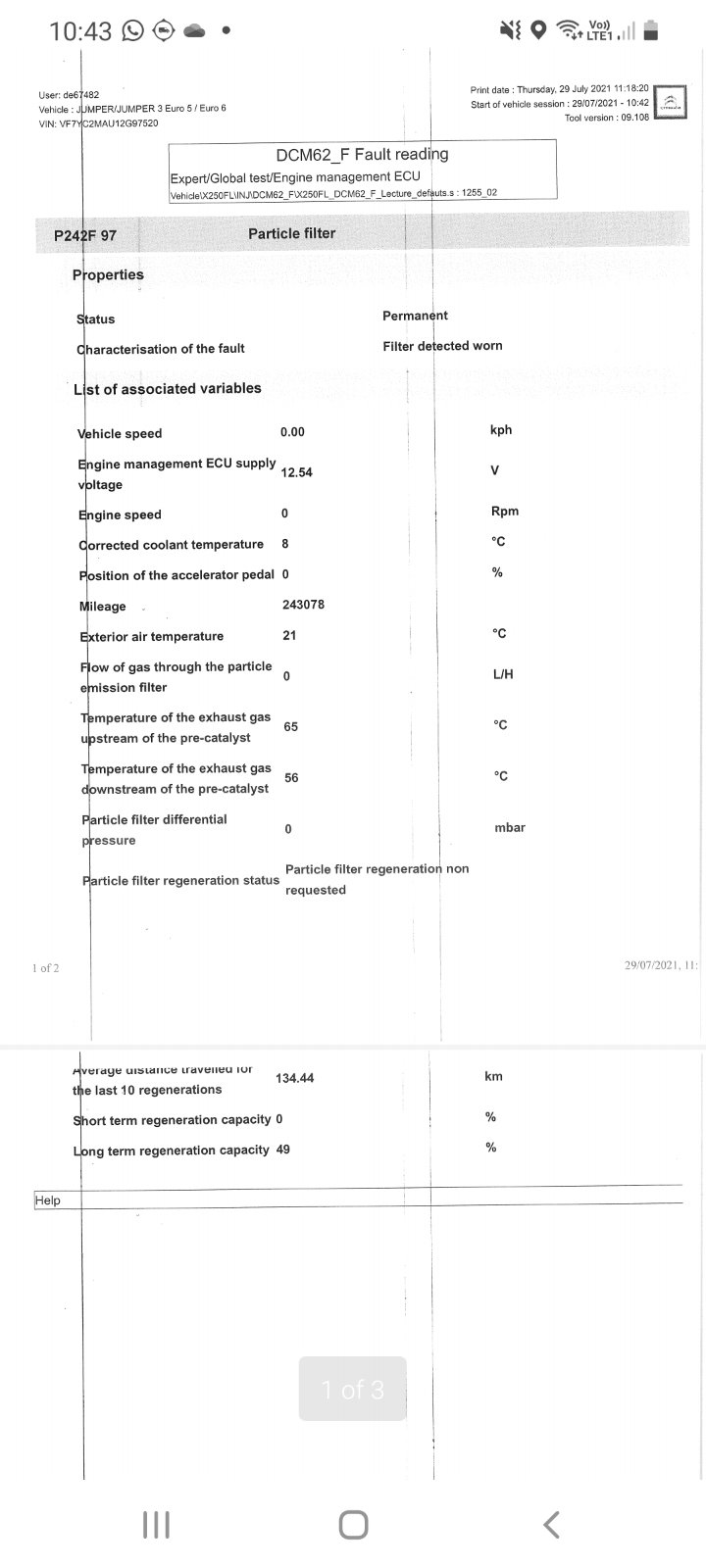

Tofwig
Posts: 10
Joined: 29 Jul 2021, 19:47
Re: Check Ad Blu System
Unread post by Tofwig »
And added the last sheet
The system generally records mileage in Kilometers, so probably why it is incorrect, but even with the conversion that doesn't add up.
