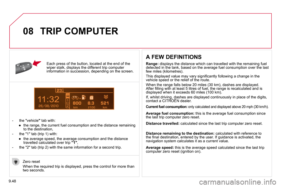

That shows the distance travelled since the last reset - and in the picture above it has already been reset, so is showing 0 KM. Is that photo from your vehicle and when you start driving it should increase until you reset it again. You vehicle specification clearly states no Computer function option installed.
solar21
- Posts: 7
- Joined: 21 Jul 2021, 19:48
Re: Can't reset Average Fuel Consumption and others
Yes i know that, it should work this way. This photo is from the web, in my car display shows 9999 since the begining (since i've bought it). I can post real photos after sunday.GiveMeABreak wrote: 23 Jul 2021, 10:43 That shows the distance travelled since the last reset - and in the picture above it has already been reset, so is showing 0 KM. Is that photo from your vehicle and when you start driving it should increase until you reset it again. You vehicle specification clearly states no Computer function option installed.
