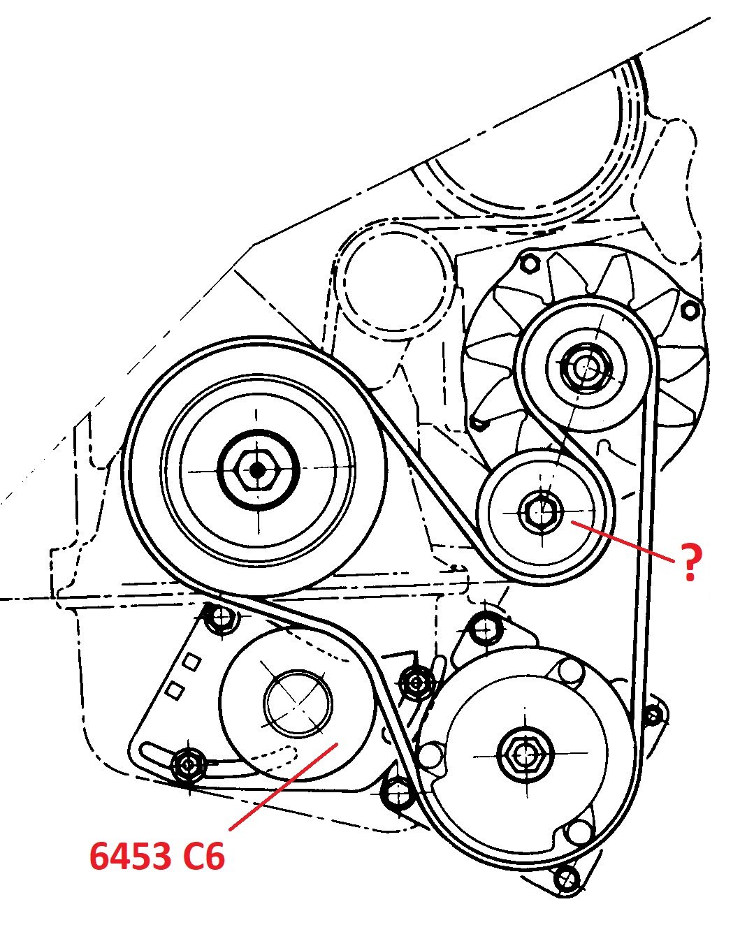

Am stuck for a part number for the upper 'diverter'/'retractor' jockey wheel in the diagram. Just cannot find it on Cit. Parts.
It's my 1992 BX 1.9D
RP 5800
Car is with factory A/C, which has its own belt pattern and tensioner/jockey.
The upper jockey appears not to be the same as that fitted to other models and non-A/C cars.
It would not be adjustable, as it's not used to set belt tension.

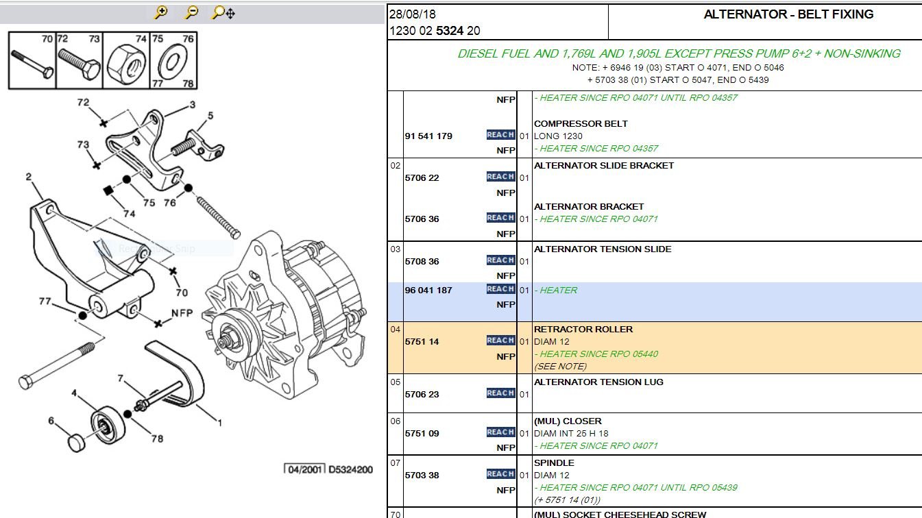

I think you might want to look under the alternator page (and not the A/C page), alternator - belt fastening. I am finding various tensioner rollers that look like they are close to the alternator. I have found one that might be right; 5751 38. This is for a BX with the following information; Diesel fuel and 1,905L and press pump 6+2 + non-sinking.
- x 1746
Re: Pt.No. I can't find...
I found that one too, James, but it's for the 6+2 pump (which is always on the ribbed aux belt), and I have the older HP pump on the end of the camshaft, with V-belt.
I searched pages for both alternator and AC compressor, but no joy.

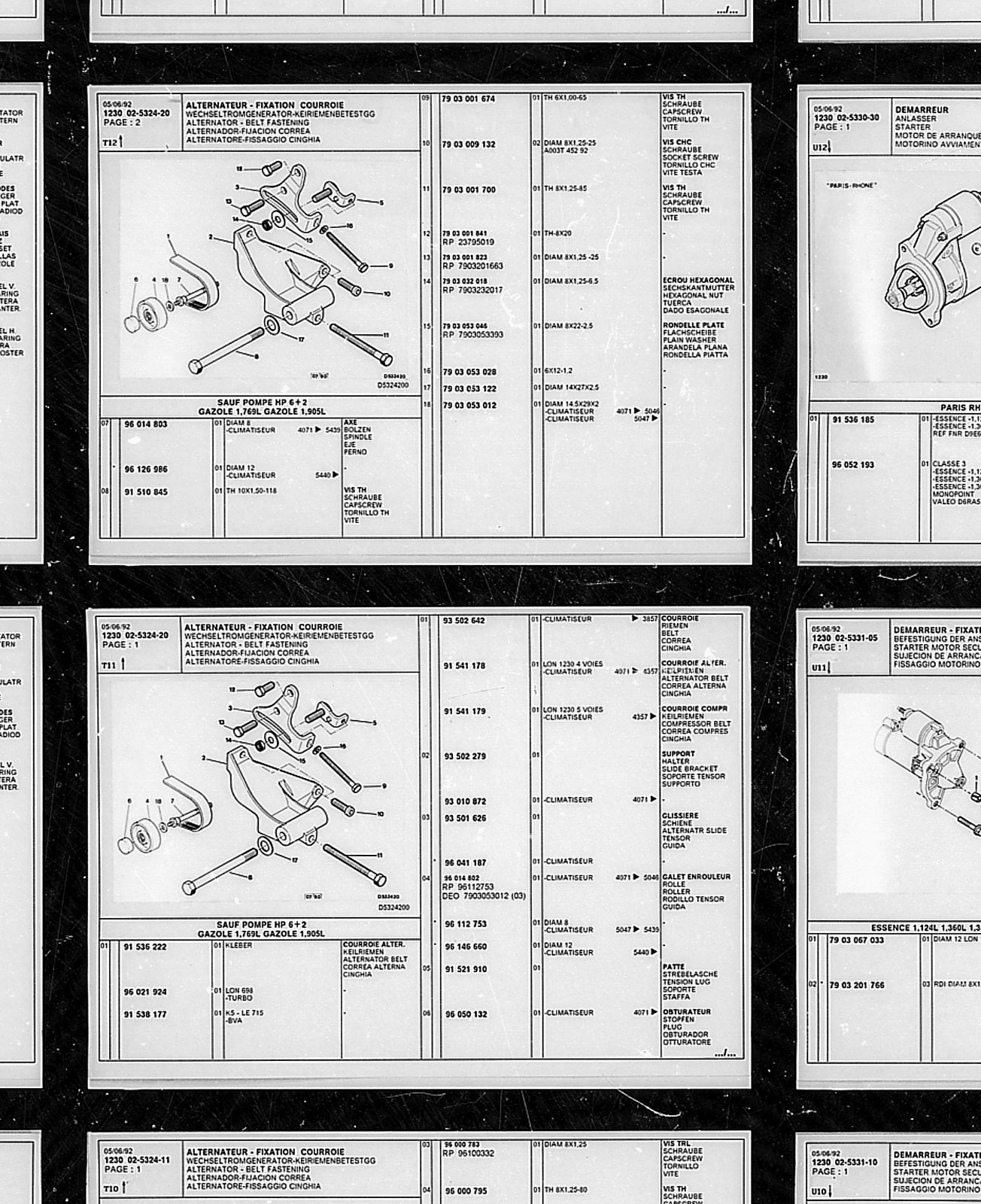

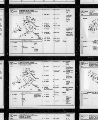

Chris have you got the files from http://on.no-ip.biz/car_catalog/bx_parts/index.html ? They appear to be a scan of the BX parts microfiche from 05/92. The files are big and the server is slow, I would suggest download and open with an image viewer rather than opening in browser.
Assuming that this is the correct diagram, there are 3 different parts, depending on build date.

Thanks guys - found it, I think.
James, you nearly got it . . . this other one is for except 6+2 *
5751 14 It's a bit of a special, as the bearing is internally threaded, with a hex socket (under the dust-cap) for securing.
Mister Auto has several, and a choice for the lower crescent tensioner too.
Mystery over. Bingo.
