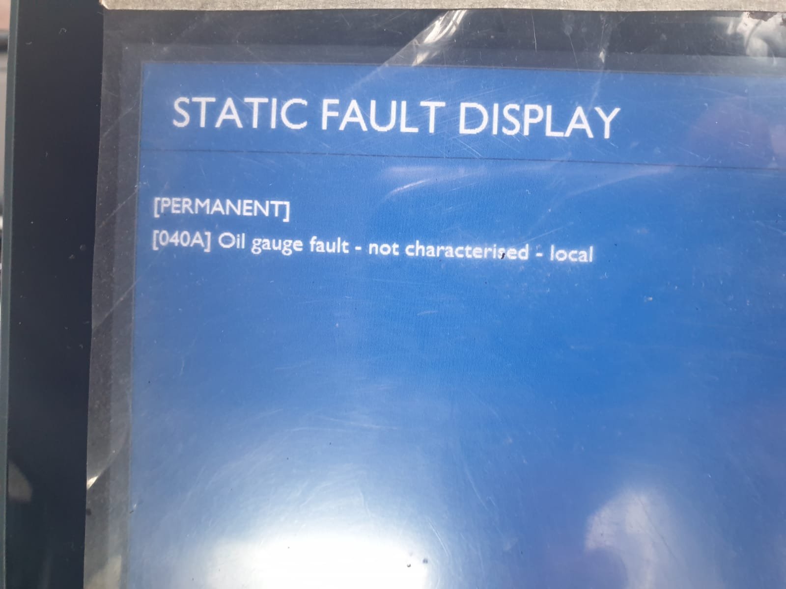

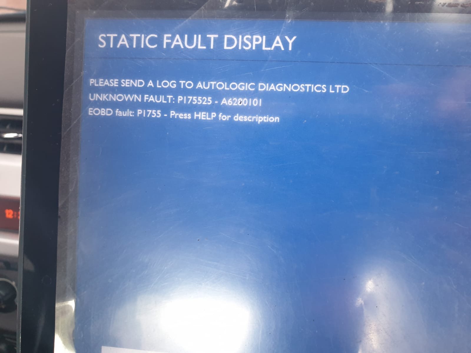

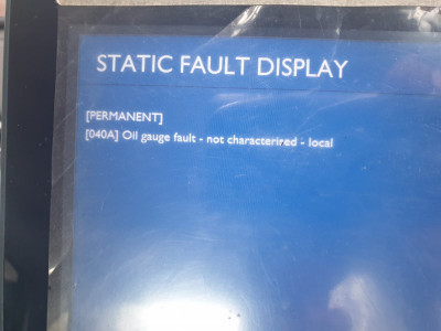

Hi I took it to another garage better computer. I attached the report to the post two faults, one minor fault oil gauge other gives unknown fault: P175525 - A6200101
EOBD Fault: P1755
Does anyone know what these codes mean.

This is isn't going to help as you can see - the possible causes are far ranging, hence my dealer suggestion ......
It may need recalibrating to set the clutch biting point - but that's just a guess at this stage.
Fault Code: P1755
Description of Fault: Clutch actuator fault: Coherence. Difference between the reference position and the measured position. Difference between the reference position and the measured position.
The time of appearance of the fault code is 1s.
Warning lamp / Warning lamp MIL will be lit.
Conditions for Fault to clear: Difference between the reference position and the measured position below the threshold.
Downgrade Modes whilst Fault is active:
  • Switch to automatic mode.
  • Sequential mode deactivated
  • Delayed changing up and changing down of gears
  • No further changedown with engine braking
  • Attempt to disengage from the gear to neutral when stopped
Symptoms:
  • Lack of power
  • Jerking/stalling
  • Difficult/impossible to change gear
  • Deactivation of the cruise control
  • Deactivation of the speed limiter
Suspect Areas:
  • Clutch actuator
  • Clutch
  • Piloted manual gearbox ECU
  • Electrical harness
