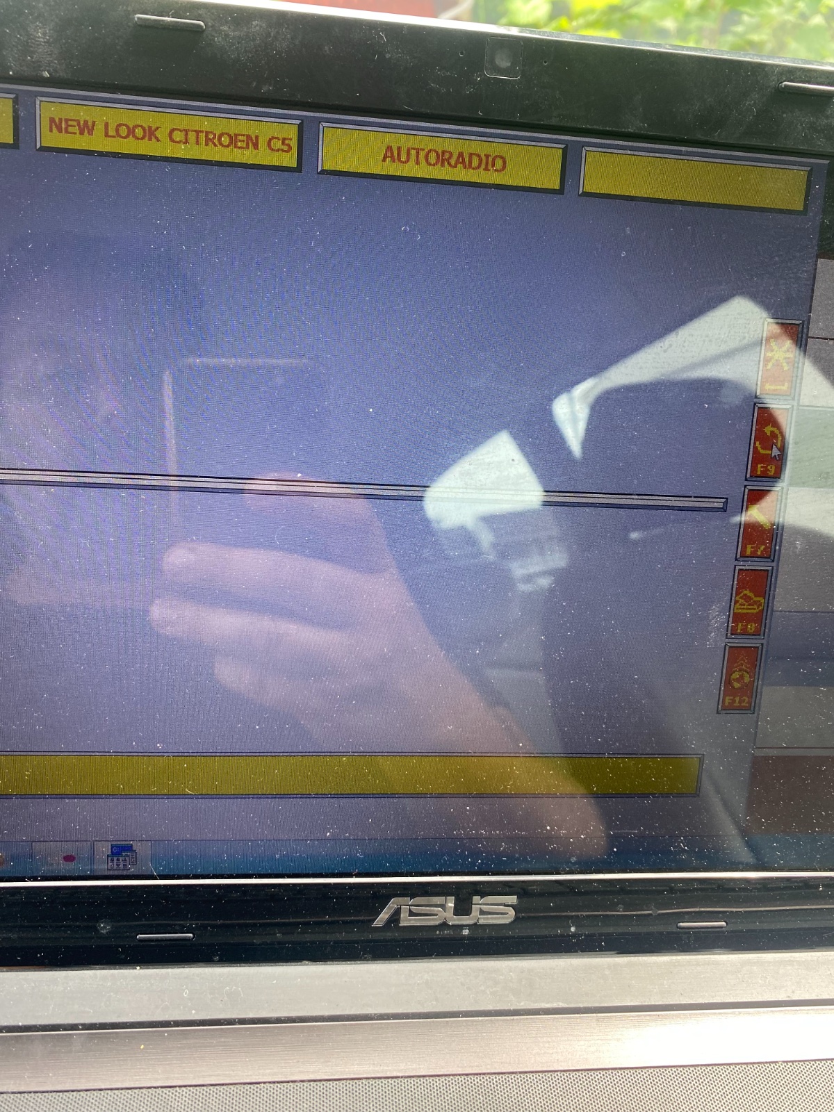

I’m trying to activate the AUX input on my radio with Lexia.
Problem is that as soon as I go in to the radio to configure it, I just get a blank line. Any clues why?

When you ran the global test, was there an ECU for the RD4 or just Autoradio? Which system do you have fitted?
Is Lexia picking up all the other detected ECUs?

The radio says Blaupunkt RD4 on a label, but lexia only said Radio when running global test. In total it found 10 ECUs if I’m not mistaken…

Ok, so without getting the main menu up for the ECU,. you are not going to get into the configuration screen. Maybe your VCI is a revision B and not fully CAN compliant with missing hardware. The cheaper Chinese clones did cut-down versions that have issues with the C5. If the VCI can't communicate with the some ECUs that may be where your problem lies. Are you using Diagbox which launches Lexia automatically, or a native Lexia only installation? If Diagbox, what version of software are you on?
