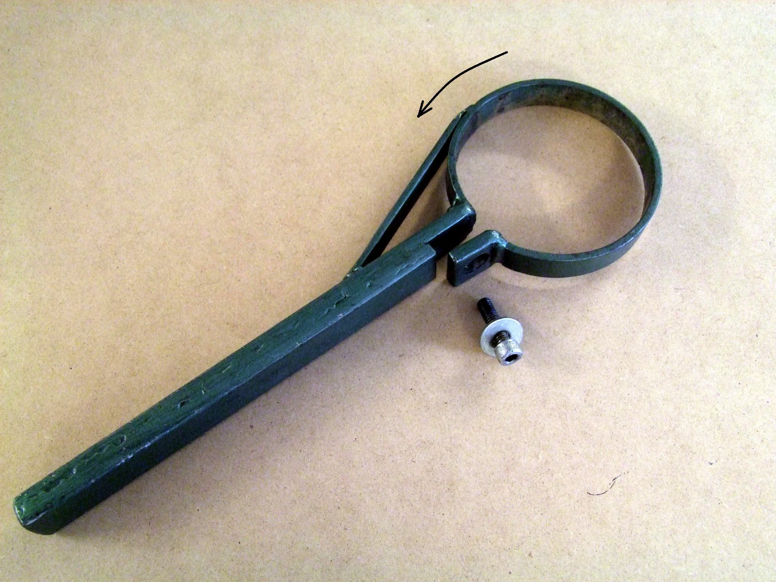

You could always try making your own sphere removal tool;
https://www.frenchcarforum.co.uk/forum/ ... hp?t=21850

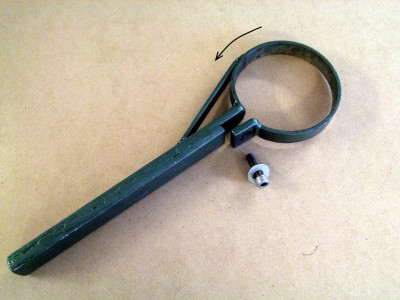

Re: Cracking C5 spheres needed befoire removal?
Home-made jobbie. Anyone with welding kit could make up one of these for you...
Form the loop around an old sphere when making it.
