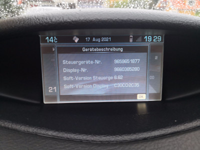

Let me know what it says or take a picture of the screen and upload it to the Forum using the full post editor button / attachments/ browse to photo/ then use PLACE to put the picture in line with the text where you want it.

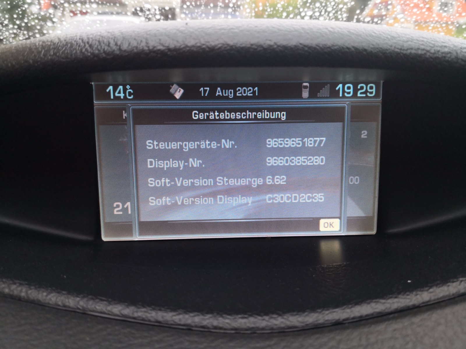

Sorry for the late reply but this is what it looks like.
x 6955
Re: Change language
Ok, so better late than never :-D
So that indicates you have the CAN version.

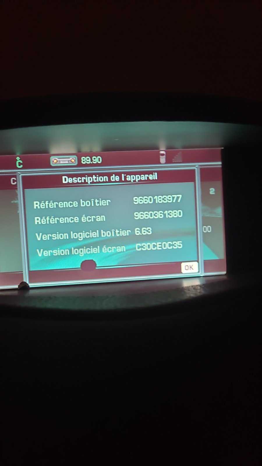

You need to advise me of what the current Software you have is - take a screenshot like the previous guy did and post it here (using the full post editor to upload your image)

I send now

Re: Change language
Unread post by Adelin »
It s ok?
x 6955
Re: Change language
Ok, so you too have the CAN version.
I will send a link with the correct ISO - but you will have to burn the ISO image onto a CD, (very slow burn speed) & finalise the CD.
Then insert the CD and you can change the language, voice synthesis (Male / Female) etc.
Check your Private Messages shortly.
