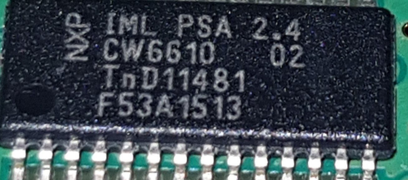

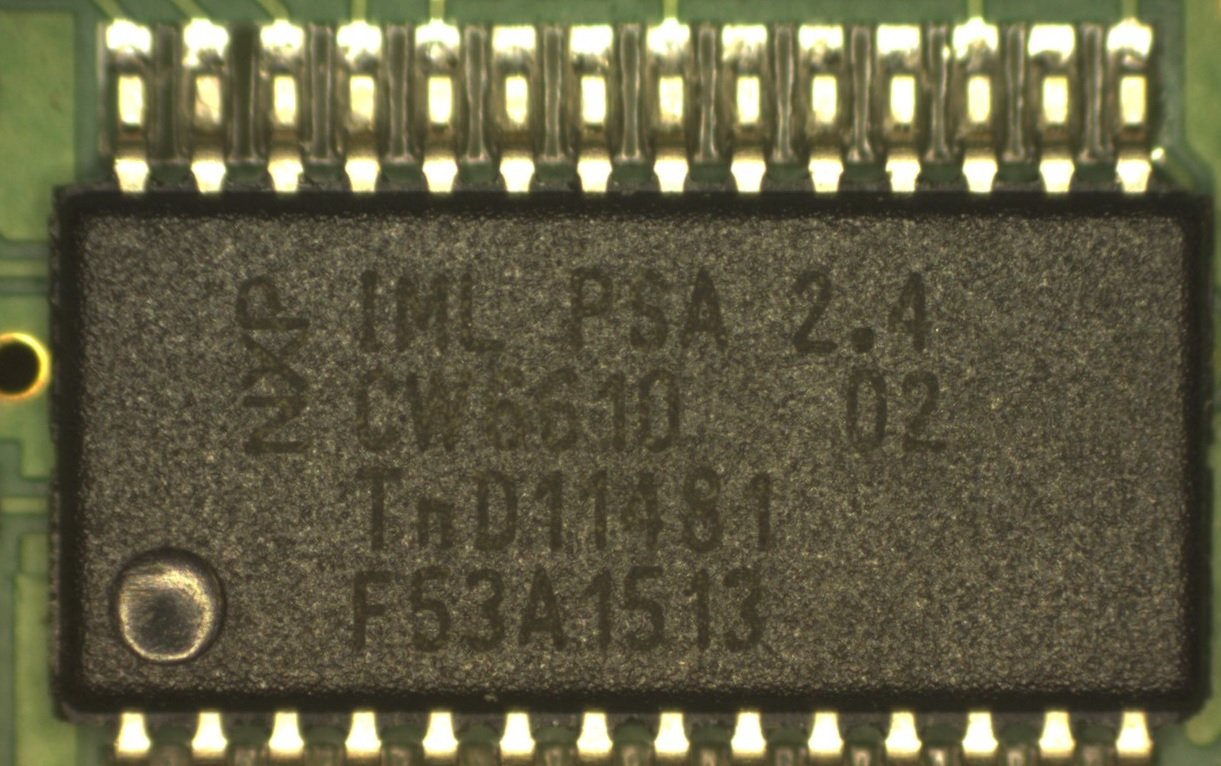

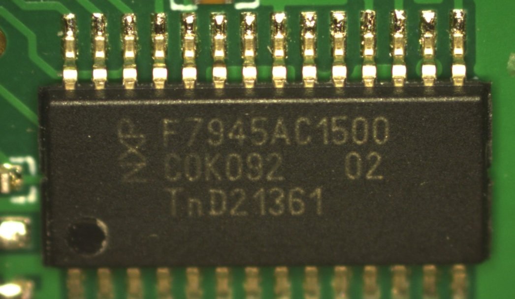

The key on my 508 (2012) broke. I bought a second new key (P98124195ZD) with an ID46 chip - PCF7945, but my key has a F53A1513 chip.

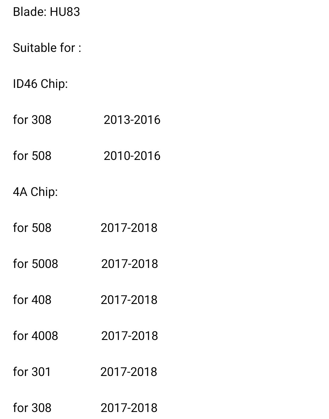

Maybe this car is meant to have a 4A chip rather than ID46?

The OEM code from the VIN points to a part with ID46. A4 should have been used since 2016. Can it be ruled out that my 508 has a specific chip? I found very little information about F53A1513.

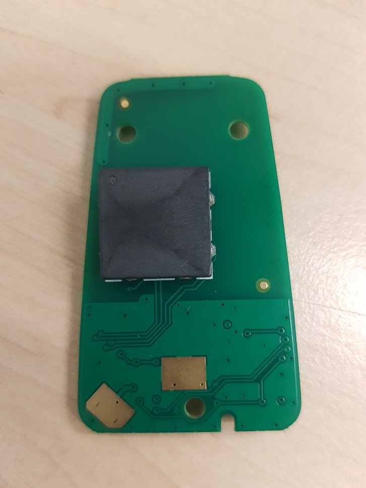

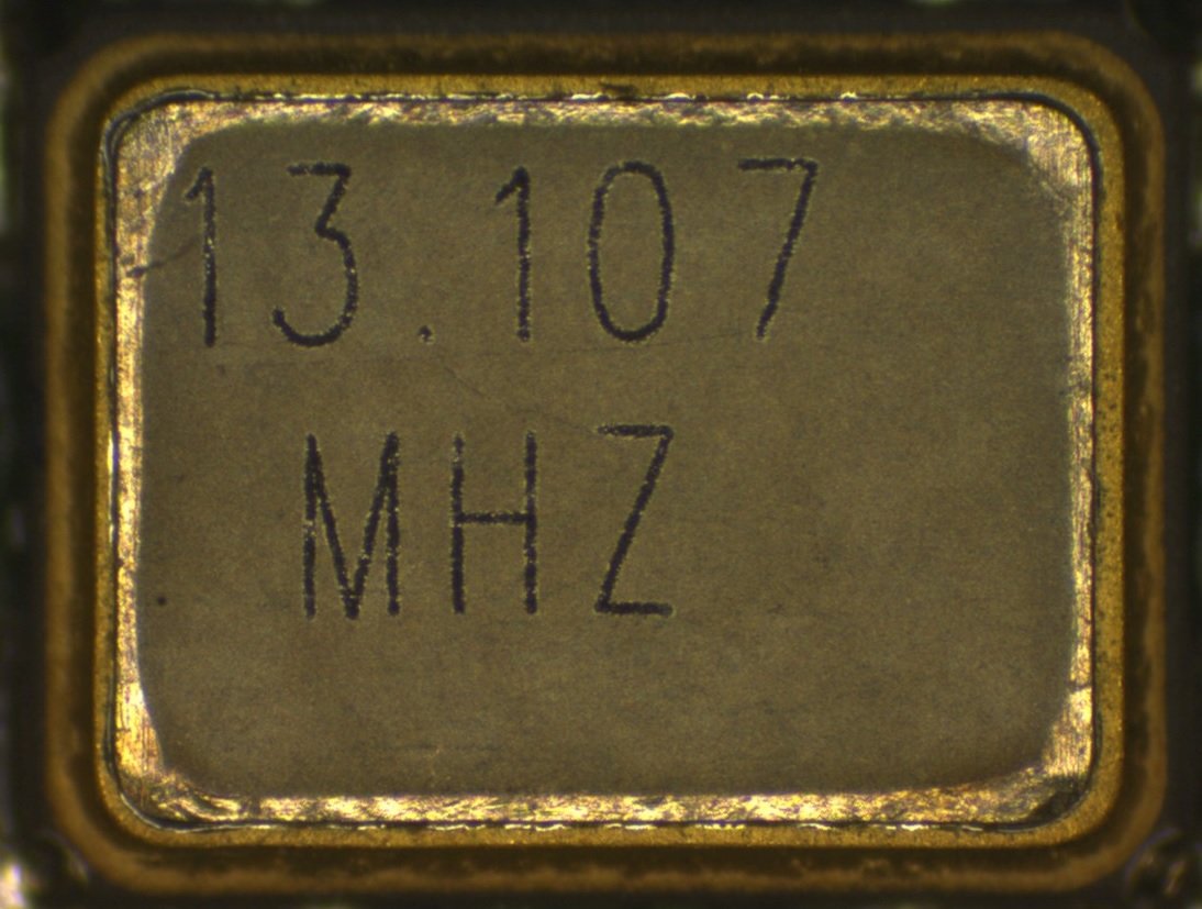

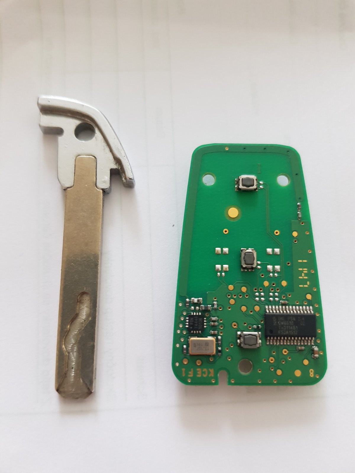

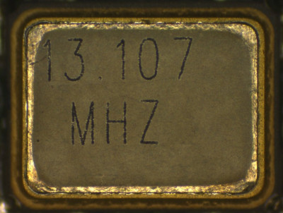

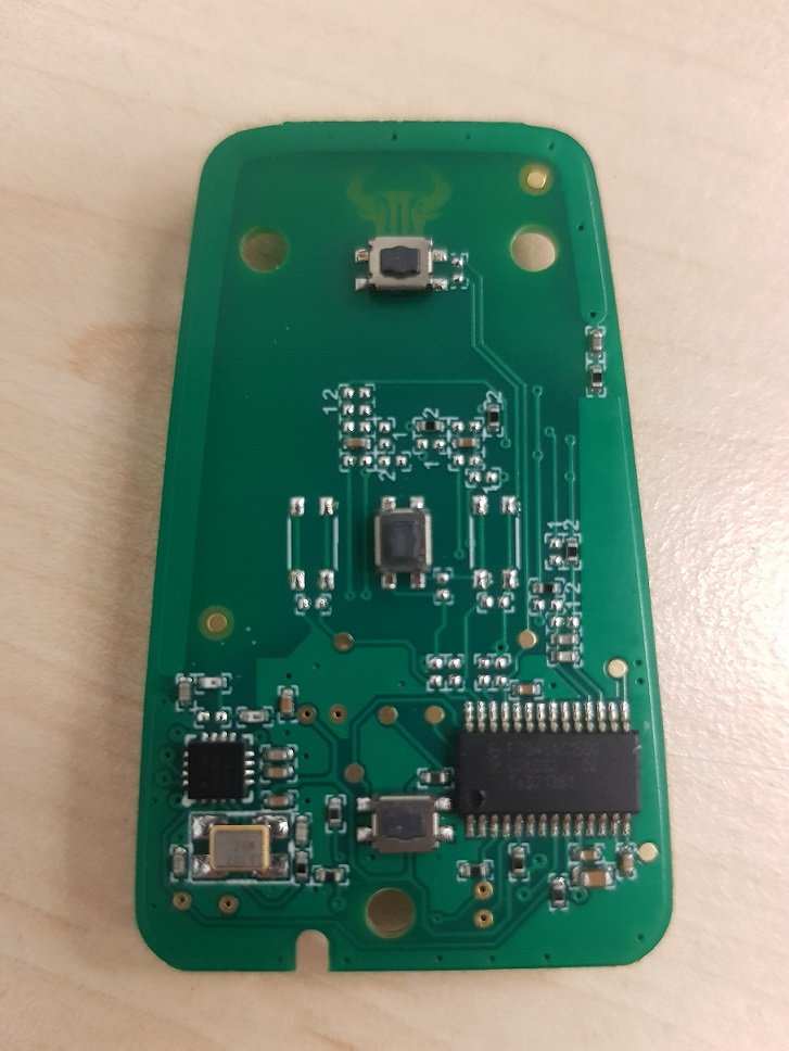

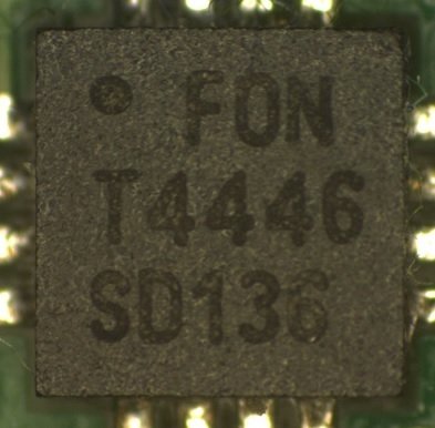

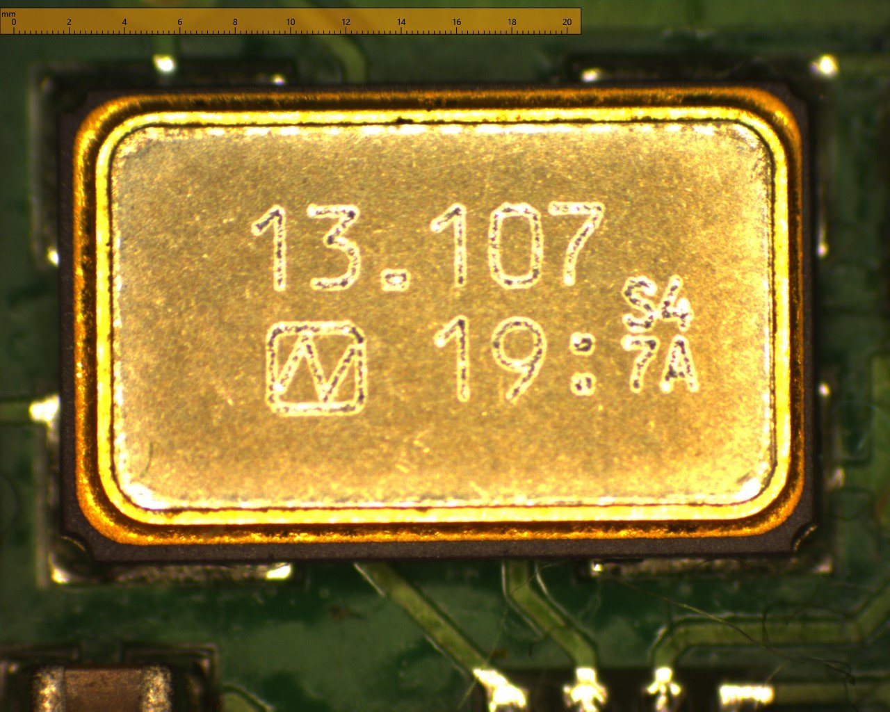

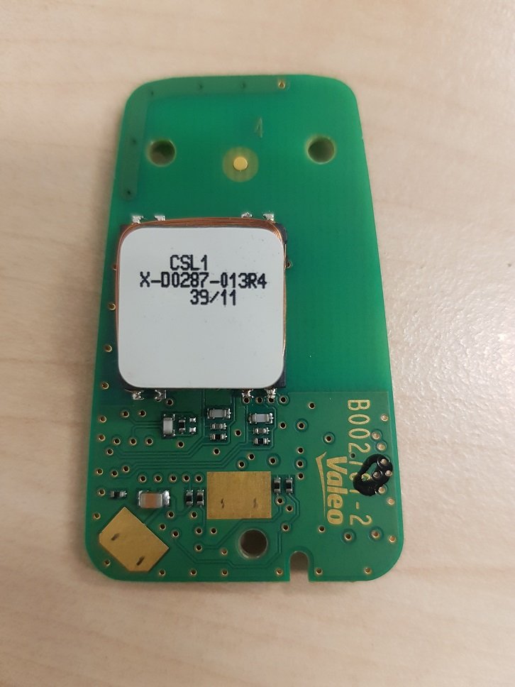

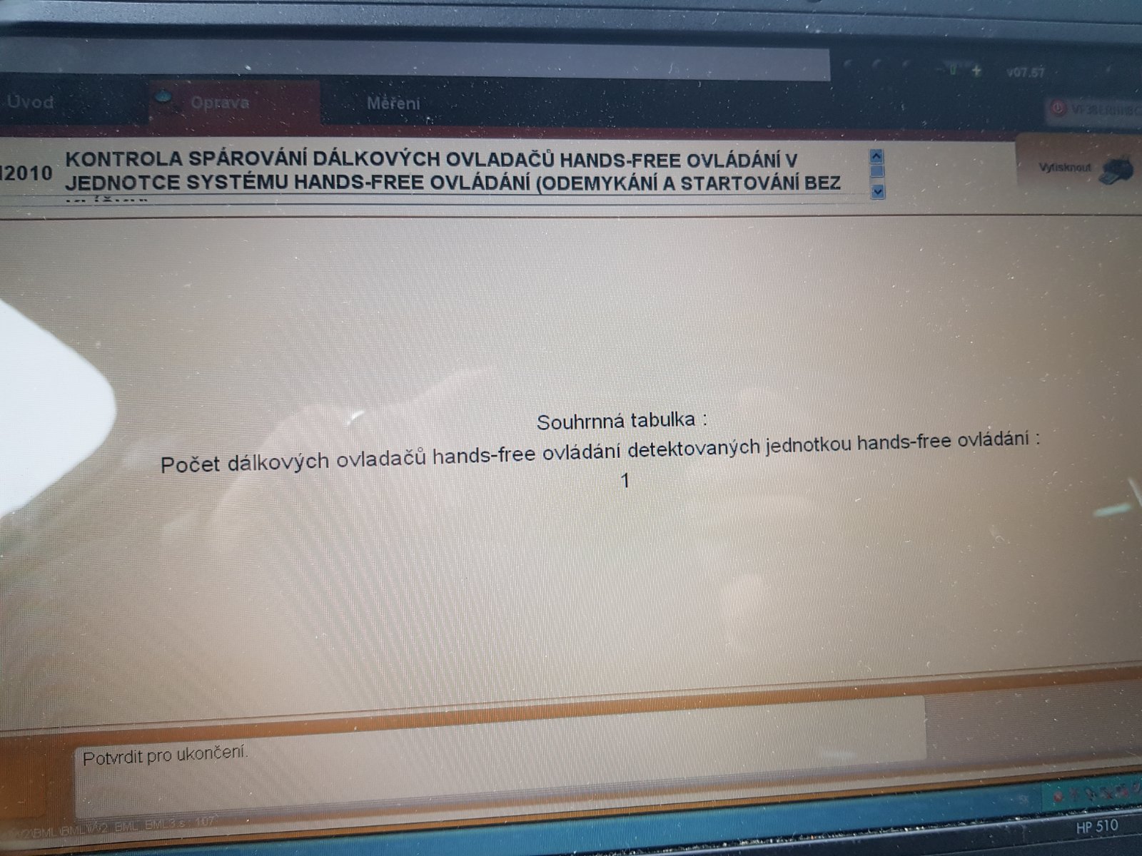

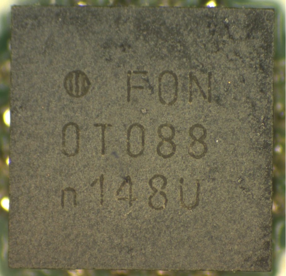

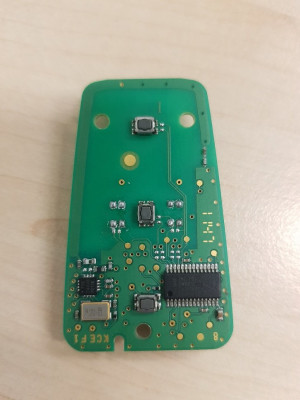

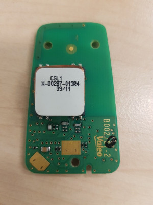

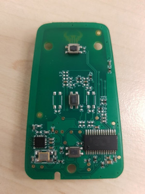

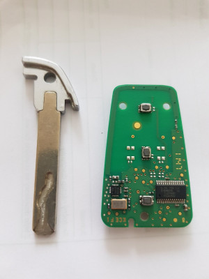

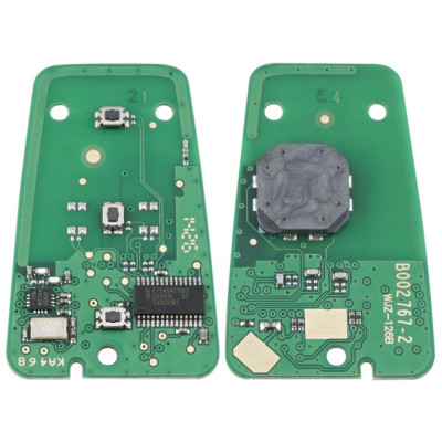

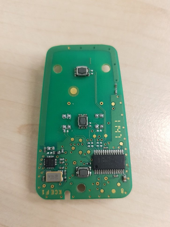

No function works with the new key after coding via diagbox v7.57. I have a feeling that I am doing something wrong. After the key programming process, the vehicle checks the presence of keys on board. The inspection found only 1 flood original key. I will add photos of the old and new key. Sorry for my English

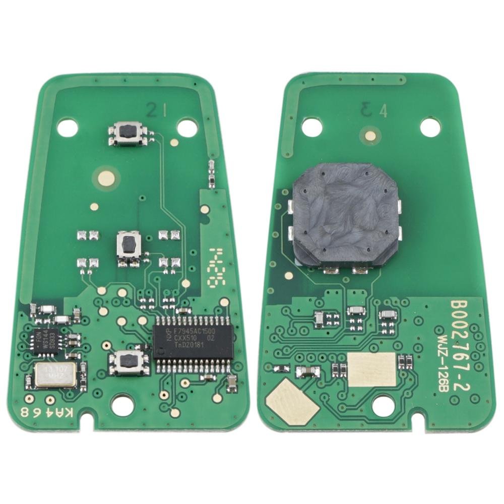

Re: 508 key programming
I successfully managed to pair a key from another seller. The electronics is marked as original B002767-2

Interesting. The "new" circuit board, visually at least, seems to be of lower quality than the original Valeo circuit board.
Cheap Aliexpress key, I guess?
