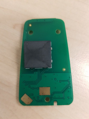

Hello.
Has anyone solved this problem?
The key on my 508 (2012) broke. I bought a second new key (P98124195ZD) with an ID46 chip - PCF7945, but my key has a F53A1513 chip.
I was unable to program either remote unlocking or keyless start through the diagbox.
You can help me ?
What are my options?
Can I use a key from another Peugeot 508 with the same chip?
Well thank you
You can help me ?
Well thank you

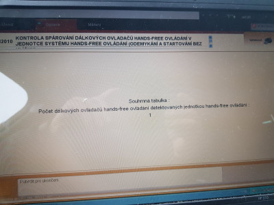

No function works with the new key after coding via diagbox v7.57. I have a feeling that I am doing something wrong. After the key programming process, the vehicle checks the presence of keys on board. The inspection found only 1 flood original key. I will add photos of the old and new key. Sorry for my English

Re: 508 key programming
I successfully managed to pair a key from another seller. The electronics is marked as original B002767-2
Interesting. The "new" circuit board, visually at least, seems to be of lower quality than the original Valeo circuit board.
Cheap Aliexpress key, I guess?
