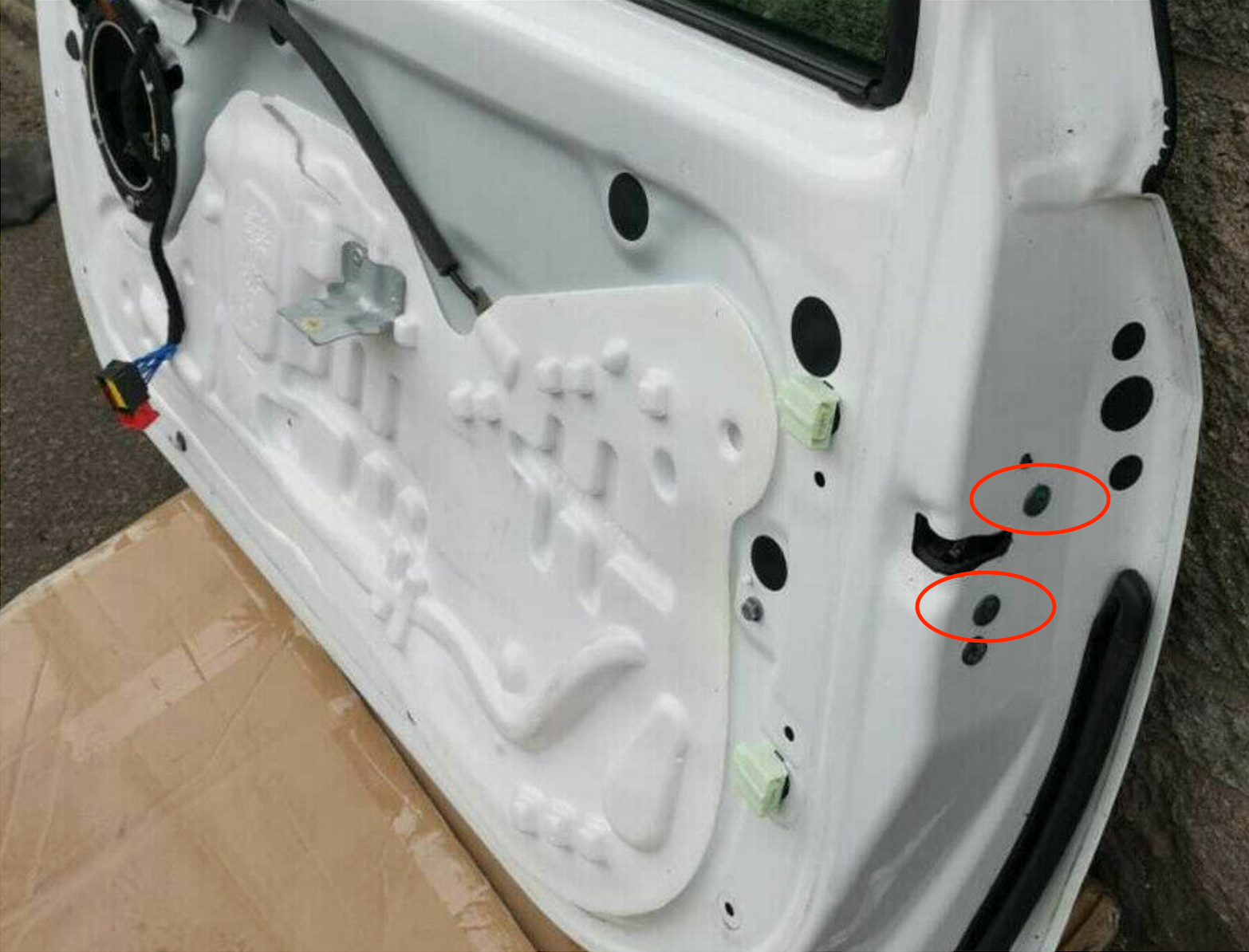

Took my 2011 DS3 in for its walnut blasting yesterday and the guys at the garage kindly pointed out I was missing two bolts from the locking mechanism on my drivers side door making it rattle!
Does anyone have a part number or spec for these bolts. I know they're T30 torx but that's about it for now.
I haven't had the chance to get them out the passenger side door to measure yet but if any knows where I can find some spares that'd be great haha.

A photo of the specific bolts will help and save time.

Sorry probs should've thought of that.
Don't have the car on me at the moment to take an actual photo but found a photo of a DS3 door online and circled the bolts/screws

Also, I think they're covered by little black bits of plastic usually but I'm not too fussed about those I just need the screw cheers

Part no 9677354780 and they are 26p each from the dealer.

Bargain thanks a lot for your help!
