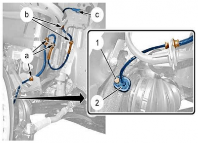

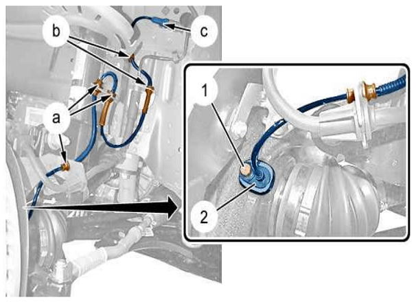

Re: Espr and many other faults in rain
The front wheel sensor is shown at (2) with cabling.
