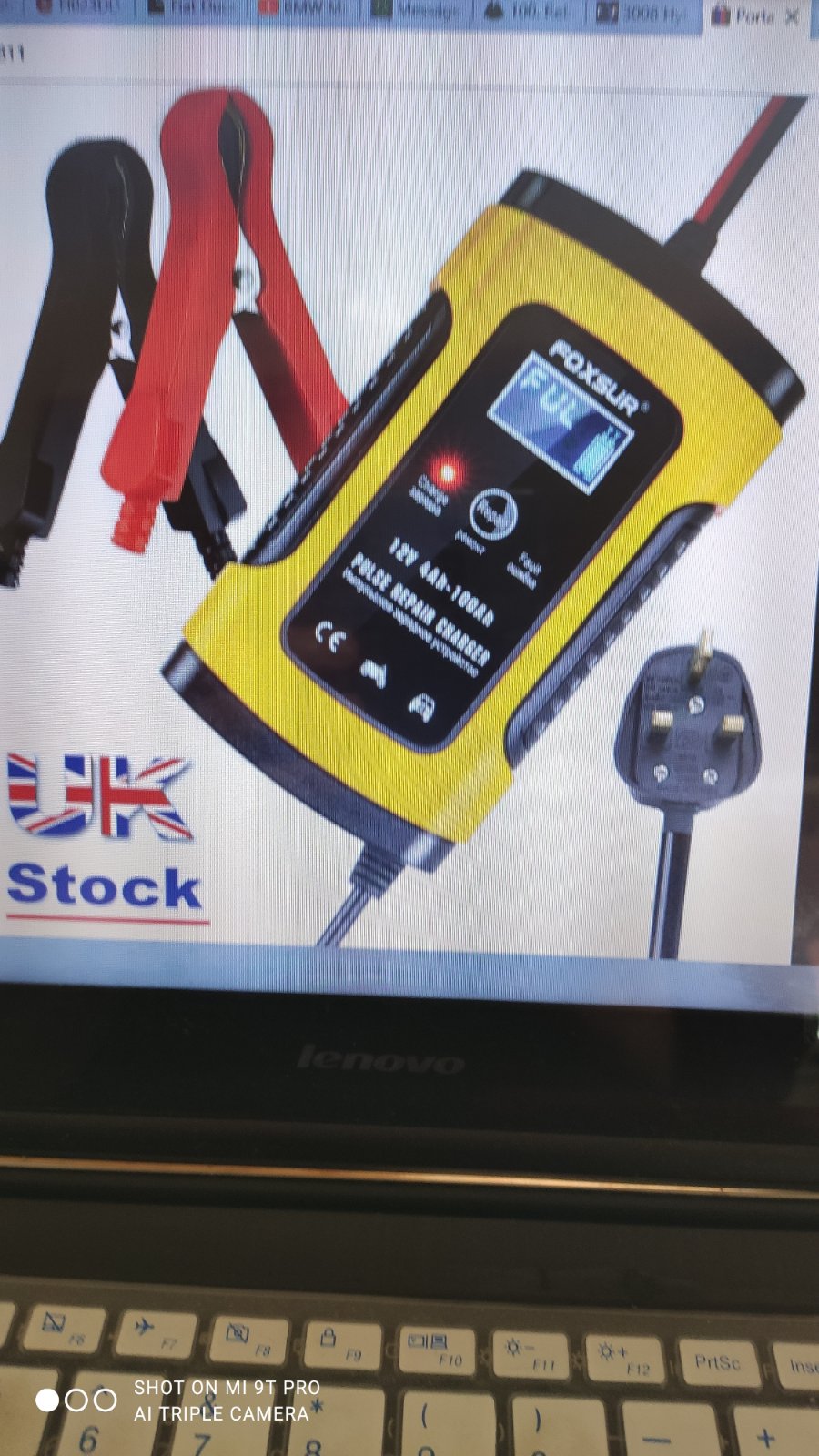

Re: 3008 Hybrid - Unable to go into Electric mode
This is the type I bought and have used it as a test guage on our 3008 as well as a trickle charger until we cured the fault. I have also used it on our camper and caravan batteries to apparently good effect. The old battery that was changed out of our 3008 was pulse charge repaired and used to good effect in our caravan when we used it recently and our camper batteries are all being maintained too
I bought similar model charger but in red, looks like same manufacturer just different name and colour. Used on my 2008 auto which wouldn’t stop start when I bought it second hand a few weeks ago, pulse charged battery for 24 hours and stop start still working.Dormouse wrote: 03 Jul 2021, 09:56 This is the type I bought and have used it as a test guage on our 3008 as well as a trickle charger until we cured the fault. I have also used it on our camper and caravan batteries to apparently good effect. The old battery that was changed out of our 3008 was pulse charge repaired and used to good effect in our caravan when we used it recently and our camper batteries are all being maintained too

Yes. I hummed and ha 'ed before I bought this cheap charger but I find it works very well.
