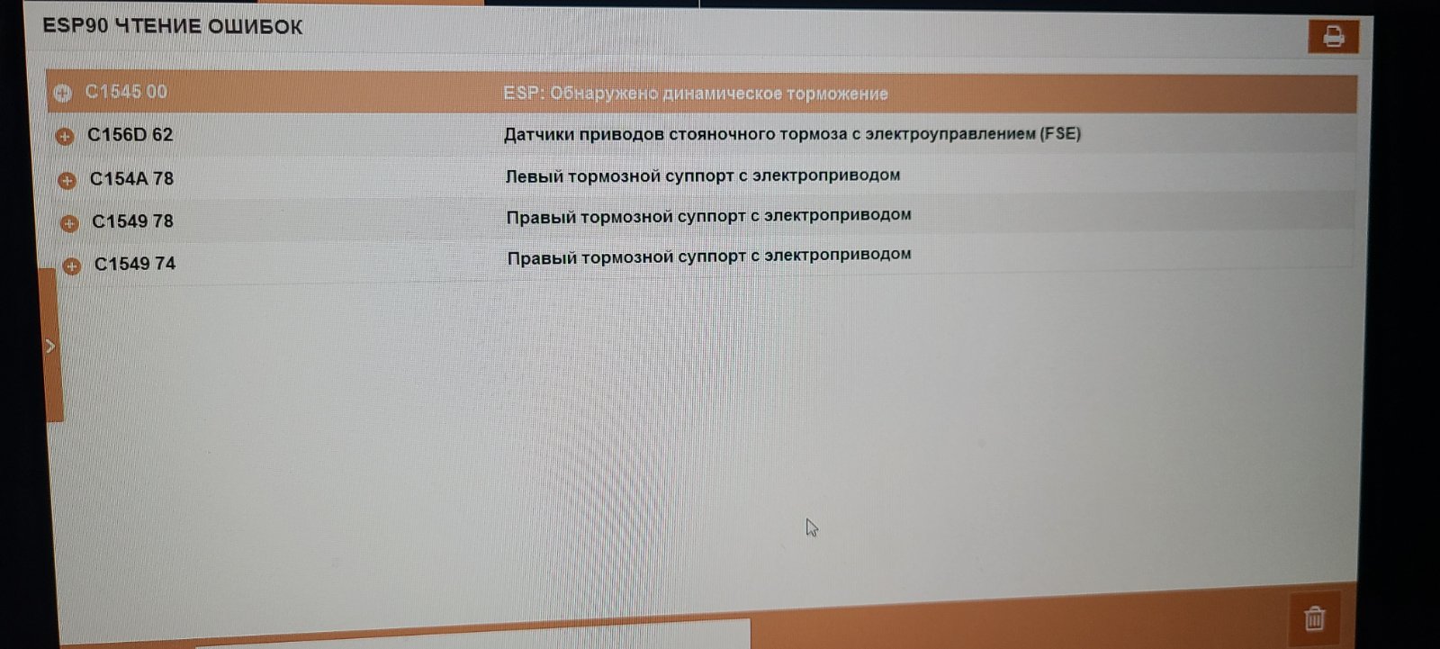

When trying to free the rear calipers using diagbox 9.68 to replace the rear pads, several bugs popped up, including the C156D62 which does not wear off and the handbrake is no longer tightened.
In this case, the handbrake signs are constantly flashing on the dashboard.
Today I checked the wiring, it is intact without damage.
My car is a 2018 Citroen c4 Grand picasso, 1.6 bluehdi engine with aisin automatic transmission.

Might be worth trying to recalibrate the system with diagbox & go through the procedure as if you have replaced the calipers/cables.

How do all. I have the same fault C156D62 on a 2018 C4 B78 2018 model 1.6 HDI 120BHP. Tried to recalibrate as if new caliper as above but the calibration cannot be completed due to the active code. The DTC will not clear after the partial calibration. Any help would be greatly received. Using the Topdon topscan tool.

Update to my specific issue. I managed to clear the fault by having the engine running and holding the handbrake switch on for more than 10s with my foot on the brake (normal handbrake application procedure) which then activated the actuators to work normally and then allow me to clear the ABS DTC.
