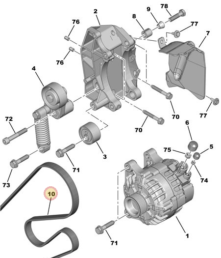

That diagram was for the timing belt, tensioner rollers and water pump which is what I thought you wanted.
Accessories belt below:
Parts:
Original OEM: 5750YE: £44.18
Citroen Cheaper Alternative: 1612551780: £32.88
Parts:

Re: New aux belt is 5mm shorter - is going to hurt anything??
Ah that's great - thank you. I can see that 5750YE is coming up as both 1565mm and 1560mm length depending on the manufacturer - so my new one might be fine after all (Gates 1560mm).GiveMeABreak wrote: ↑16 Jun 2021, 19:35 That diagram was for the timing belt, tensioner rollers and water pump which is what I thought you wanted.
Parts:
Many thanks
Your correct one is actually 1564 listed against part number 5750YE, now that we are on the same page
