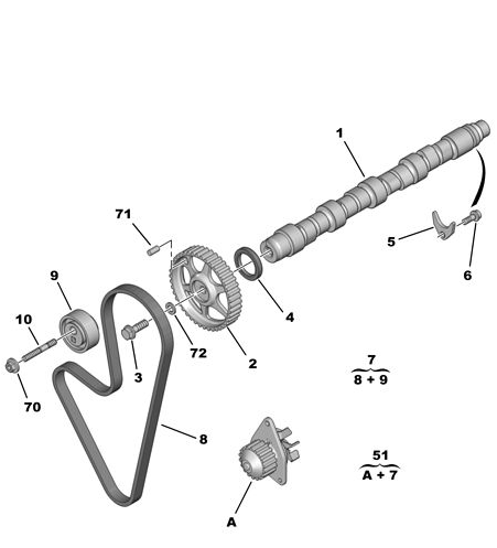

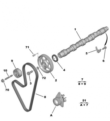

There are 3 options available for your vehicle from Citroen: The belt, the belt and the roller kit, or all of the previous plus the coolant pump:
Part: 081655 is the for the OEM original equipment belt. £100.20 (item 8).
Part: 1633128380 is for a cheaper Citroen recommended belt but not original equipment. £41.18
The Belt and Roller OEM kit is no longer available from Citroen, but they do supply a cheaper version - part no: E118415 £69.46 (Item 7).
Finally the belt, roller and pump kit is part (cheaper version): 1611898280 £172.32 (Item 51).
All prices VAT inclusive for reference.

Looking at that diagram - is the timing belt and waterpump?
Today's was the aux belt - alternator and air-con.
- x 6954
Re: New aux belt is 5mm shorter - is going to hurt anything??
Sorry, not sure what you are asking me here?
Hi,
Was just checking if the diagram you posted was the aux belt or the timing/cambelt?
- x 6954

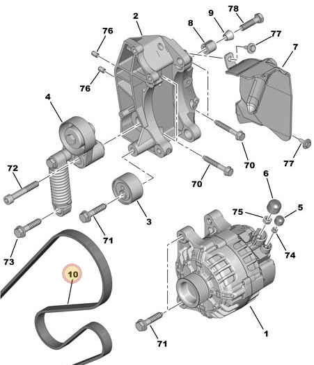

That diagram was for the timing belt, tensioner rollers and water pump which is what I thought you wanted.
Accessories belt below:
Parts:
Original OEM: 5750YE: £44.18
Citroen Cheaper Alternative: 1612551780: £32.88
Parts:
Ah that's great - thank you. I can see that 5750YE is coming up as both 1565mm and 1560mm length depending on the manufacturer - so my new one might be fine after all (Gates 1560mm).GiveMeABreak wrote: 16 Jun 2021, 19:35 That diagram was for the timing belt, tensioner rollers and water pump which is what I thought you wanted.
Parts:
Many thanks
- x 6954
Your correct one is actually 1564 listed against part number 5750YE, now that we are on the same page
