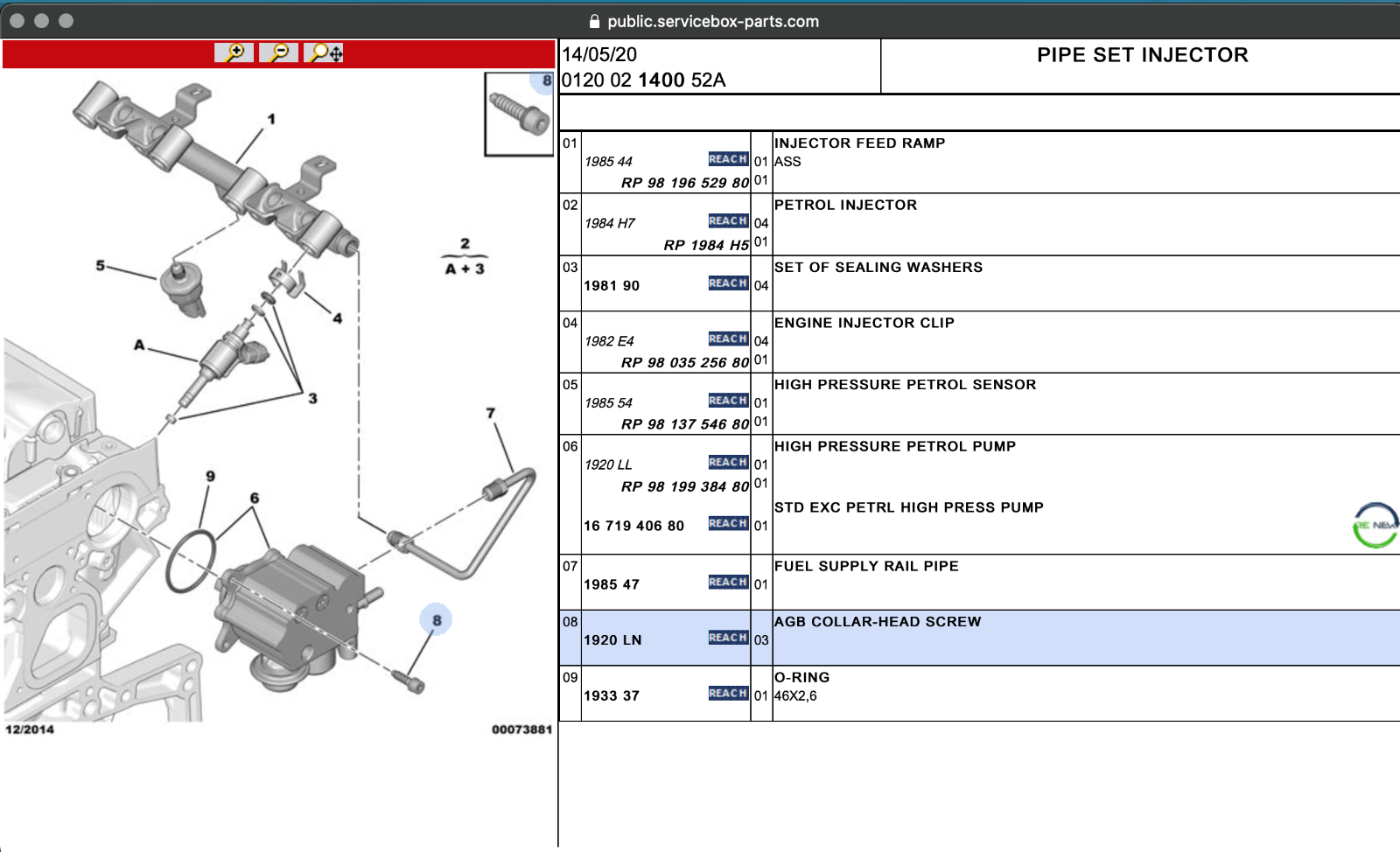

Bit of a cock up on my part today. Replaced the high pressure fuel pump in my 2011 1.6 DS3 THP since I was getting some incredibly low pressures.
Any way all was going well until I accidentally snapped the clasp for the fuel feed into the high pressure pump i.e the other fuel line not the high pressure line.
Was hoping I could bodge it with a jubilee clip or some zip ties but no luck as soon as the key is in the ignition and the fuel line primes it comes off and fuel goes everywhere.
I've searched high and low for a replacement clip, connector and hose (even on the Citroen service box) and cannot for the life of me find a part number or replacement anywhere online.
I've attached the best diagram I could find on the service box but it only shows the high pressure line (7).
Has anyone had any luck replacing theres or got any ideas before I give my nearest Citroen dealer and mechanic a ring?
Thanks for your help!

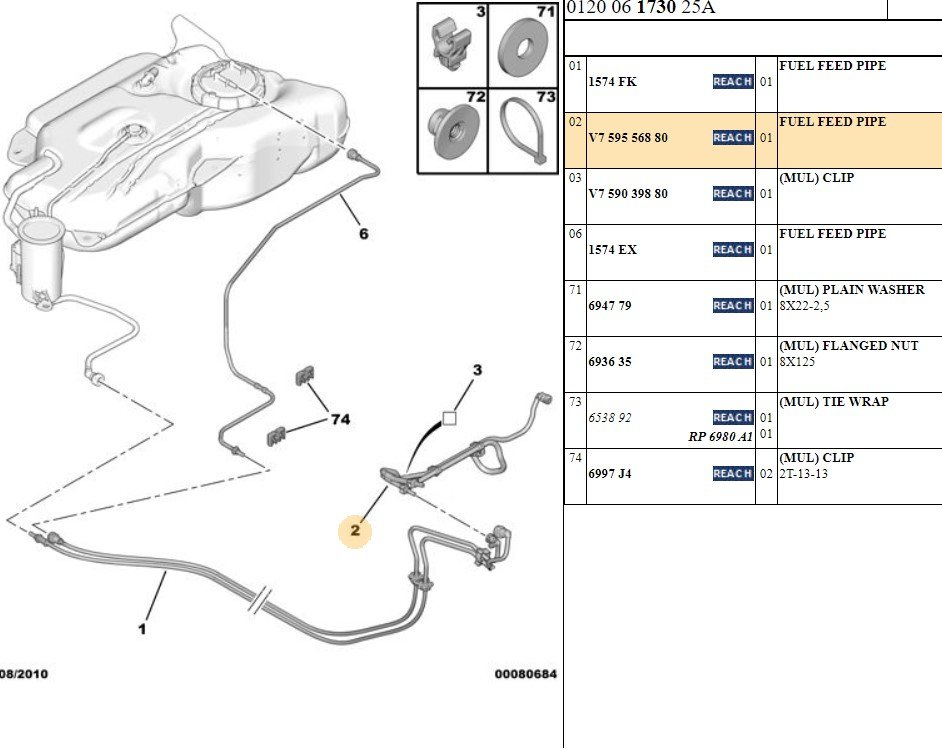

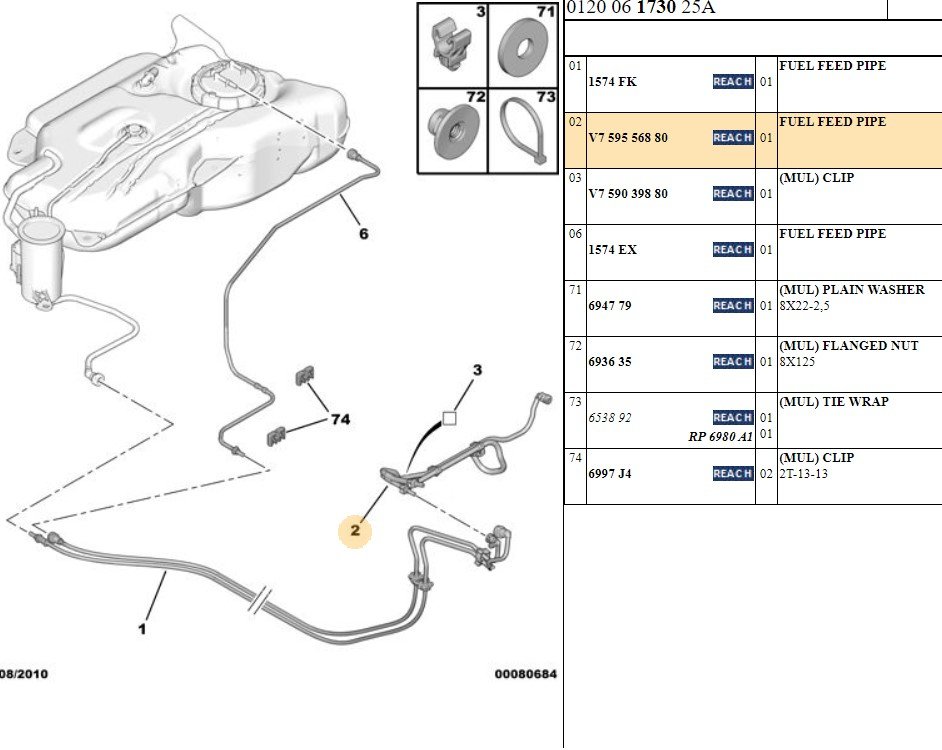

Number 2 ??
PS You also have an outstanding recall on this car, Best to contact your Dealer.

wheeler wrote: 07 Jun 2021, 22:24 Number 2 ??
Thank you so much for your help!
