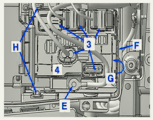

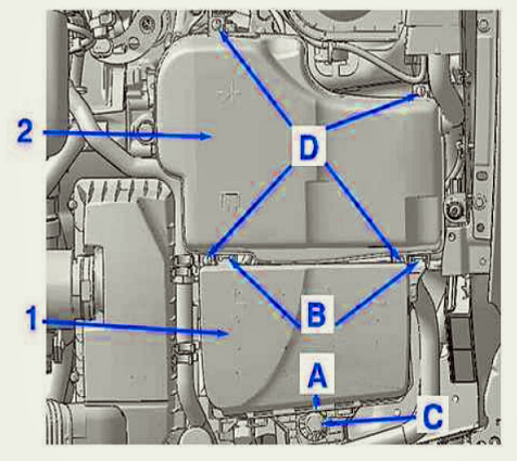

Hi David, as per your PM, here's how to replace the engine fusebox:

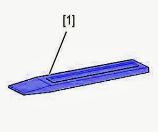

You'll need a trim tool / spatula like this:

Undo the retaining strap of the battery cover (1) ( as (A)) .
Unclip: The cover (1) ( as (B)).
Remove: The cover (1).
After switching off the ignition, wait 2 minutes before disconnecting the battery following the BSI Reset / Battery Disconnect / Reconnect Procedure
Unscrew: The battery fastener (C) (A quarter turn).
Unscrew: The 4 mountings (A quarter turn) ( as (D)).
Remove The engine wiring housing cover (2).
Disconnect: Battery earth cable ( as (E)).
Unclip: The connectors (3) (Slave unit).
Unclip: The unit (4) ( as (F)).
Only use the hydraulic fluid (4) (At (G)).
Detach: The unit (4) ( as (H)) .
Remove: The unit (4).

Proceed in the reverse order to removal.
Follow the reconnection part of the BSI Reset / Battery Disconnect / Reconnect Procedure.
Check the operation of the equipment.
