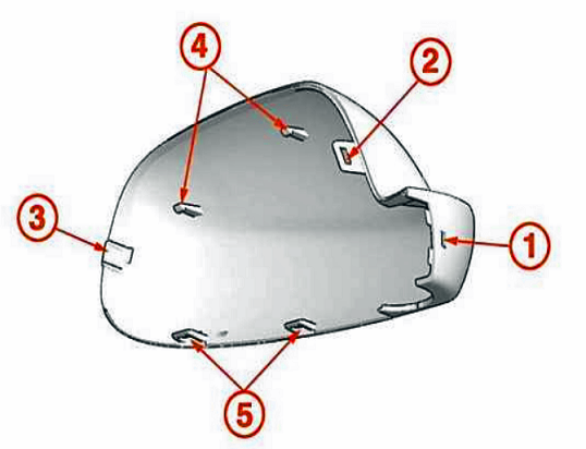

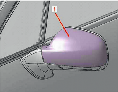

So, first you need to remove the mirror shell:
Lower the glass fully.
Fold the mirror.
Mirror ShellUsing a flat tool, carefully unclip the casing (1) in the order (From 1 to 5) .
Detach - Remove the mirror casing (1).

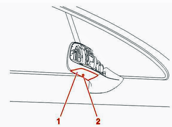

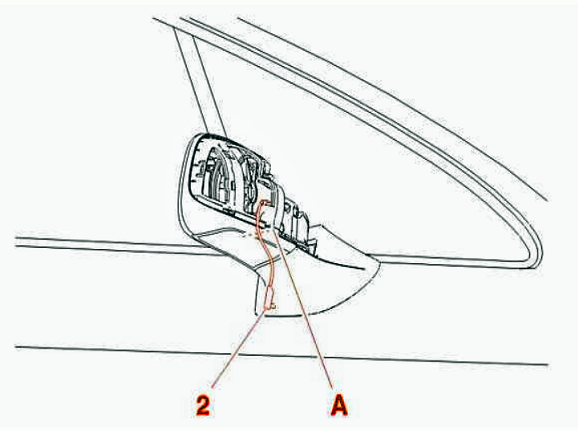

Unclip and remove: The cover (1) (Using a flat tool) .
Unclip: The temperature sensor (2) from the cover (1).
Detach the sensor and the harness to obtain a sufficient length of wire.
Cut the black wires of the sensor (2) (at "A").
"A" = 30 mm minimum from the sensor.
Remove the sensor (2).
Refitting
Re-establish the electrical connection using welding sleeves then insulate using the heat-shrink sleeve.
