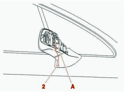

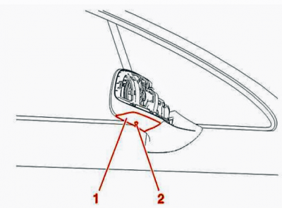

There's not much that can go wrong with these and they are cheap enough to purchase. Your issue is going to be the fitting, as often it means cutting the original sensor wiring, leaving enough to splice in the new sensor wiring and refit.

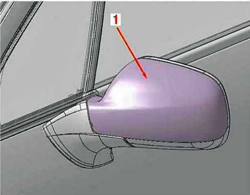

So, first you need to remove the mirror shell:
Lower the glass fully.
Fold the mirror.
Fold the mirror.
Mirror Shell | Using a flat tool, carefully unclip the casing (1) in the order (From 1 to 5) . Detach - Remove the mirror casing (1). |
Unclip and remove: The cover (1) (Using a flat tool) . Unclip: The temperature sensor (2) from the cover (1). | Detach the sensor and the harness to obtain a sufficient length of wire. Cut the black wires of the sensor (2) (at "A"). "A" = 30 mm minimum from the sensor. Remove the sensor (2). |
Re-establish the electrical connection using welding sleeves then insulate using the heat-shrink sleeve.
Proceed in the reverse order to removal.
Check the operation.
