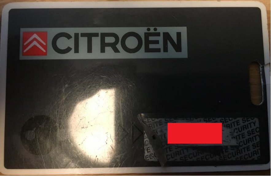

Thank you, do you have a picture of a security card, need to see if I have it?

I don't have such a card, but it is abut the size of a normal credit card with a scratch off panel. Normally you will get two cards with the vehicle when it is first supplied. It may look like the card in the following link;

Re: New Key
That is the correct card you need

Re: New Key
I found the card
