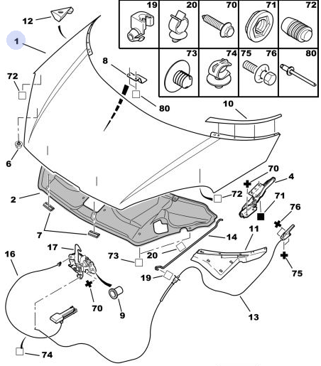

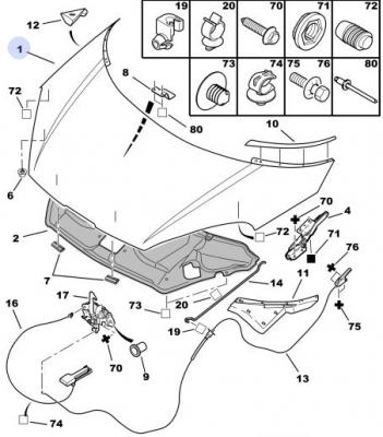

So I'm assuming you have part (16) - which is a blessing as it would be difficult if you had the internal initial release cable go (13) as the whole fascia has to come off to get to that!

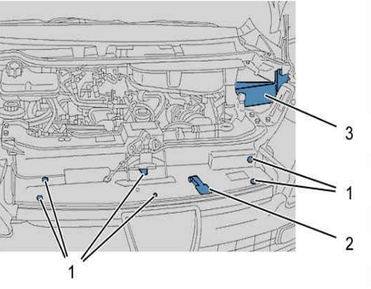

When mine went on my C5, it was a matter of just identifying where the old one was clipped onto and taking a few pictures of the routing, before replacing it.
This is the relevant part of the procedure - the other is for the larger cable.
Remove:
  • The clips (1 )
  • The upper baffle of the grille (2)
  • Unclip the cable from its housing.
