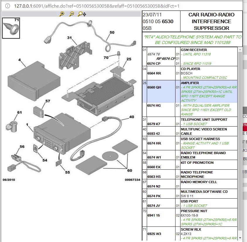

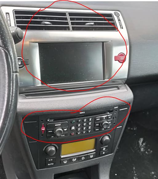

I have the opportunity to buy genuine RT4 + LCD. See photo

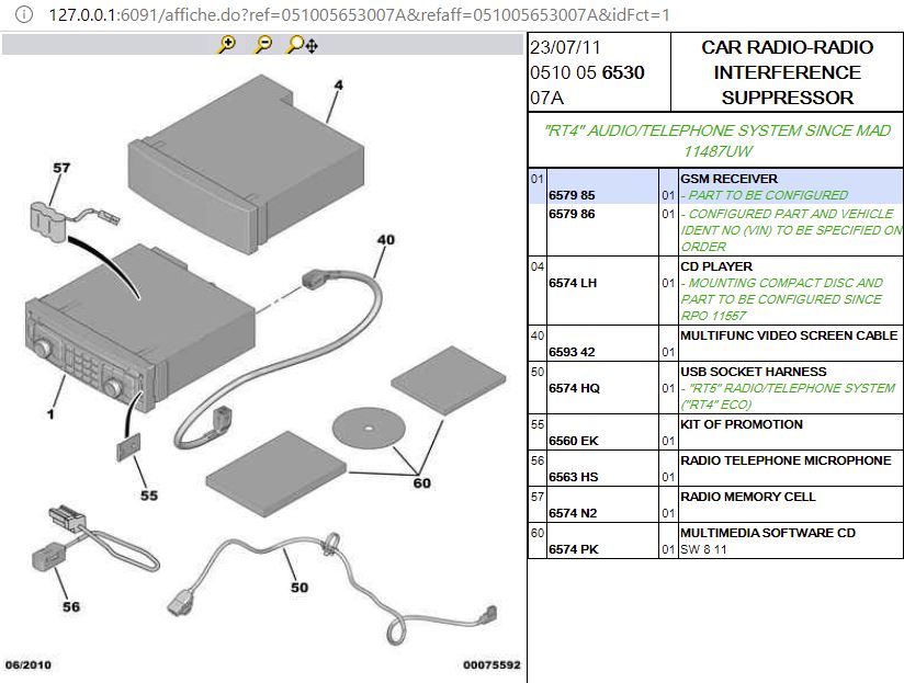

Since I do not have the VIN of the donner C4 I wonder what else is needed but the LCD , RT4 and the associated harnesses. Looking at Citroen Doc Backup It seems there are two options
One without amplifier
and one with amplifier item 25 in the following picture. Is the MULTIMEDIA SOFTWARE CD ( item 60 in the picture ) is essential ?
Is there anyway to know what is needed in order to grant that the RT4 and LCD will function on my C4

You will need the correct electrical harnesses, GPS aerials, GSM Aerials, Microphone (forget the one in the roof - that is integrated) and you will need it configuring to your vehicle's VIN and all the additional features that you have.
The CD is just the System operating firmware.

You are just showing parts diagrams - these are spare part numbers - it is not what is delivered with the system, that is for the dealers to order the correct firmware CD if needed or other replacement parts - you mustn't read this as a retail consumer - it is dealer information.
