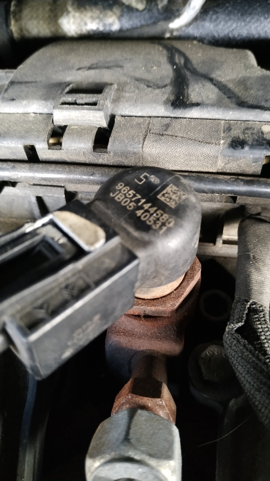

Here's a pic of the top of one of the injectors.

As I said in my first post - 20 characters....or it would seem 19 in that picture for the DW10BTED4 system, which has a Delphi Injection system. I've just provided you with the same info the dealer would use.
If you pop your VIN up I will double check against your engine to be sure.

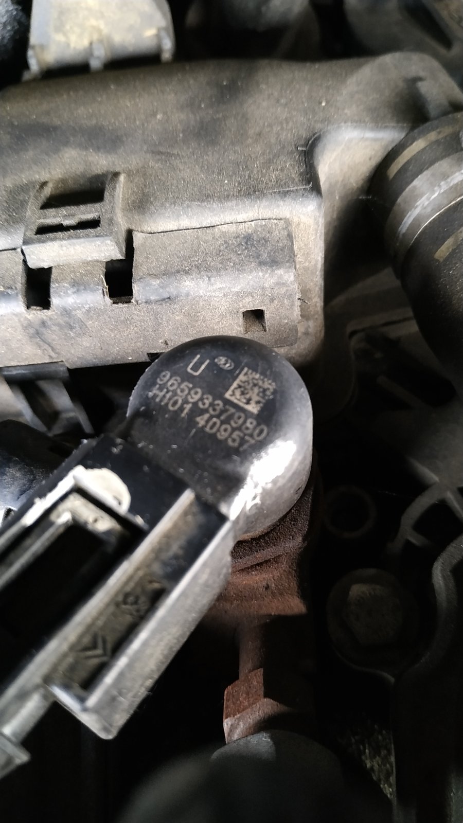

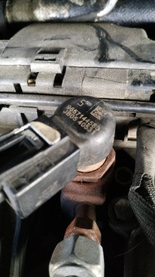

The only number that's different is the last 5 digits, the top row of numbers is the part number of the injector. The "JB05" corresponds with the single number 5 on the top left, denoting that they're a series 5 injector, which is the important part as some used series 4, 5 or 6 and these numbers need to match up.GiveMeABreak wrote: 22 May 2021, 23:48 As I said in my first post - 20 characters....or it would seem 19 in that picture for the DW10BTED4 system, which has a Delphi Injection system. I've just provided you with the same info the dealer would use.
Injector 4 is the only one with different numbers so I can only assume either that one, or the other three were changed at some point. This is injector 4 which is the anomaly.
