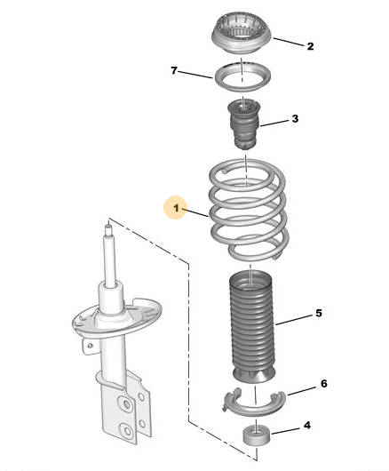

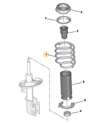

Springs of course, must be replaced in pairs.
There are several options that could of been fitted to your vehicle, and were generally colour marked, but I think these are the standard ones:
Front Springs Part: 9801945480 (Orange, White & Blue marking) £135.96 each

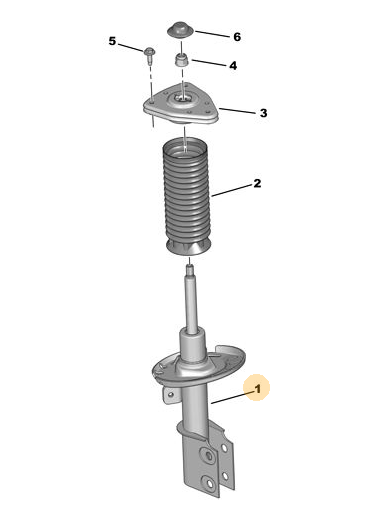

Struts OEM Original Front Shock Absorber part: 1628564280 which must also have the bumper spacer below! £102.53 Each.
Bumper Spacer (required) 9800965480, 0.69p each.
Or there are Cheaper ones supplied by Citroen, part: 1635532480 at: £111.22 each.
The mounting bracket (3) is: 9800479780, £56.80 each
All prices inc. VAT correct at time of posting from Citroen.
Any other part you think you'll need from the above, shout.
