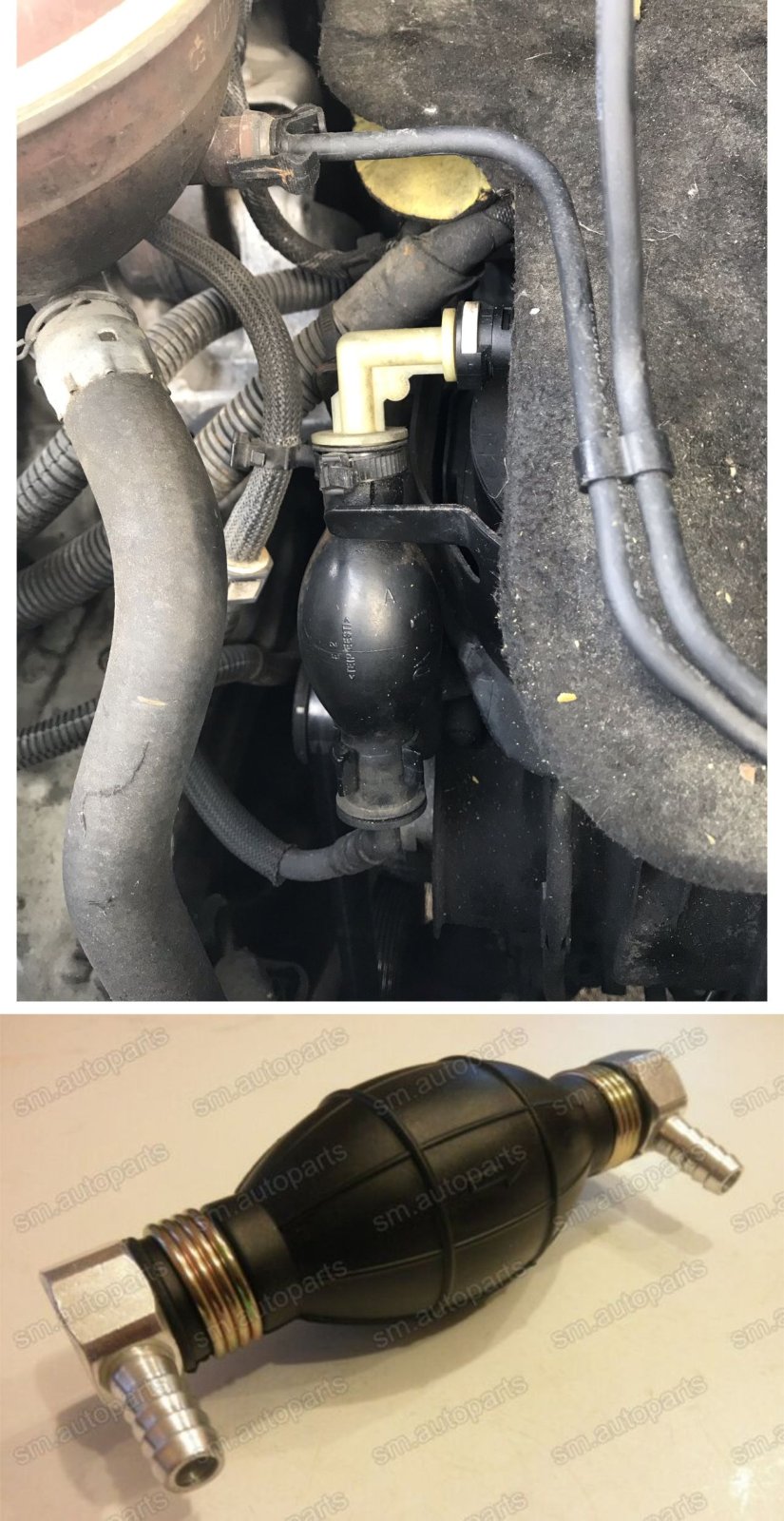

Hi,
The rubber bulb in the fuel pipeline is weeping and I'm looking for a replacement to suit a 2008 - 2.0hdi Dispatch van
Main dealers apparently only sell the complete works, bulb and fuel lines at a hefty £157, yet bulbs are available for a tenner on Ebay and i've also found a couple in breakers yards BUT, none are exactly as the one currently fitted?
The bulbs look pretty much the same but the fittings either end are straight, not at right angles, (most are straight) are metal and not plastic, have additional pipe attached from the bulb to the fitting. Does this matter, providing the fuel lines attach ok? It looks like a fairly straightforward job but are the bulbs different.

I have a different part number Chris? The Citroen bulb with all fuel pipes is pt no: 1574CN
On Ebay a part which as I say is close to but not exactly the same for the bulb only is given as 1574.63. From what I can tell this may just be the difference between straight end fittings or angled.
Here's what I've got, with the Ebay offering below.........and I can't immediately see how they are compatible?

Yes, but is either bulb compatible with the existing connections?
The bottom one looks to be a straightforward connection to the tube, but does the right angled top fitting simply replace that shown in plastic on the existing unit?

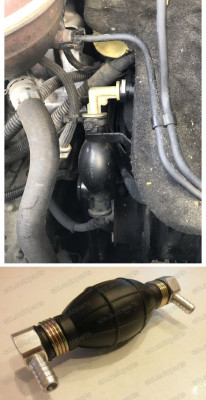

x 1751
Re: Dispatch Primer Bulbs?
The two primer bulbs on Mister Auto, equivalent to 1579 73, both have "straight" hose connections.
- MaxGear 43-0159 (a picture on there)
- Delphi 9001-088A (found pictures on the web).
For all of these, looks as if you could just unfaster the securing clips, and transfer across your angled connectors, one of which looks like some kind of snap-in fixing. Worth a punt.

Well, at least it's right-angle, but not sure of the diameter of the hose connections. You might have to just measure them before ordering.
Try it; you should always be able to unclip and use your original couplings, if necessary.
Bulbs look to be all the same - just the hose size that there's a choice of.
