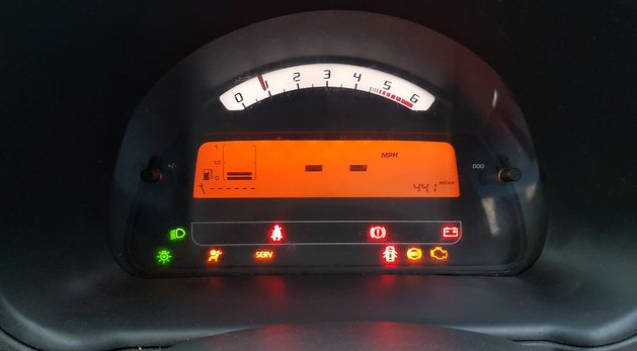

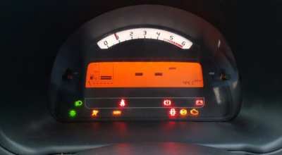

The centre console computer states that the electrical circuit, abs system, antipollution, airbag, seatbelt, and braking system is faulty. On the driver dashboard, the battery light, check engine light, ABS light, airbag, and engine service light is on. Speedometer doesn't work, and the mileage has been clocked (96k displayed, 155k is the real mileage)
Lights, electric windows, etc. work fine.

Now, I'd read on an old C2 forum (that seems to be dead with activity) that it's possible this could simply be resolved (or at least the major issues) by replacing the ABS ECU. Is this correct?
If anyone can provide any advice to what I mentioned above regarding the ECU, if it's worth trying; or whether it should be scrapped outright, please let me know your thoughts.

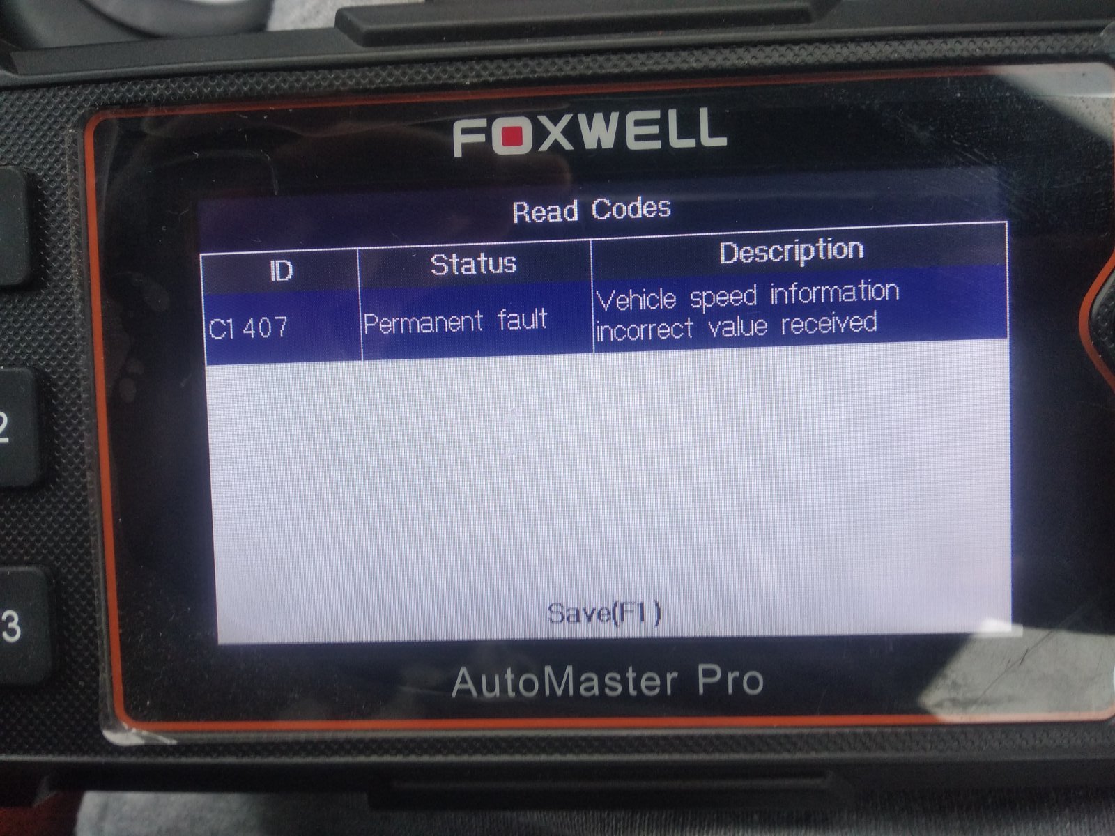

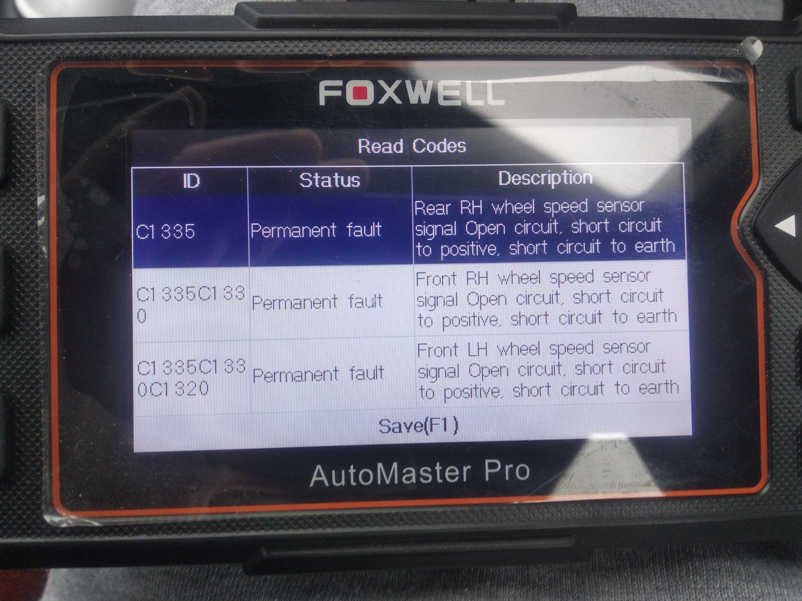

I have exactly this problem my car Citroen c2 1.6 vtr petrol. I can't not found problem. I chege abs sensor.
Abs pump and not resolved.
x 6945
Re: 09 Citroen C2 1.4 Electrical Issues
What makes you think this is the same problem? There is no ABS warning displayed, so unlikely to be this. I suggest you get it diagnosed, find the fault codes and pop them up here, then we may be of some help.

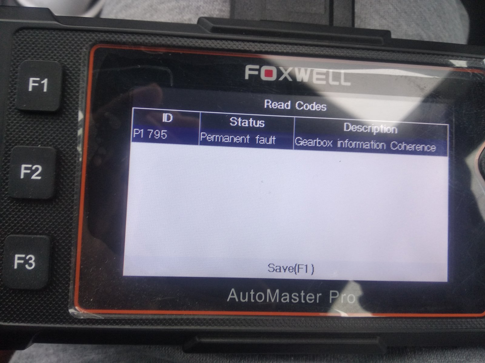

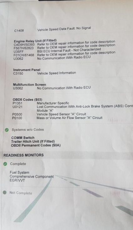

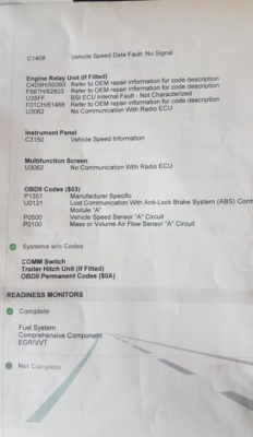

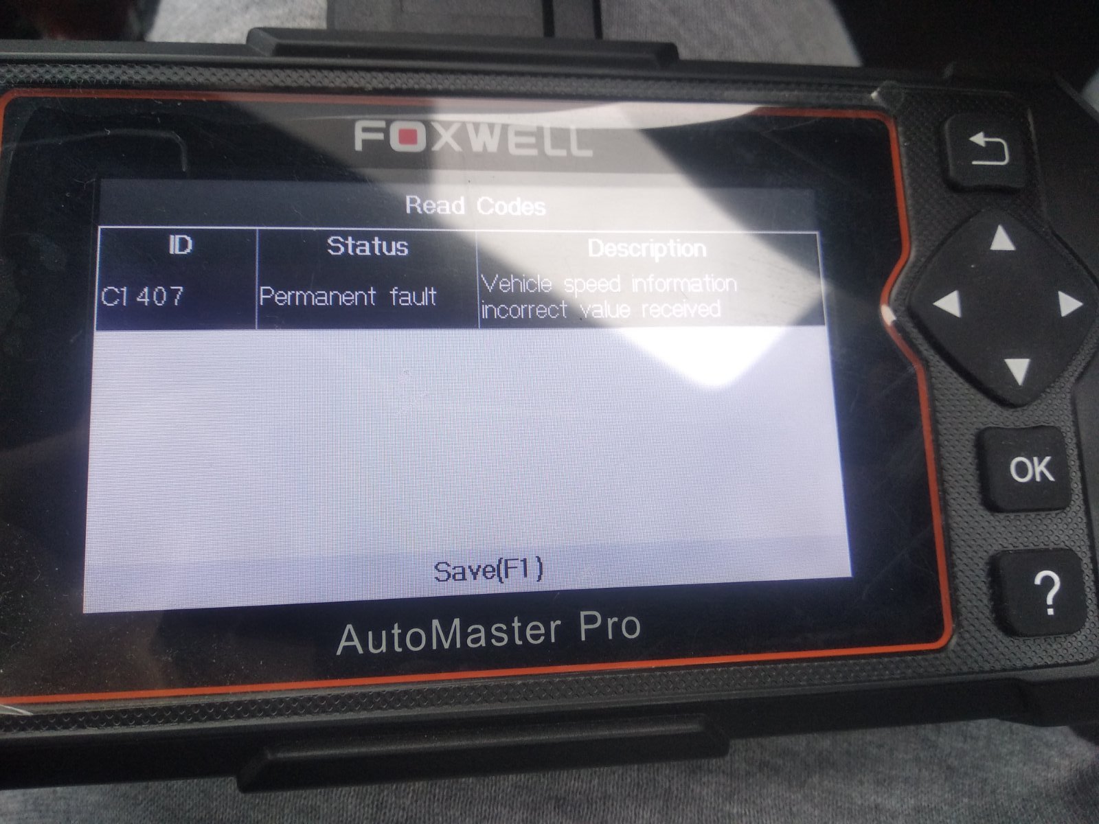

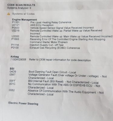

Not see abs sensor .
Incorrect speed value

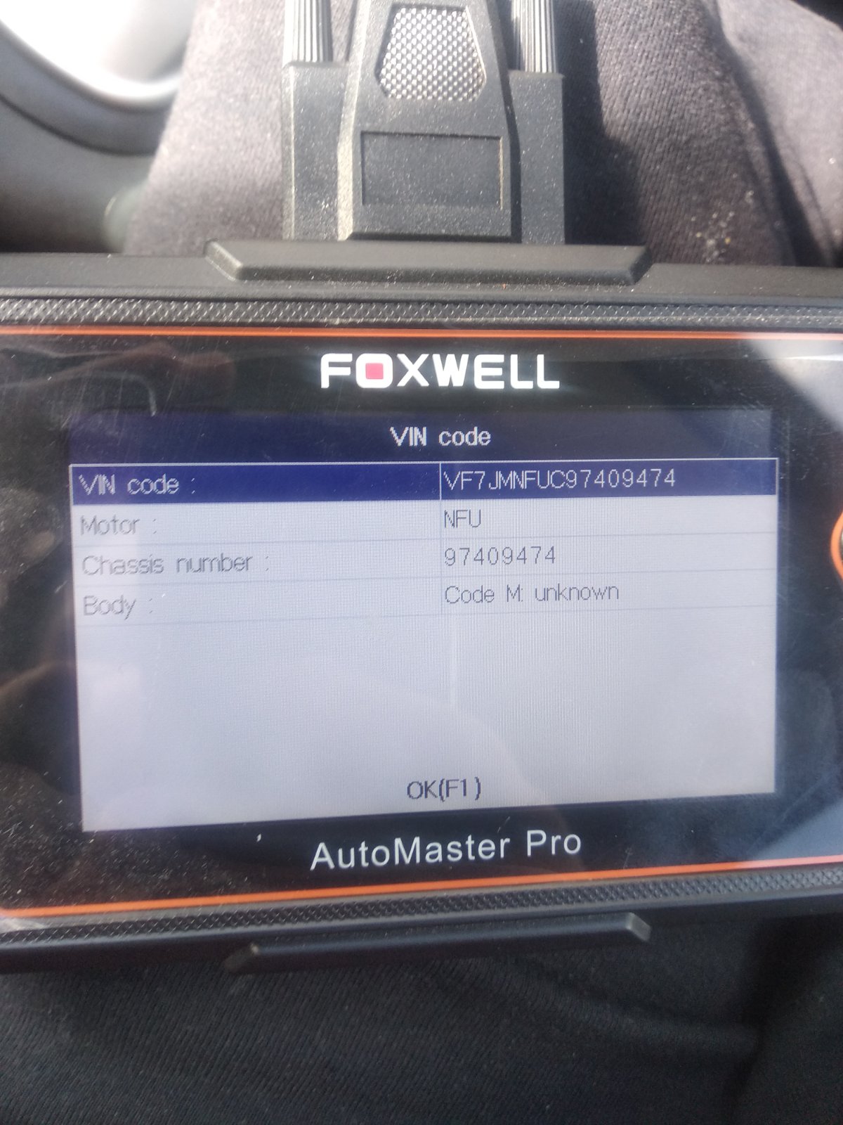

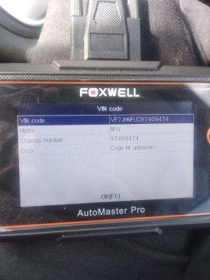

Ok, that's a bit better now we have some codes. Pop your VIN up for us (automatically masked on post submission) so we can relate the codes to the correct engine management system, and I'll have a look.

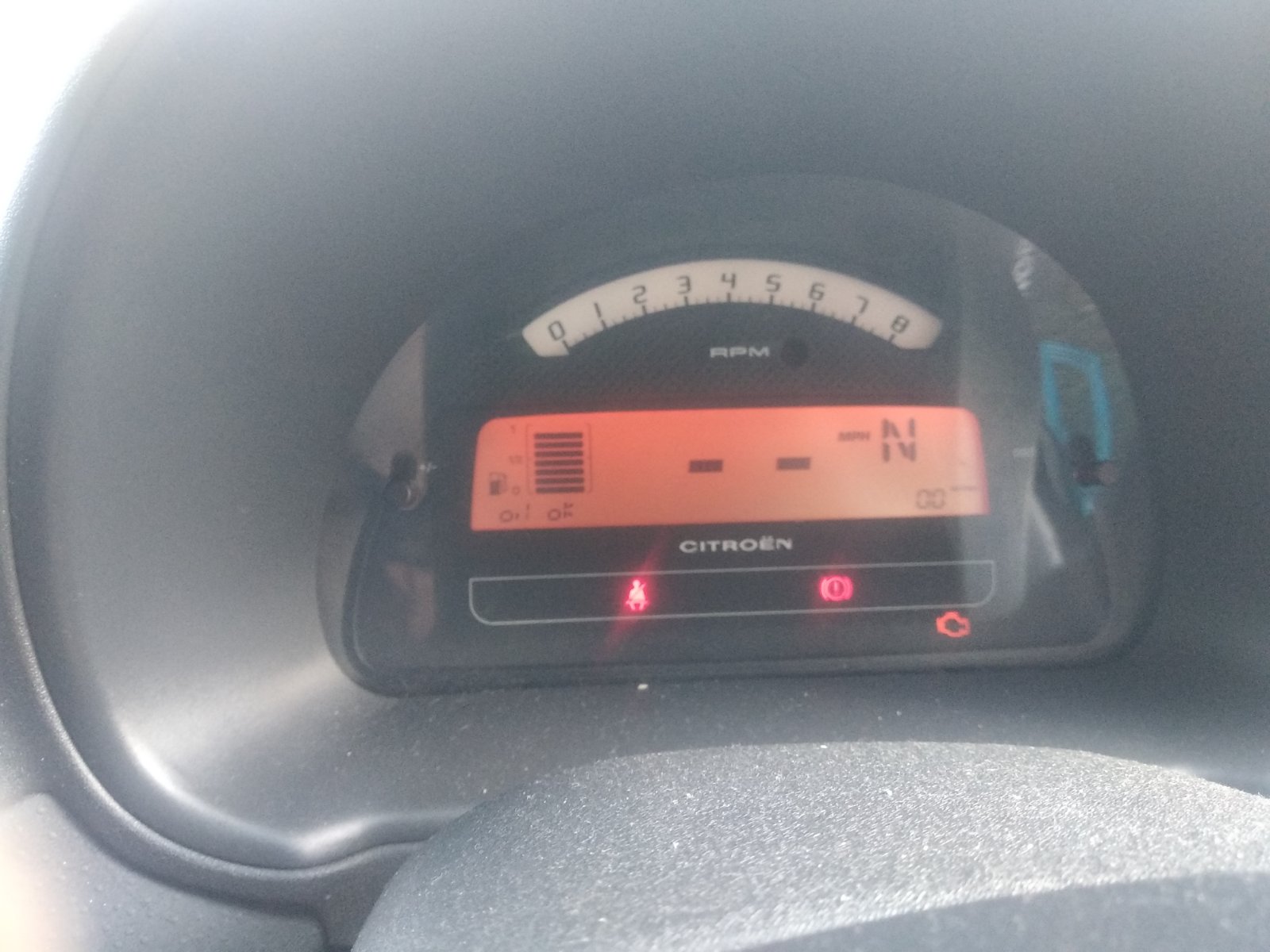

So . First chenge gearbox after work perfect.
Second my stuck both back rear cliper . I chenge new clipers and brake pads work perfect, just I drive 200 miles. after start this problems.

VIN CODE.

GiveMeABreak wrote: 13 Feb 2022, 16:29 Ok, that's a bit better now we have some codes. Pop your VIN up for us (automatically masked on post submission) so we can relate the codes to the correct engine management system, and I'll have a look.
x 6945

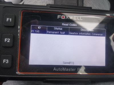

The main P1795 fault refers to the Gearbox Actuator I think - according to this info it has reached over a million engagement / disengagement cycles. So will need some attention I suspect including a possible replacement of the gear engagement actuator by somebody that knows these piloted systems.
Fault Code: P1795
Description of Fault: Gearbox counter information: Coherence. The number of engagements and disengagements of gears has exceeded 1000000 cycles.
Conditions for Fault to clear: Following replacement of the gear engagement actuator.
Downgrade Modes whilst Fault is active:
Symptoms: -
Suspect Areas:
  • Gear engagement actuator
  • Piloted manual gearbox ECU
