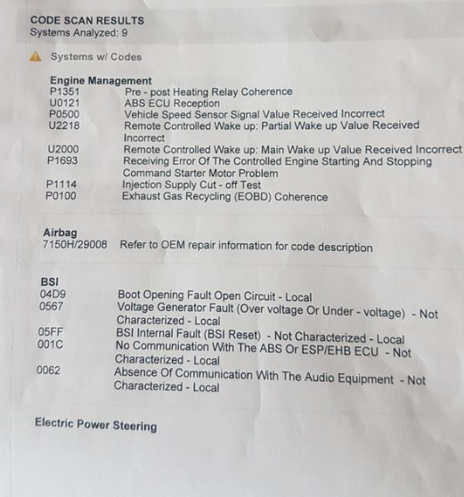

What makes you think this is the same problem? There is no ABS warning displayed, so unlikely to be this. I suggest you get it diagnosed, find the fault codes and pop them up here, then we may be of some help.

Not see abs sensor .
Incorrect speed value

Ok, that's a bit better now we have some codes. Pop your VIN up for us (automatically masked on post submission) so we can relate the codes to the correct engine management system, and I'll have a look.

The main P1795 fault refers to the Gearbox Actuator I think - according to this info it has reached over a million engagement / disengagement cycles. So will need some attention I suspect including a possible replacement of the gear engagement actuator by somebody that knows these piloted systems.
Fault Code: | P1795 |
Description of Fault: | Gearbox counter information: Coherence. The number of engagements and disengagements of gears has exceeded 1000000 cycles. |
Conditions for Fault to clear: | Following replacement of the gear engagement actuator. |
Downgrade Modes whilst Fault is active: | |
Symptoms: | - |
Suspect Areas: |
