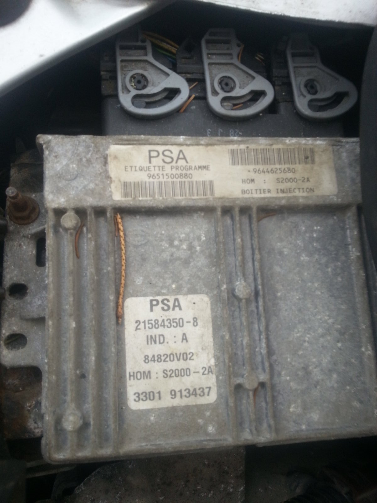

Hi, can you take and post some pics of your ECU?

Hope this works, having a few phone issues at the moment

Thank you! That's more than enough. It's a SAGEM S2000-2A. They're a pita to work on as they're completely potted inside with white silicone. As for the wiring diagrams, I'm sure that some of the forum admins will be able to sort them out, as they'll have access to the complete VIN number. Be aware though, that usually, in the automotive world, due to the complicacy of the electronics and their circuitry, wiring diagrams are divided in areas. You'll find the diagram for the injection circuit, for the aircon, for the ignition/cranking and so on. It's difficult to find a diagram of all the connections on the ECU, as it would actually be a diagram of almost the entire vehicle. Why do you need it? If you explain us the problem we may be able to help you better.
