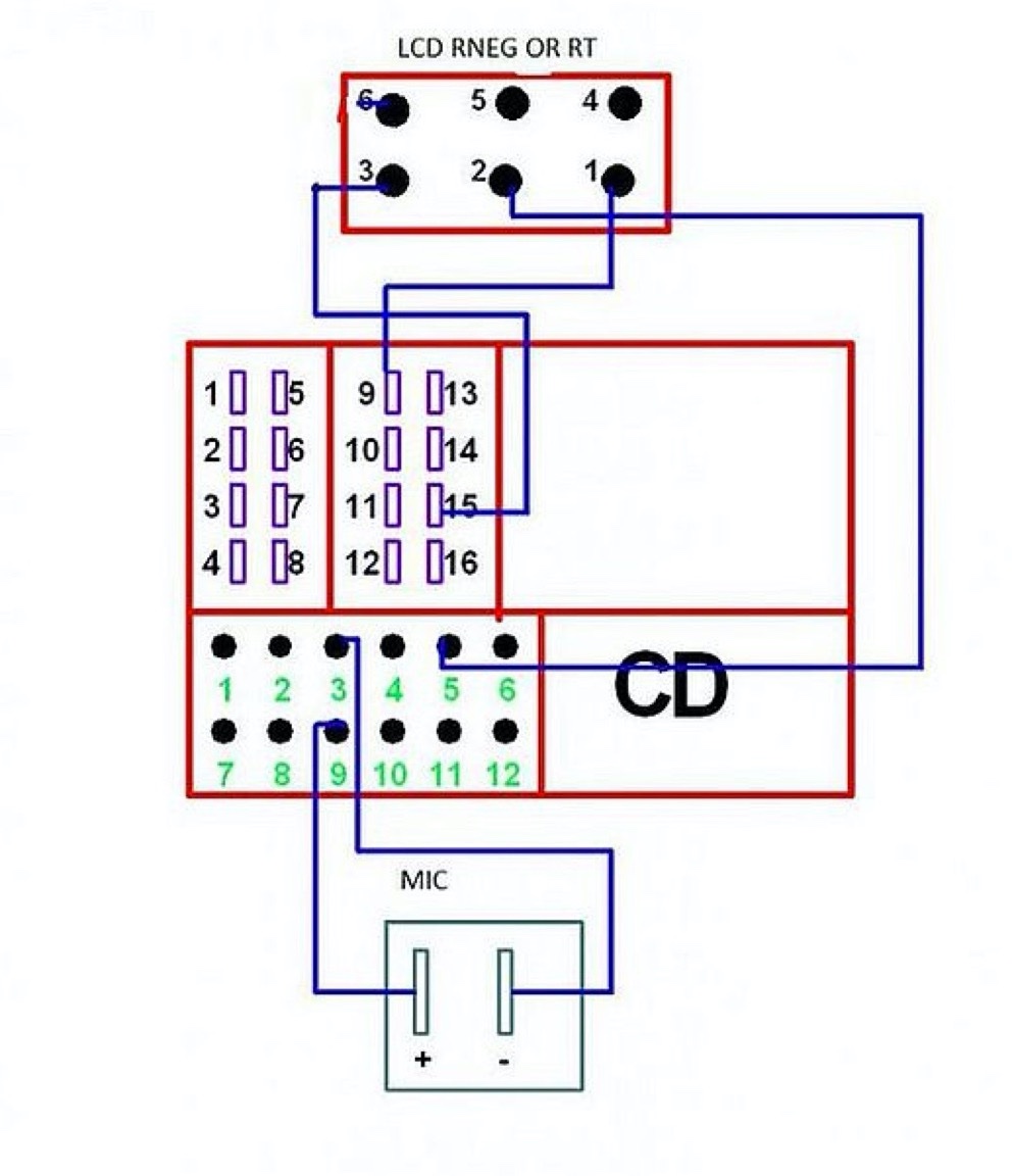

You can adapt the existing wires to the RT6 ones.John 6200 wrote: 24 Apr 2021, 23:59 Hi All I have recently purchased a 2012 Citroen c5 exclusive with the RD4/RD5 unit! My previous 2009 exclusive had the RT6/WIP+ with the lager screen! What I wanted to know is if I could change the RD4 unit and put in the RT6 one with the bigger screen if I came across from another C5 ! Thank you
Actually, you only need to take (hard-wire) live feed, ground and backlight from the Quadlock connector to the big navi display and hook up 2 wires from microphone as well.
I did similar to what you want with my previous P407. It was an upgrade from RD4 to RNEG. The same will work with RD4/5 to RT6 in your C5 X7 as the ports/connectors on RNEG and RT6 (RNEG2) are the same.
What you need is:
RT6 from another C5 X7 (will need telecoding to your VIN using Lexia)
A matching 7" display for RT6 with LWDS cable
Facelift display fascia (panel) around the (big) screen
Generic car GPS antenna with FAKRA connector (10€)
Generic car microphone (5€)
a little bit of wires tweaking (5 wires in total)...
PS: if the screen comes without the power plug you can connect it with Dupont wires (that's what I did).
Tutorial you can find here (sadly, no pictures anymore): viewtopic.php?t=48421
