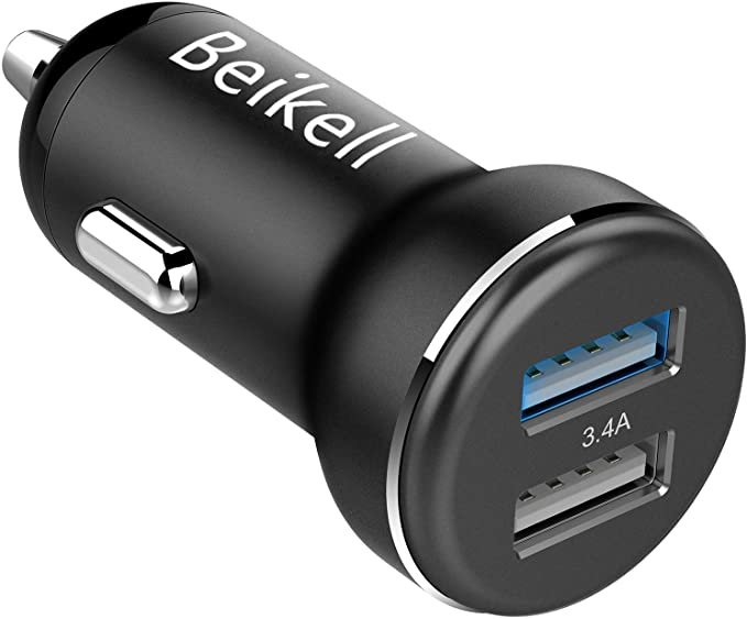

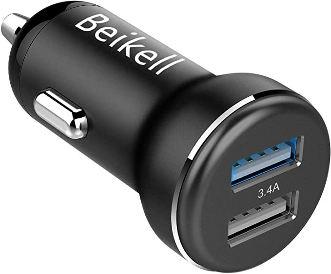

A bodge but maybe a USB adaptor plugged in to the fag lighter - or similar socket - would work.
My Garmin does just that. I do have a USB outlet but that connects my dongle to the radio.
Like this:

Ah, that's what the thing is for. I have one somewhere in my garage and I do remember that it was used for exactly that.myglaren wrote: 17 Apr 2021, 19:33 A bodge but maybe a USB adaptor plugged in to the fag lighter - or similar socket - would work.
Like this:
Thanks for refreshing my memory
