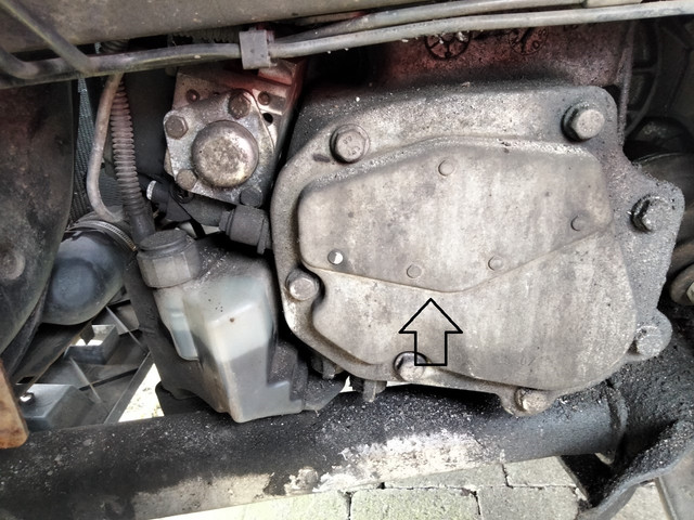

Now i have another and hopefully not more seriously problem. But i shorted it the car was selecting A1, 1, R, N and it was staying put in these although the car was not firing. Since i got it started it is selecting A1, 1, R for a spilt second and then going back to neutral. I hope i did not fry something electrically.
Trying to error check a few things.
*Fuses OK
*Selector i think is OK because it changes from N to A1,1,R but then it reverts back to neutral
*Checked actuator fluid levels and this area seems fine (see below pic) no leaks or nothing
So basically i now have no clue why it is not selecting gear
When i have someone move gear selector when car not running I hear sometimes squealing type noise from where arrow is. Same when running and move in the liquid in the tank.
It seems like there is some movement there like it is getting the signal from the selector.
Completely out of ideas on this
*Fuses OK
