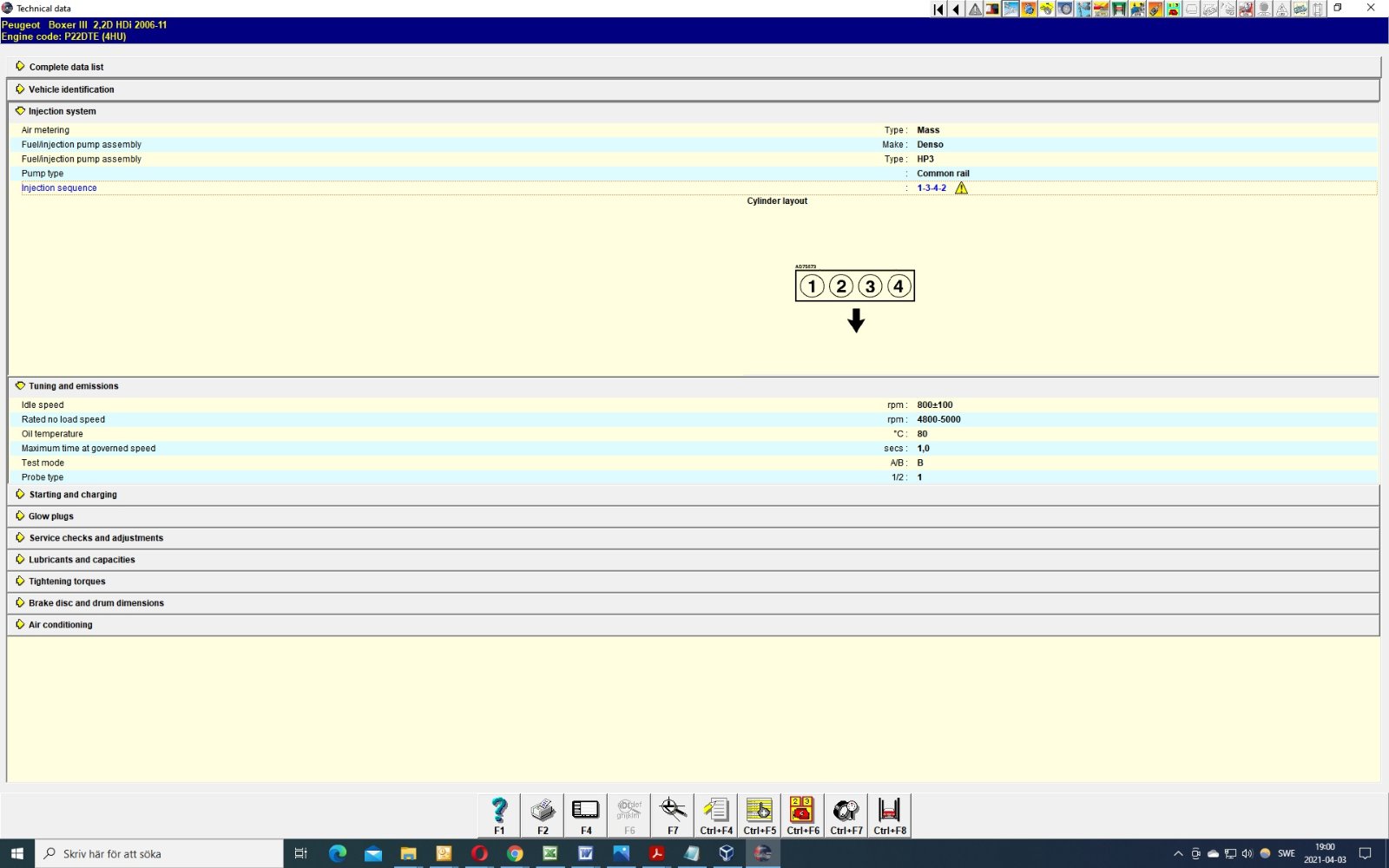

Found the firing order in my old Autodata:
