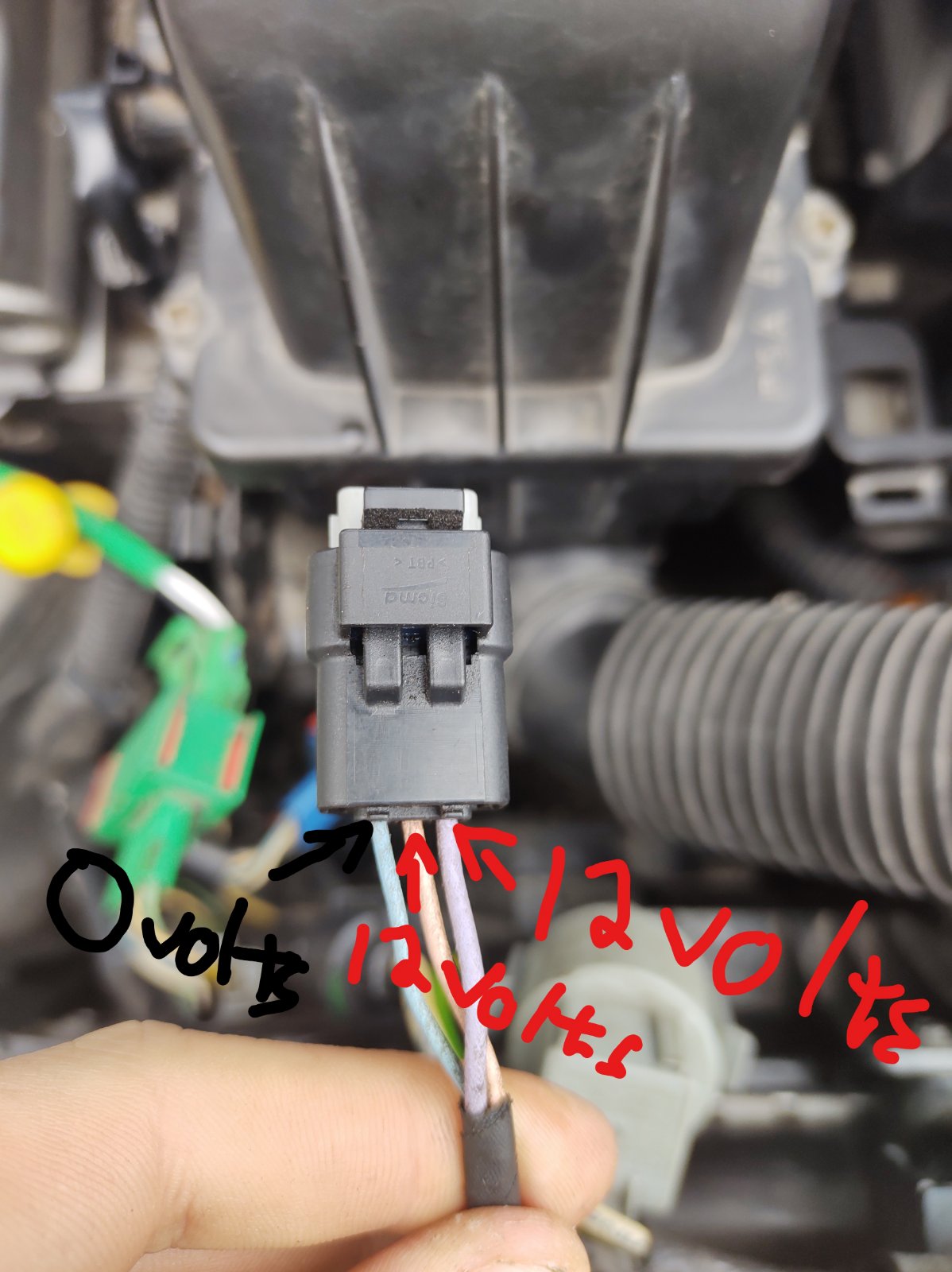

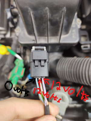

Indeed I do have AC in my C2. I checked the voltage on the light purple wire and it is showing 12 volts.
So my best shot at fixing this issue would be to replace the cooling fan?

Unfortunately, it looks like yes.TomMar wrote: 05 Apr 2021, 16:33 So my best shot at fixing this issue would be to replace the cooling fan?
A small consolation is that the fan is typically only used for the air conditioning. I live in Australia and even in the middle of summer where the temperatures average 35'C the cooling fan rarely comes on. The 1.4 engine uses the same radiator as the 1.6 and so has very good cooling. In fact, if you check out some of the forums, the 1.4 (TU3JP engine, C2,C3,Berlingo) owners complain that their fans are broken because the fans don't run! When it's just that the cooling is very efficient.
The entire fan and shroud is available as a replacement part. It includes the wiring loom and relay in the shroud. Be careful of the black power connector, I think this might vary from model to model.
