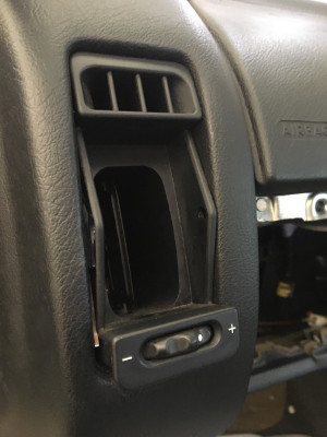

This is an example of my frustration and I suppose it comes with experience.
I was hoping to get dash fully built back up today and I am nearly there.

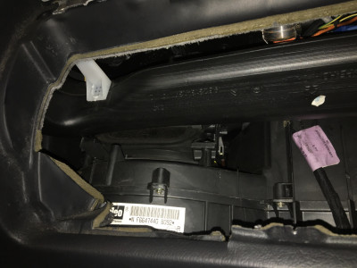

However, I am trying to locate the air vent extension tube behind the glovebox. I’ve got it located but I tried to remove the side vent itself and have only so far. I don’t want to break anything.
Got it so far out but now cannot get it back in!
And there is a white plastic brace on the tube which is supposed to locate and perhaps screw? onto the rear of the dash.
Any ideas guys?
The beauty is it will be much easier the second time around...
Air vent behind and adjacent Xantia HDi glovebox.

From memory i think to get it out fully you need to squeeze both sides or lever it out.
If you look you can see the locating lug hole on the inside of the vent.
I think the plastic bit is part of the vent mechanism so need to get it out fully before you can get it back in

I think I've gone beyond that Colin.admiral51 wrote: 14 Mar 2021, 15:17 From memory i think to get it out fully you need to squeeze both sides or lever it out.
I can't even thump it back in and, believe me, I am trying hard! It just seems stuck.
