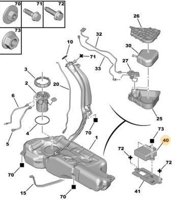

According to your vehicle's specifications as it rolled out the factory, your vehicle does have the EAS additional additive ECU (May be either an EAS 200 or 300) - but I suspect your diagnostic tool may not see it.
We do recommend a Lexia with Diagbox as it can talk to all the ECUs, but it is supposed to be there:
As you can see, it is item 40 on the diagram.....
You should have a Bosch EDC16C34 engine ECU on your vehicle.
There is also the possibility that this was on the cusp of the changeover to Engine ECU Control - for this year, so they may have incorporated that function within the Engine ECU but left it on the diagram for earlier years...
