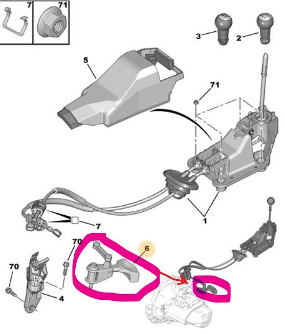

Should look something like this

Regarding No 6 how does the piece come off ? My first gear is stiff ok when warmed up , might try lubricate first. My car differs as it is citroen c3 picasso but i think might be similar

Huskyxantia wrote: 04 Feb 2024, 19:37 Regarding No 6 how does the piece come off ? My first gear is stiff ok when warmed up , might try lubricate first. My car differs as it is citroen c3 picasso but i think might be similar
I'd be interested to know this too as I'd never describe my Picasso as having a particularly slick shift...

Doesn't look like that bit is fitted on the C3 Picasso
