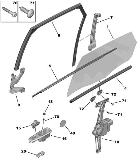

Our driver's side rear door had an issue during the icy weather and it seems the cable has snapped. I am pretty sure the motor is still working as I can hear it clicking, but the non-manufacturer mechanism replacements don't look great and aren't exactly cheap either.
I was hoping you could provide a part number for this, so I can source the part myself? I think I have it narrowed down to 9676172380 but I am not confident enough in my detective abilities!

As for your rear windows, these are different to the fronts.
Item (10) is the electronic lifter and there doesn't seem to be a part for the wiring alone unlike the front windows where you can buy the wire and frame/ The rears seem to be a complete unit:
Item (10) has 2 part numbers - the old part: 9676172480 £328.56 inc. VAT
and the later replacement part number: 982607658 £379.70 inc. VAT
All from Citroen.

Is that definitely the off side/drivers rear? The door shape looks like near side/passenger rear and the part number returns results for NS/R in a quick search. I think there might be one digit difference, so I am worried about grabbing the wrong one.

As for the window, there are of course part numbers for left and right rear units and I think I've given you the rear left one earlier.
9676172380 is the original part for the rear right.
9826076480 is the newer replacement part number for the rear right.
