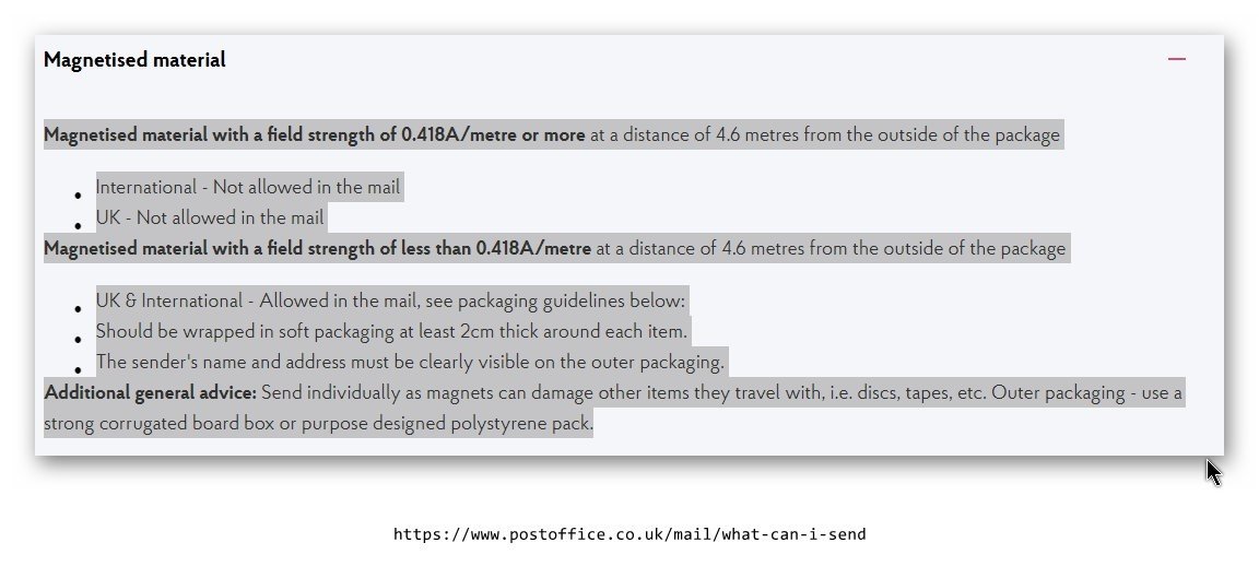

This is what I get on the PO site. The lady at our Post Office is a stickler for the rules so I want to be sure.

Well, that makes sense. If I were to send a magnetic tape to somebody I would not be happy to find it had been damaged in transit because it had been shipped close to a very powerful magnet.

Just make sure you send it in a large enough box so the field strength won't be that high outside the box. If it were me then I'd pack the woofer in a normal sized box that it would have been dispatched in in the first place, then put that box inside another with at least 6" clearance around the inside.

Here's a link to one of the most un-read pages on the Post Office website
https://www.postoffice.co.uk/mail/what-can-i-send

I would start by using a navigation compass, and see how far away it is affected by the speaker. Than you have an idea of how big a box to use.

Generally, in my experience there is little leakage from a well designed and made speaker so it really should not be a problem.
Good speakers do all they can to concentrate the flux where it's needed...
