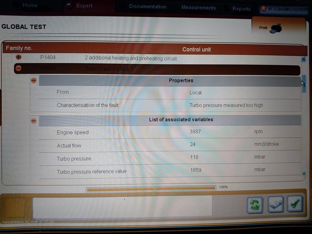

More recently, on longer runs, it has been going into limp mode (like the turbo no-longer blows) and a warning 'Depollution System Faulty' appears on the central console display. If I pull over and shut the engine off, let the canbus re-set (listen for the last relay to click off above the noise of 'Ah dad, why do we have to wait again?' and grumblings from the missus! Re-start and it goes back to normal for a while. It's been doing this for the last few months and I had also been re-setting the permanent DTCs via a cheap KONNWEI KW850 OBDII Diagnostic Scanner... which I now understand is really not the proper tool for the job. Owing to losing my job during the first coronavirus lockdown, my focus has had to be elsewhere - trying to find some income, rather than shelling it out on the old beast.
The good news is that after a bit of O/S sill fabrication and welding (more on that another time), she did sail through the MoT again and so I'm keen (financially keen too ;-) .. to keep her going for as long as we can.
This is where I'm asking for a bit of help - please!
The engine light is now on permanently and although the car seems to start and drive fairly normally, it would be great if someone could be kind and point me in the right direction with the DTC codes I've now extracted. Must say that Lexia-Diagbox is clearly quite a clever bit of kit, especially when you consider when it must have been compiled. Would love to have my own version of it at some point.
So, here goes - any pointers much appreciated please - thanks in advance.

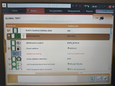

Here is the response from the Global test
BSI Global Test C8
BSI Global Test C8

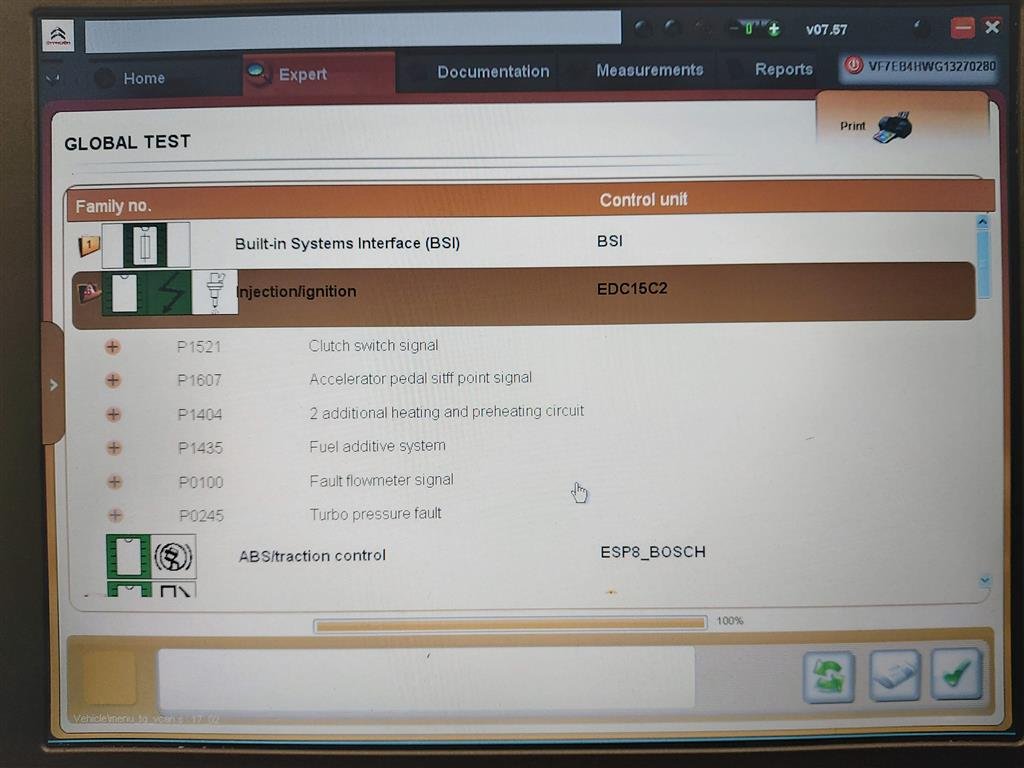

Here are the ignition/injection codes
Injection Fault Codes

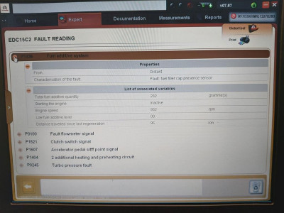

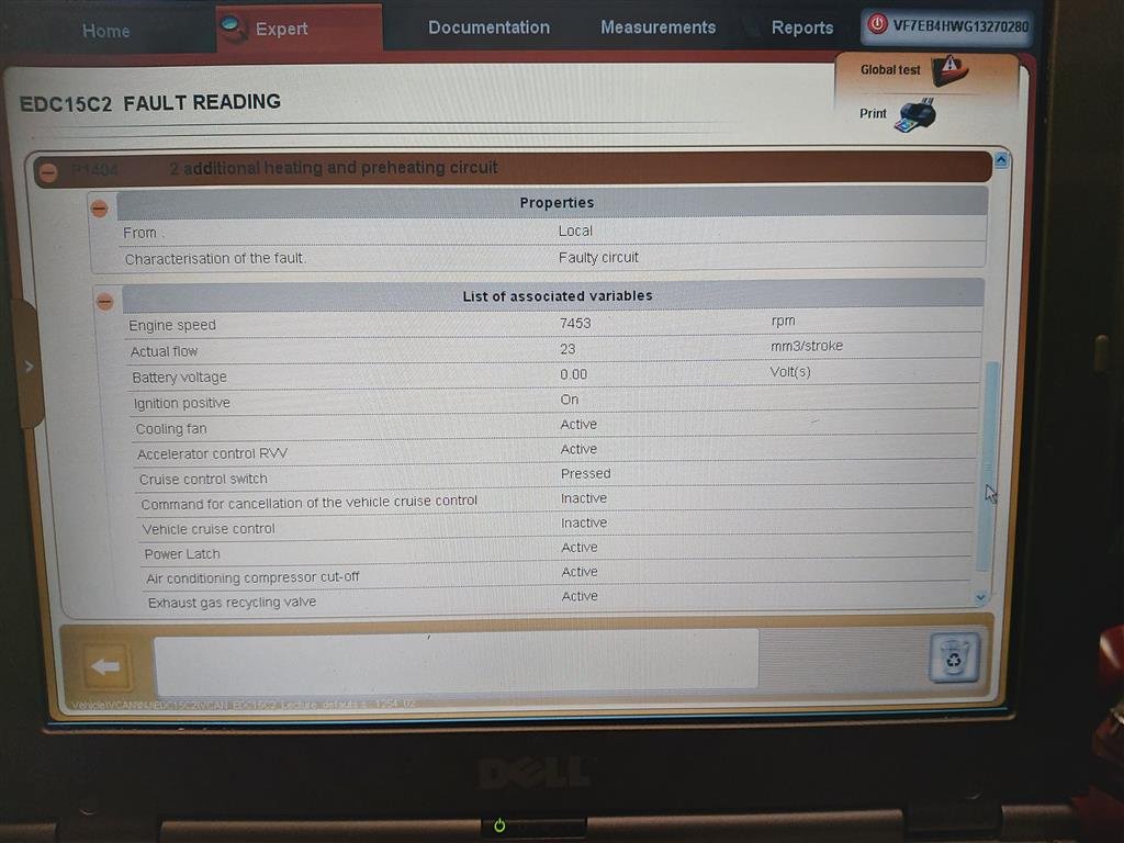

And one that might be driving the Depollution system faulty notification??
P1404 preheating
P1404 preheating

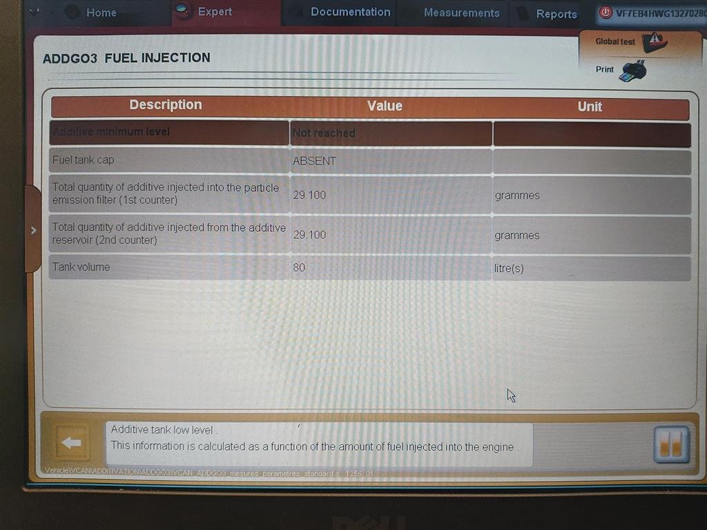

or could it be time to notify the fill (I didn't do this when I filled the eolys tank with more fluid)
ADDGO3 Fuel Injection

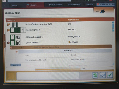

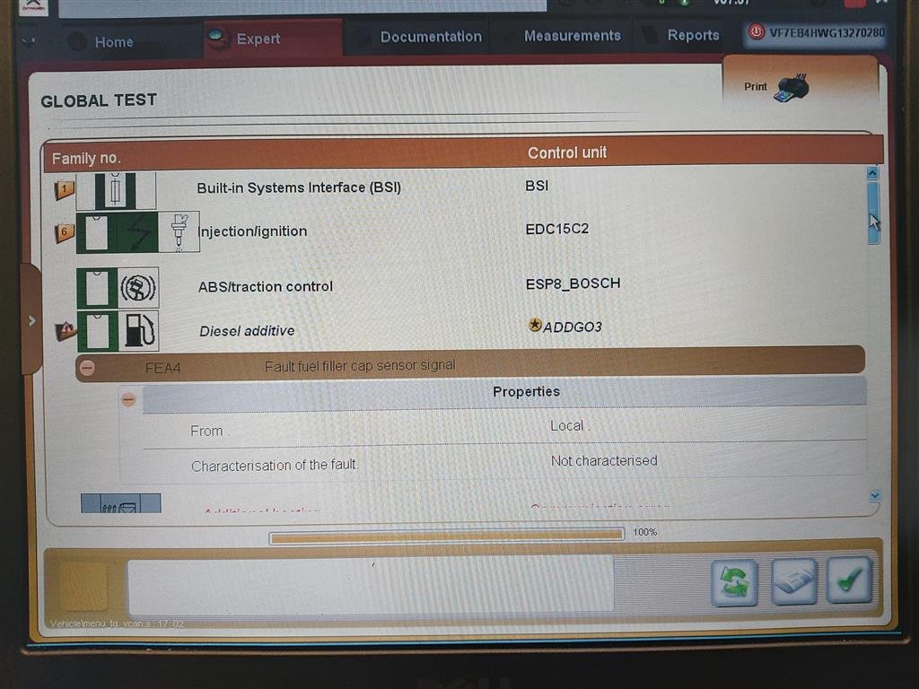

Also seems to have a fuel filler cap sensor - now not reading correctly. Expect it can't work out how many times the tank has been filled as a result. Gather this affects the Eolys dosing.
Diesel Additive - fault with filler cap sensor

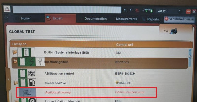

Got a comms error with the cabin heater this winter too - bit of a pain when it is very cold but this is not the priority at the moment, it'll have to wait for now!
Additional cabin heater comms error

Your "additional heating" fault may apply to the Eberspacher diesel heater some times fitted to cold climate models - you may not have it on your vehicle, hence the "fault" :wink:
It warms up the engine only.
On my Xantia it is tucked under the nearside front wheel arch and the exhaust pipe can be seen poking out without too much trouble. HTH
Regards

Thanks for your response! I think most C8s are fitted with the Eberspächer diesel heater - mine certainly is. It's fitted to the underside of the floor, left of the exhaust, in the centre of the vehicle. It used to work a treat, and would fire-up on cold mornings (below 5*C) to heat the coolant quickly and in turn, heat the heater matrix and warm the cabin. The 2.2Hdi engines don't warm up very quickly as they're fairly efficient, so don't waste a lot of the the burnt diesel's heat to the block and coolant. When working, the Eberspächer gives about 3kW of heat almost instantly which is handy when you need to defrost the car quickly. You can usually tell they're running as they sound like a small whirring turbo.
This is the first winter when our heater hasn't worked correctly - clearly it has lost comms with the BSI for some reason. I've also heard that the unit's glow-plug can pack-up, perhaps not surprising after 15 years' service. I haven't looked at it yet as, for me, it's not on the 'critical' list! 'Comfort' list perhaps! For now, I've got to concentrate efforts on understanding and rectifying the other issues first ;-)
Andrew

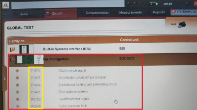

The issues I'd like to understand to start with are the fault codes for the injection section of the BSI report in Lexia - this section;
Fault codes for C8 2.2HDi injection system

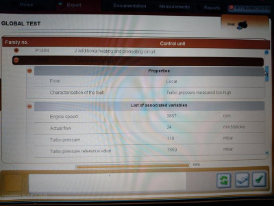

These codes - bold items of particular interest;
P1521 - Clutch switch signal
P1607 - Accelerator pedal stiff point signal
P1404 - 2 additional heating and preheating circuit
P1435 - Fuel additive system
P0100 - Fault flowmeter signal - think I may have cured this one by cleaning the MAF on the intake, it was lightly contaminated with engine oil residue
P0245 - Turbo pressure fault
Is there a manual for these codes that can be referenced somewhere? I've had a bit of a look but can't find anything specific to Citroen.

Yes, I've been through all the '+' signs, expanding each section. The advice provided by Lexia doesn't always expand to include something that would clearly explain the fault code registered. It seems to me that it's one of those systems you need some experience with - and know how the codes relate to the actual faults on the specific vehicle.
Expanding the P1404 - 2 additional heating and preheating circuit + sign just gives this...
P1404 fault code expansion on Lexia (Citroen C8)
'Faulty circuit' doesn't seem that helpful to me - it could be a number of things from the glowplug relay to the glowplugs themselves? Either that or am I missing a trick?
Any input from forum members is very gratefully received - thanks!

I just wonder if anyone has any further thoughts on this fault (or any of the others above) before I try and dive into this again - forewarned is forearmed and all that! ;-)
Is this P1404 'Faulty Circuit' likely to be perhaps on or more failed glowplugs? They look like they're pretty horrendous to get access to so that may prove an interesting challenge. Thankfully it still starts well - even in the -6*C cold snap we had last month.
Thanks in advance

A good crawl around under our aging C8 revealed the fault with the Eberspächer - it was a simple as the main electrical connector had pulled apart slightly! Looked like it was connected but in fact it had separated just enough to lose communication with the BSI. No idea why it came apart like that but now it is working again, I'm happy. Simple things ;-)

Well done. It might be worth spraying some proper contact clean into the plug/socket and then unplug and plug them in a few times. That should deal with any dirt that might have got in.
