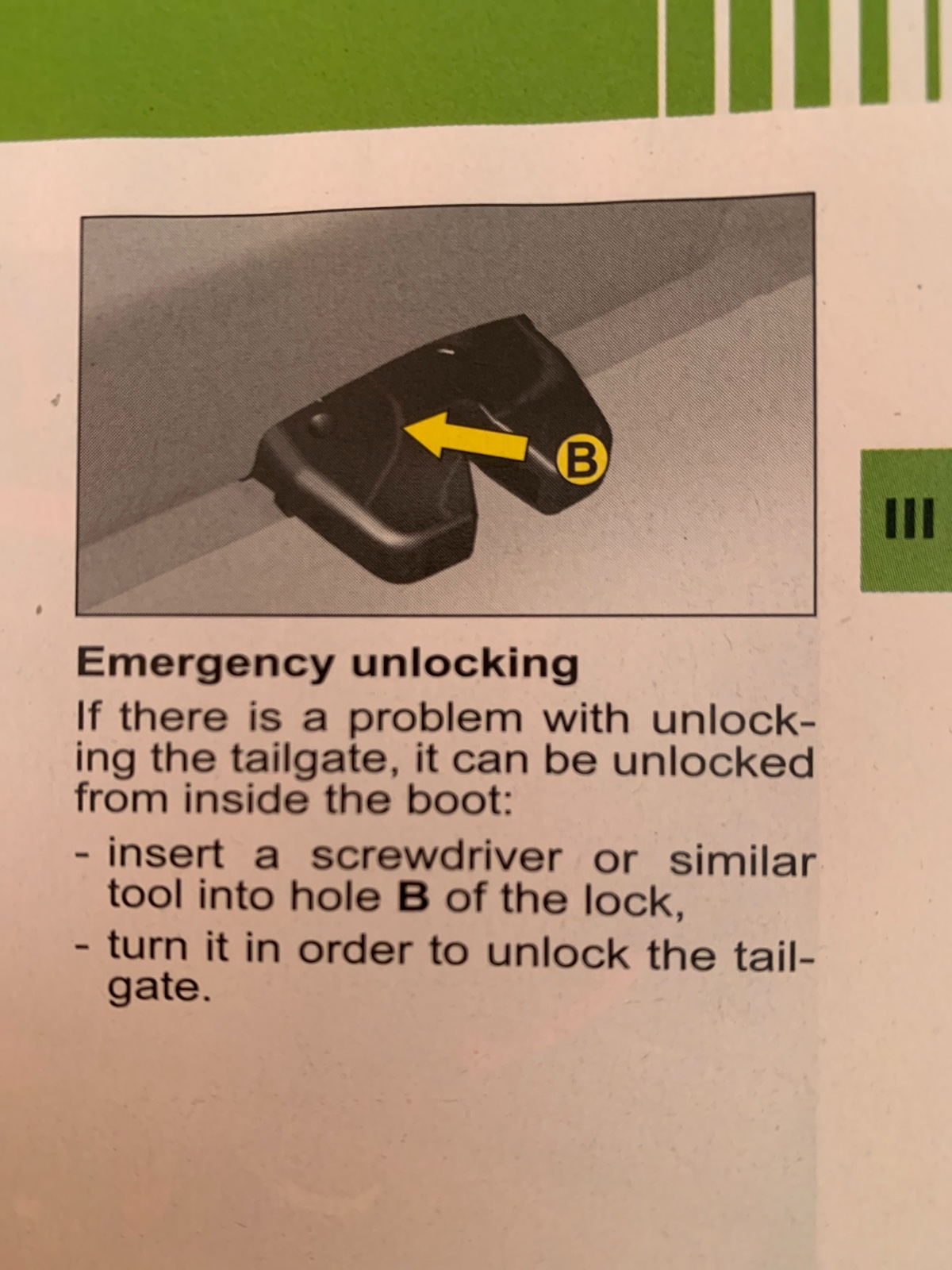

Same applies to bootlid, its electrically operated so wont open from outside if no power, to open it manually from the inside there is a little hole to the top left of the catch where you can insert a small screwdriver & flick it open.

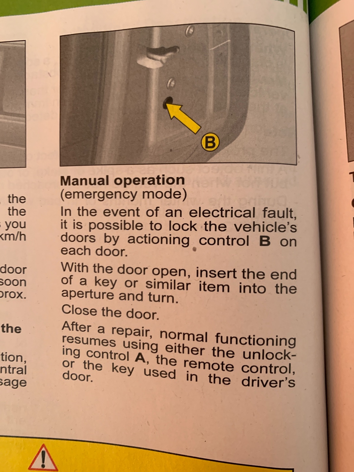

As for the rear doors, cant remember if the Picasso has this but most models have an emergency locking feature on the rear doors. This is for a C4.
