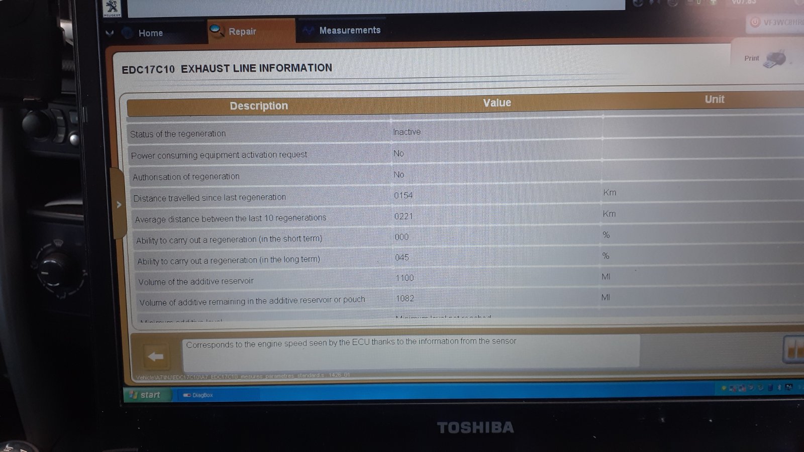

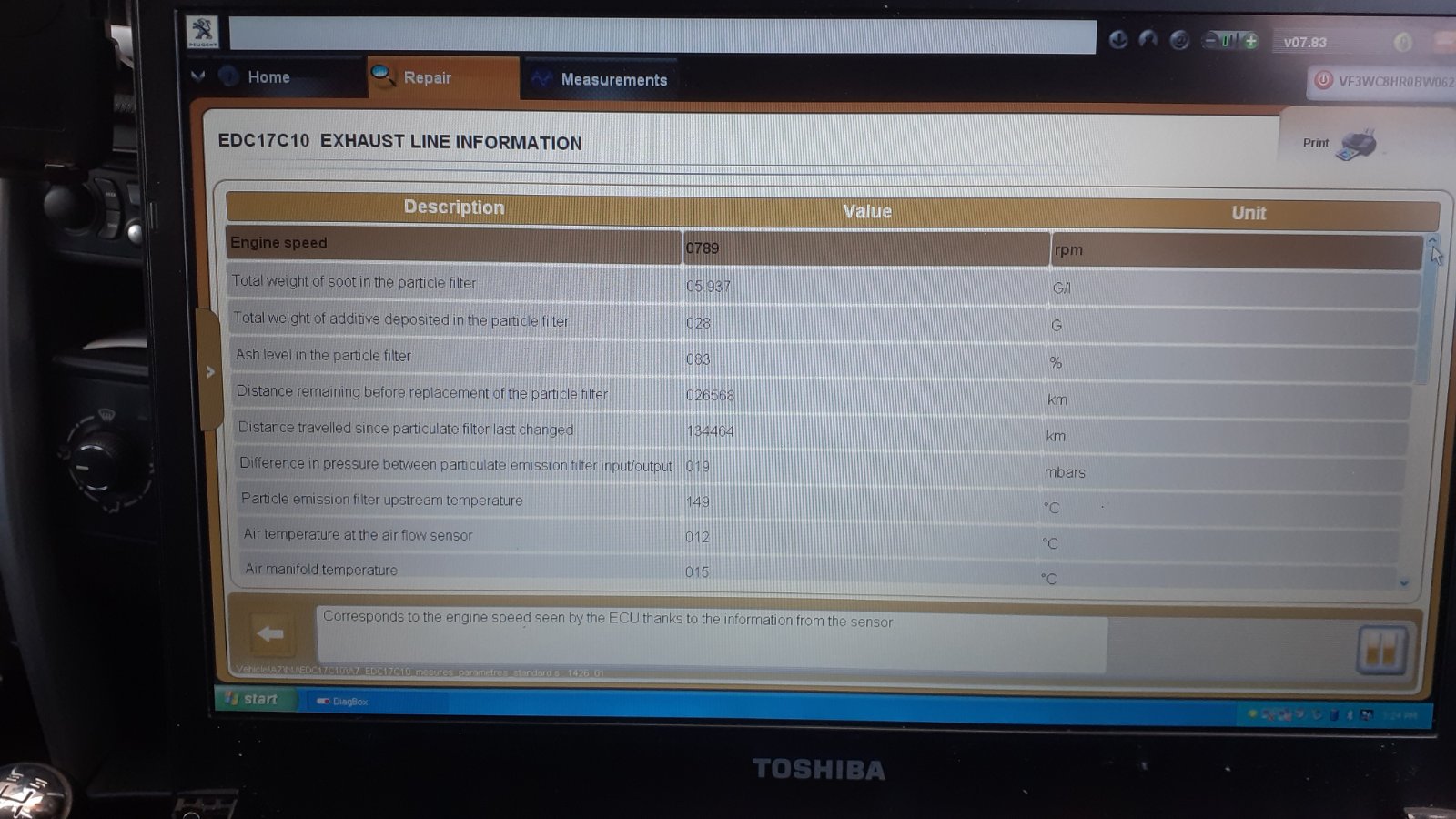

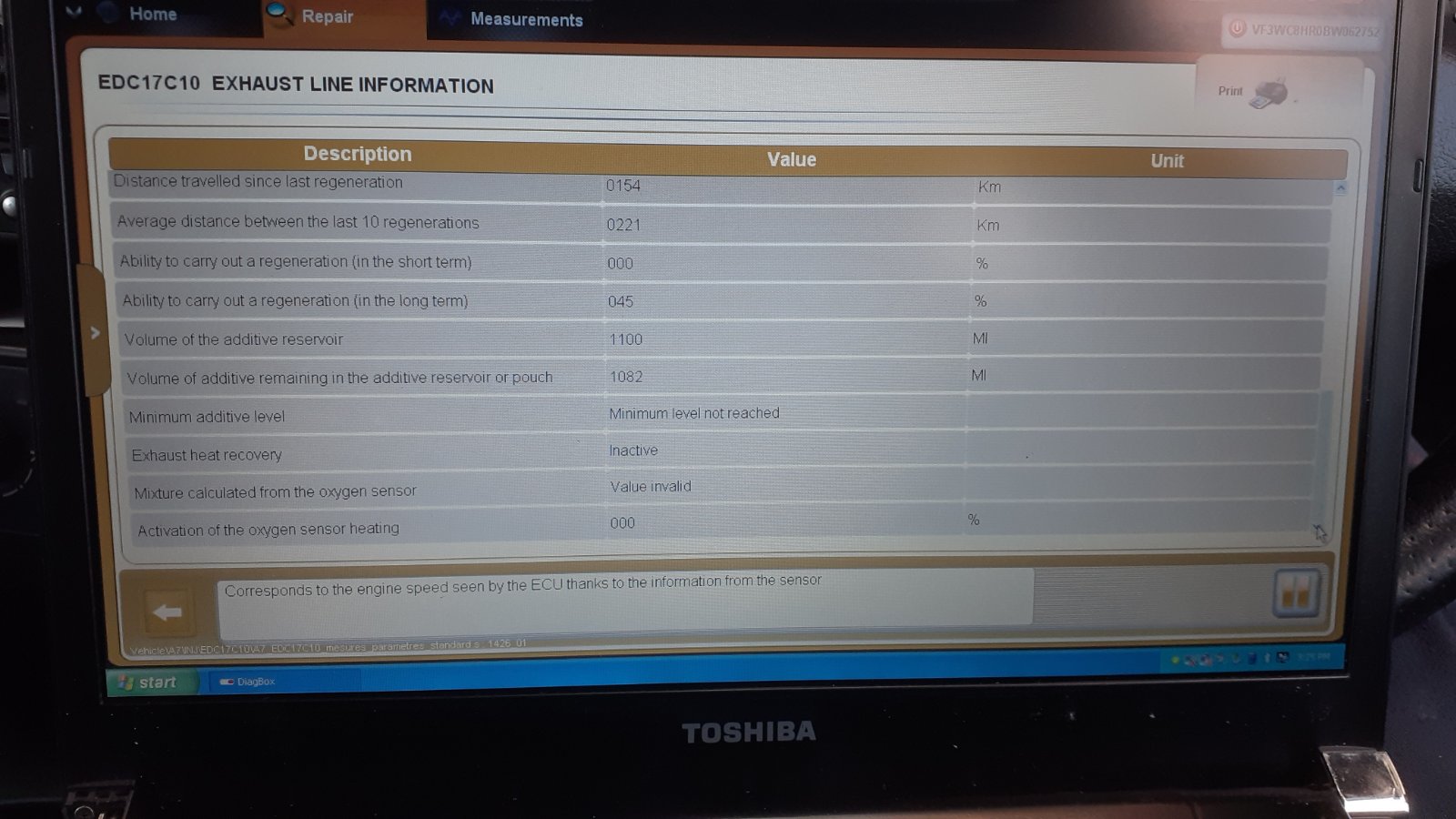

My peugeot 207 1.4 hdi 2011 had fault code P1490 keeps coming up randomly sometimes nothing for weeks and other times 3 or 4 times on a 25 mile run.
I've changed the particle filter fluid under the car my car has a pouch of 1100ml and the scan is just showing short of that.
I have not reset any counters as i am not sure how that is done if someone could talk me through it that would be great.
also I'm hoping someone can explain my scan for me as I've no idea.
Below are some images of the live scan

There's some info on P1490 on this thread: viewtopic.php?t=62560 The figures are probably different as it's for a larger engine. What does it say if you open the actual error code (double click on it)? Are there any other codes? The only thing I can see is that it says Value Invalid for the oxygen sensor input - this might be doing it (or it might always say that when it's not regenning, I can't recall!!)
