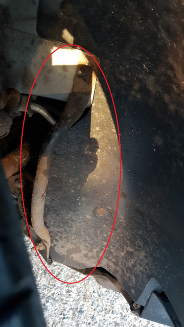

Anyone know what the bar circled is please?

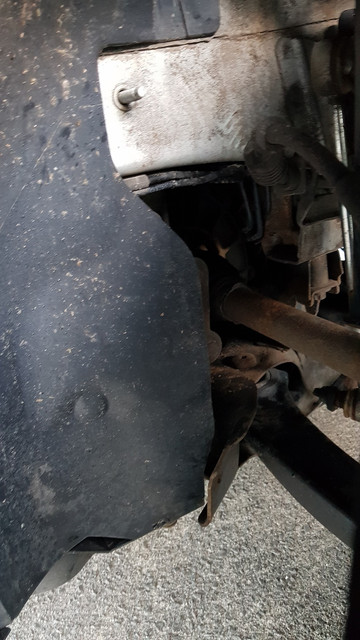

I'm getting a creaking from the front n/s of the car when I turn with full lock on, had a look to see if I could see anything loose or worn, couldn't, but saw that was missing, and I can't for the life of me remember what it is :)

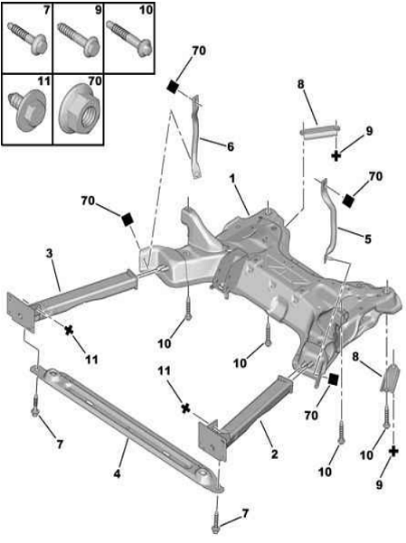

If it's the part I think it is, it's part of the subframe assembly - the strut. There is only one of these fitted to one side though and they are different for RHD and LHD vehicles.
In your case it should be item (6) for right hand drive and this is fitted to the right side, so you shouldn't have item (5) which is for left hand drive vehicles and is fitted on the left side.
350854 is t he part number for the RHD one (6). £28.09 inc. VAT from Peugeot.

Thanks Marc, how strange haha, I genuinely thought it was missing, for it to have the bolt at the top and the hole for the other end, it really looked like it had gone, I had no idea how it could have fell off, certainly without me hearing it, but that explain its :)
Thank you again for your advice.

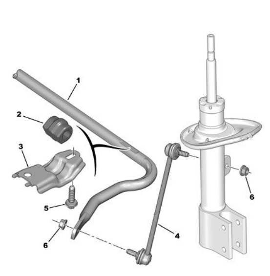

Ok, so item (4) Anti Roll Bar Links:
OEM Originals: 1614281180, £49.90 each
OEM Cheaper Alternative: 1634890780, £8.39 each
Prices direct from Peugeot inc. of VAT as of today.

When I have changed droplinks myself I have found Lemforder to be of a reliable quality. Looking on ebay for Lemforder droplinks for your 3008 is getting prices around £30 for a pair.

It's down to choice and budget really - but the OEM original ones are going to be better quality and were as fitted to the vehicle at new. So see how long the originals have lasted. With a cheaper one I would not expect it to potentially last as long - or be of the same quality - but if this is something you are happy to change yourself then 4 cheaper ones for the price of one OEM one may be better value - though not if you are paying to have them fitted with the labour charges and VAT etc. each time you have to replace them.
