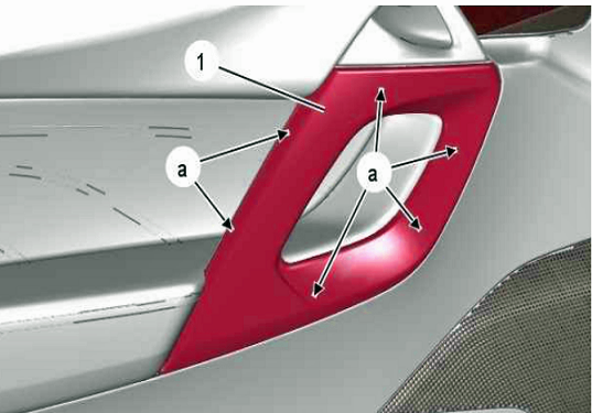

Here you go:
Unclip the trim (1) (as "a") using trim tools.
Remove the trim (1).

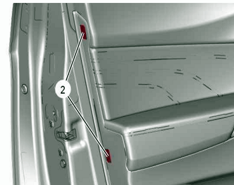

Remove the shields (2)

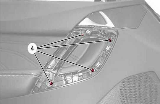

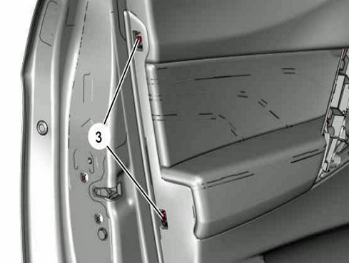

Remove the bolts (3).Remove the bolts (4).

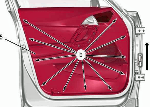

Unclip the door trim pad (5) (as "b").
Detach:
  • The door trim pad (5) (By pulling towards you)
  • The door trim pad (5) (In the direction of the arrow)
You should be able to disconnect the connectors then as you need.
