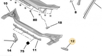

1) Check underneath each door - there are holes for water to drain out that become blocked
2) The scuttle drains where the wipers are can become blocked.
The following items are for water evacuation:
(12) is cowl water evacuation tube
(14) is the water draining gutter
But first of all, check the holes under the front wheel arches - here's a video from a previous post on this - but you'll have to watch it in YouTube as the owner has prevented embedded playing of it.

Marc, I can find one only drain tube passing down to the opening behind the mudguard lining on the right hand side. This opening picks up drainage also from apertures where the windscreen wipers sit. Do you agree in relation to the sole tube?

That's correct, just one - but I would focus on the rear doors first as if it was the front scuttle drain blocked, then I would first expect water into the front cabin floor well and you'd notice that way before it went to the rear. I put the diagram up for the front and the video as these will in all likelihood become blocked at some point.Ceenine wrote: 21 Jan 2021, 03:00 Marc, I can find one only drain tube passing down to the opening behind the mudguard lining on the right hand side. This opening picks up drainage also from apertures where the windscreen wipers sit. Do you agree in relation to the sole tube?
