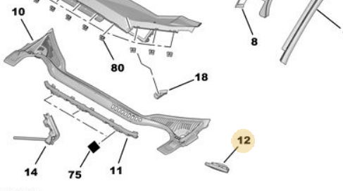

1) Check underneath each door - there are holes for water to drain out that become blocked
2) The scuttle drains where the wipers are can become blocked.
The following items are for water evacuation:
(12) is cowl water evacuation tube
(14) is the water draining gutter
But first of all, check the holes under the front wheel arches - here's a video from a previous post on this - but you'll have to watch it in YouTube as the owner has prevented embedded playing of it.

Marc, I can find one only drain tube passing down to the opening behind the mudguard lining on the right hand side. This opening picks up drainage also from apertures where the windscreen wipers sit. Do you agree in relation to the sole tube?

That's correct, just one - but I would focus on the rear doors first as if it was the front scuttle drain blocked, then I would first expect water into the front cabin floor well and you'd notice that way before it went to the rear. I put the diagram up for the front and the video as these will in all likelihood become blocked at some point.Ceenine wrote: 21 Jan 2021, 03:00 Marc, I can find one only drain tube passing down to the opening behind the mudguard lining on the right hand side. This opening picks up drainage also from apertures where the windscreen wipers sit. Do you agree in relation to the sole tube?
I can no longer purchase documentation on Service Citroen. Most frustrating and a marketing negative by PSA.
Water gets in via the window rubber at the base of the windows and through the window channels - not just via the rain, but more importantly with pressure washing, - which many forget about and these can be your worst enemy. Water is forced into the seals and into the window channels and can over time fill up the door cavities. This leads invariably to the window regulator wire rusting and then 'pop' all of a sudden when you come to use it!
So do check the bottom holes in the door - there may be something internal blocking them from the inside, like some sludge or algae build up. Once the water gets to a certain level, it will leak out of the door card, onto the footwell area and under the carpet where you won't notice it until you're swimming
