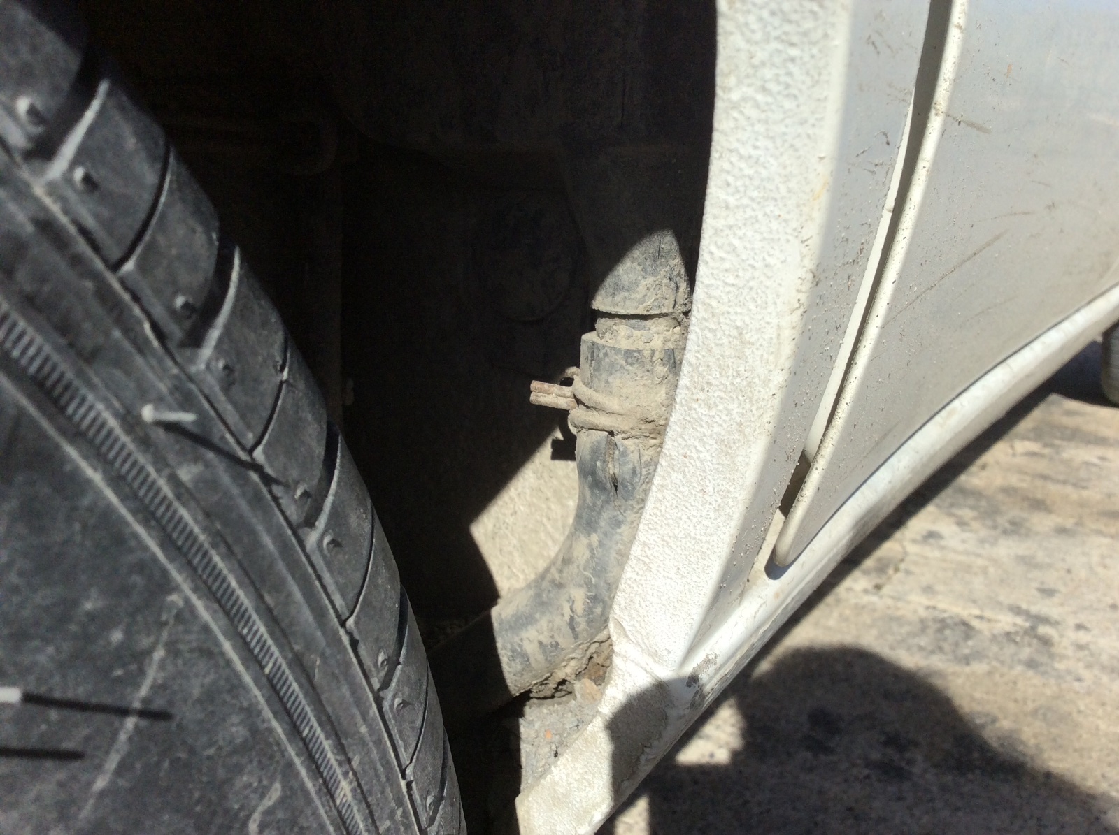

Next problem...wizzing around, chasing ambulances (literally trying/ failing to catch the GP) and needed fuel. Unfortunately the petrol leaked out almost as fast as it was going in. If Citroen made the pipe an inch longer I could just cut the end off and reattach it. Grrrr!

My thoughts entirely! And less messy too... There's nothing more horrible than CV joint greaseJaf wrote: 26 Jan 2021, 13:15 Thanks Jim. I’ve had a look and at those prices it’s not worth messing around with second hand bits.
That's shocking! And potentially dangerous too... Did the pipe split?Jaf wrote: 26 Jan 2021, 13:15 Unfortunately the petrol leaked out almost as fast as it was going in. If Citroen made the pipe an inch longer I could just cut the end off and reattach it. Grrrr!
I'll be keen to see how you go about fixing this..

Well again I’d have expected the MOT fella to have spotted this. The woman putting the petrol in (I love that they still fill your car for you here), stopped and told me. I’ve cut the split end off by a couple of inches and connected it to a bit of rubber pipe with a bit of copper pipe. Took the wheel off for better access...3 wheel bolts!!!
Oddly my Xantia has a split in the same pipe, but being stupid corrugated piping I’ve never managed a decent repair. I replaced the pipe once with a second hand one, but it split in the same place. Glue doesn’t last. Simply putting less fuel in rather than filling her up solved it.

Excellent Jaf
That should prove a good, lasting repair...
Why use four (or five) when three do the job just fine
