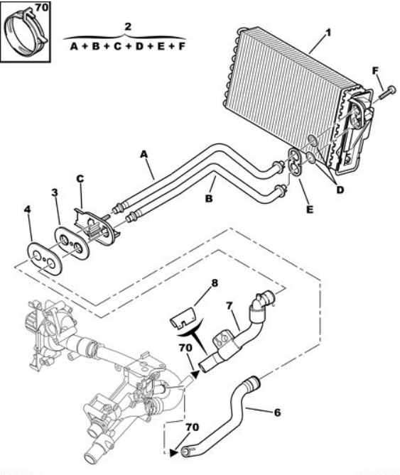

This is the heater Matrix on a C5 1.8 Petrol for example - it's similar to, but much smaller than your engine radiator, item (1):
These can become blocked over the years, resulting in reduced performance.
The pipes Chris is talking about are at 'A' & 'B'.

Yes I know these are the pipes, they are the one I described in the TS. They are both hot, one very much so and the other a tiny bit less.

GiveMeABreak wrote: 13 Jan 2021, 10:23 This is the heater Matrix on a C5 1.8 Petrol for example - it's similar to, but much smaller than your engine radiator, item (1):
